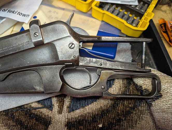

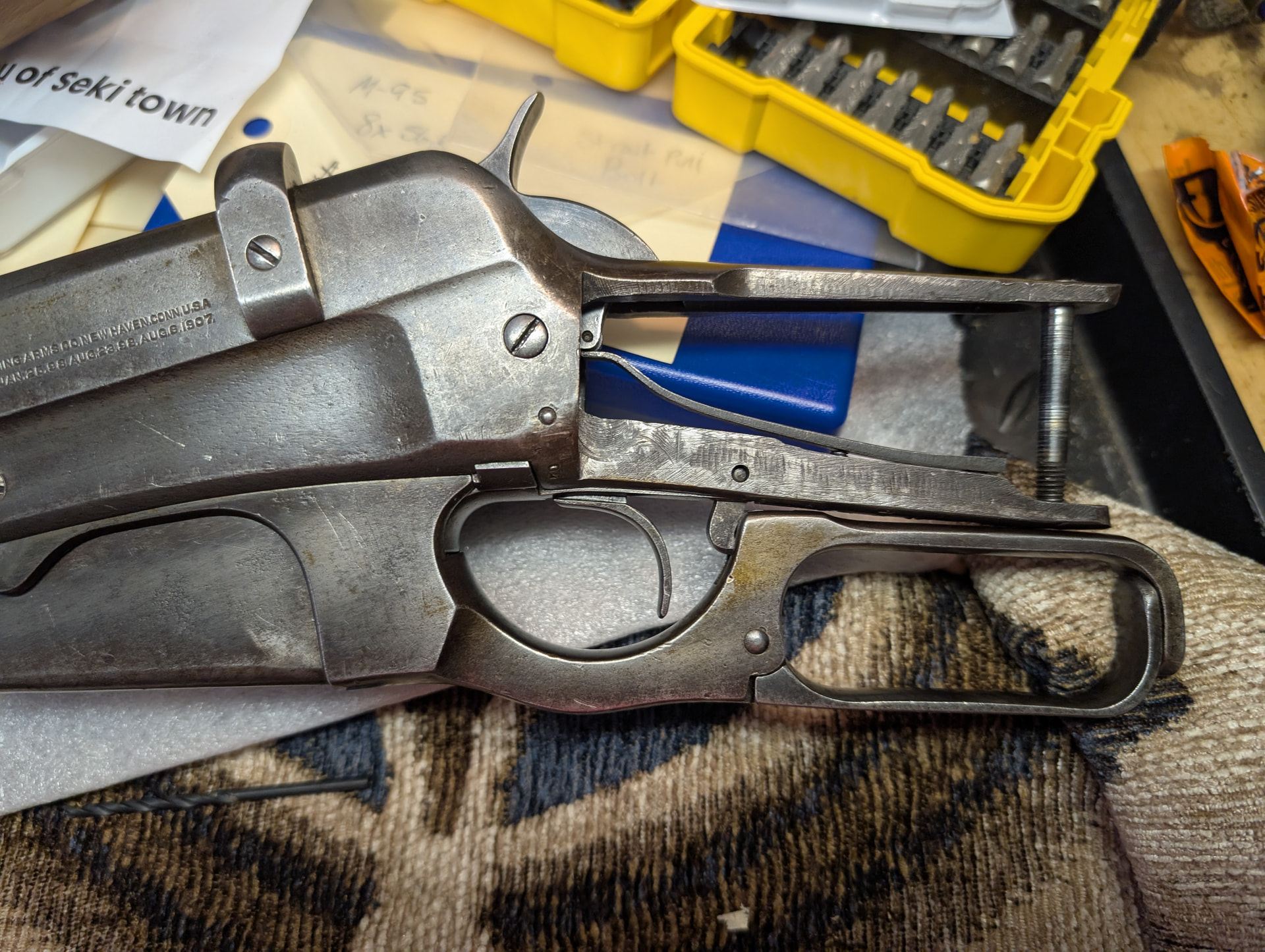

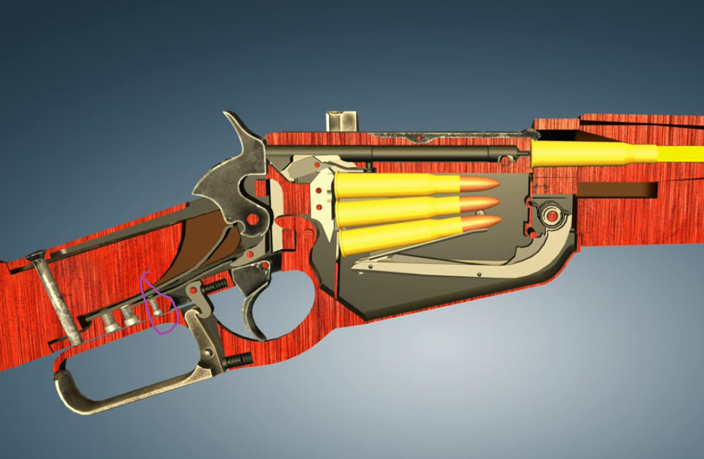

This was the original problem this screw stripped and I had to replace it,

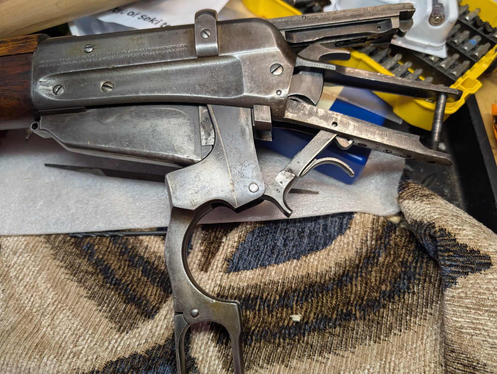

actual gun in question

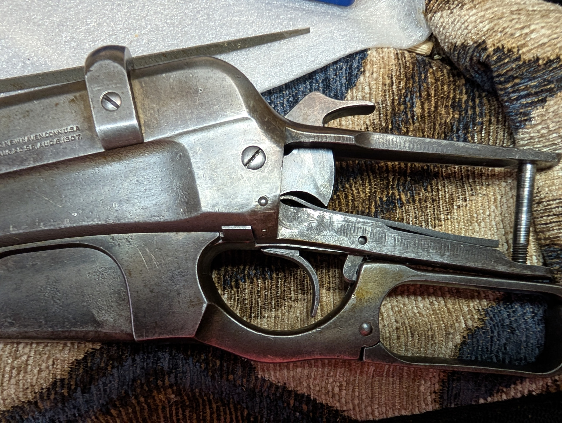

This image shows the hammer release right on top of the trigger when the hammer is cocked. On my gun the trigger is loose and there appears to be distance on the inside of the action between the trigger and the hammer release lever.
here the trigger is loose. Once cocked the only way to release the trigger is push on the hammer release with the action slightly open with a long rod until it turns. Otherwise the action will cycle just fine,
action open
Let me know if other images will help. I have has this taken all the way apart and reassembled a couple of times thinking I had it together wrong but I can’t quite figure it out. I have a broomhandle mauser that was easier to fix than this.

Is the new screw the same length as the old one. Did you reinstall the screws in the proper order? It looks like the spring isn’t putting tension on the parts it’s supposed to. At least enough tension to make it work.
The screw only holds the hammer release spring in place. It has no tension control and the spring itself is fine. I have used a new (old) screw that was exactly the same and a modern one that was a couple thousandths longer the results are the same with either, the screw has to go all the way through the spring or the tension forces it off of it. The old screw was corroded onto the spring but finally it broke.
That’s a thing with these?
usually leaf springs there is a screw putting tension on a flat spring and adjusting the screw in and out determines the amount of spring tension there is. So a shorter screw where a longer one would go could produce less spring tension.
