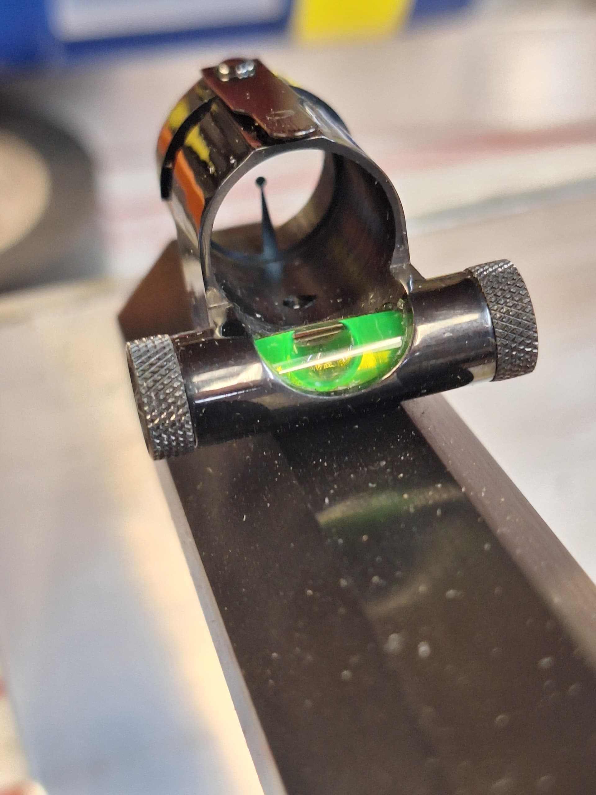

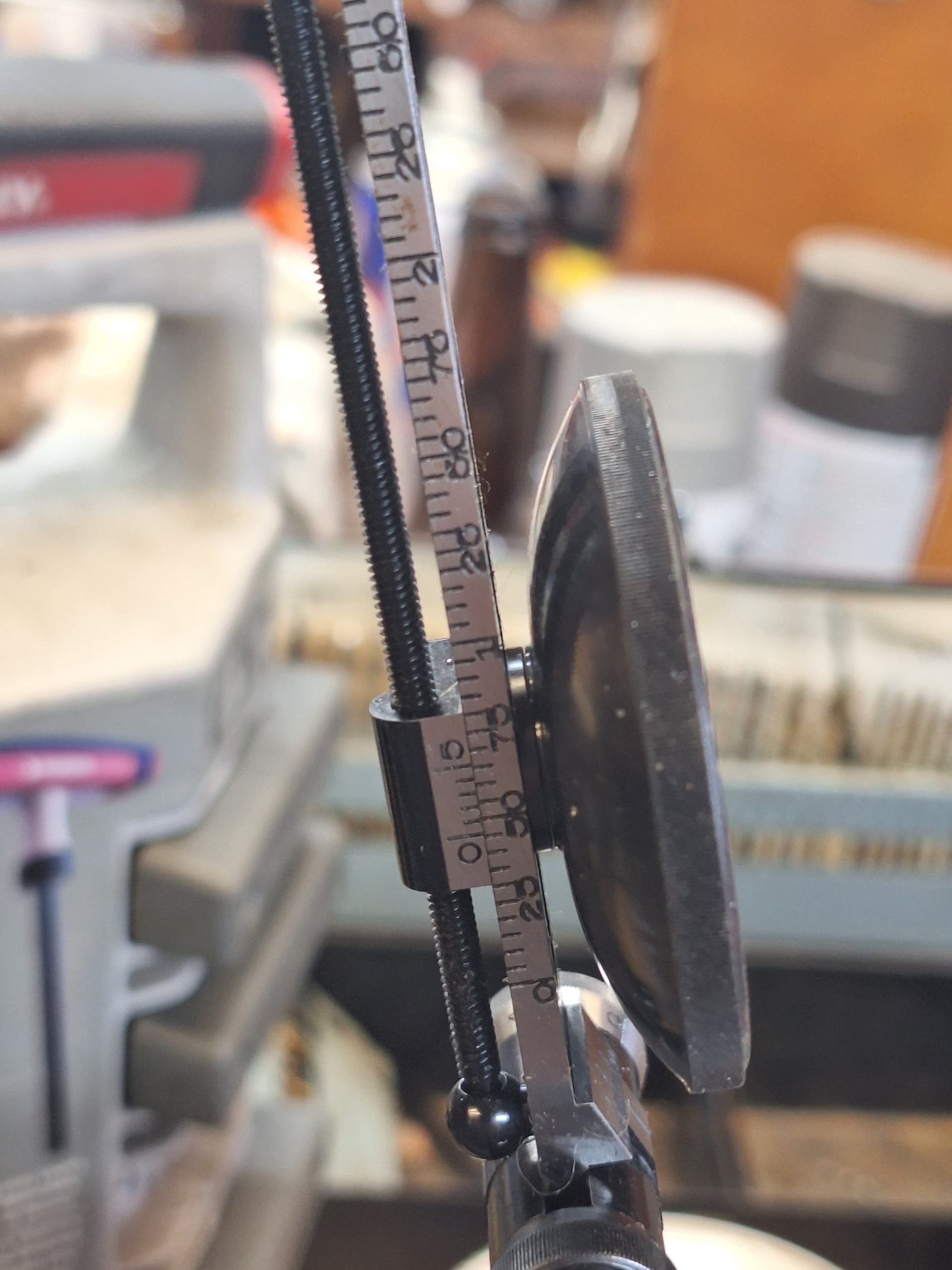

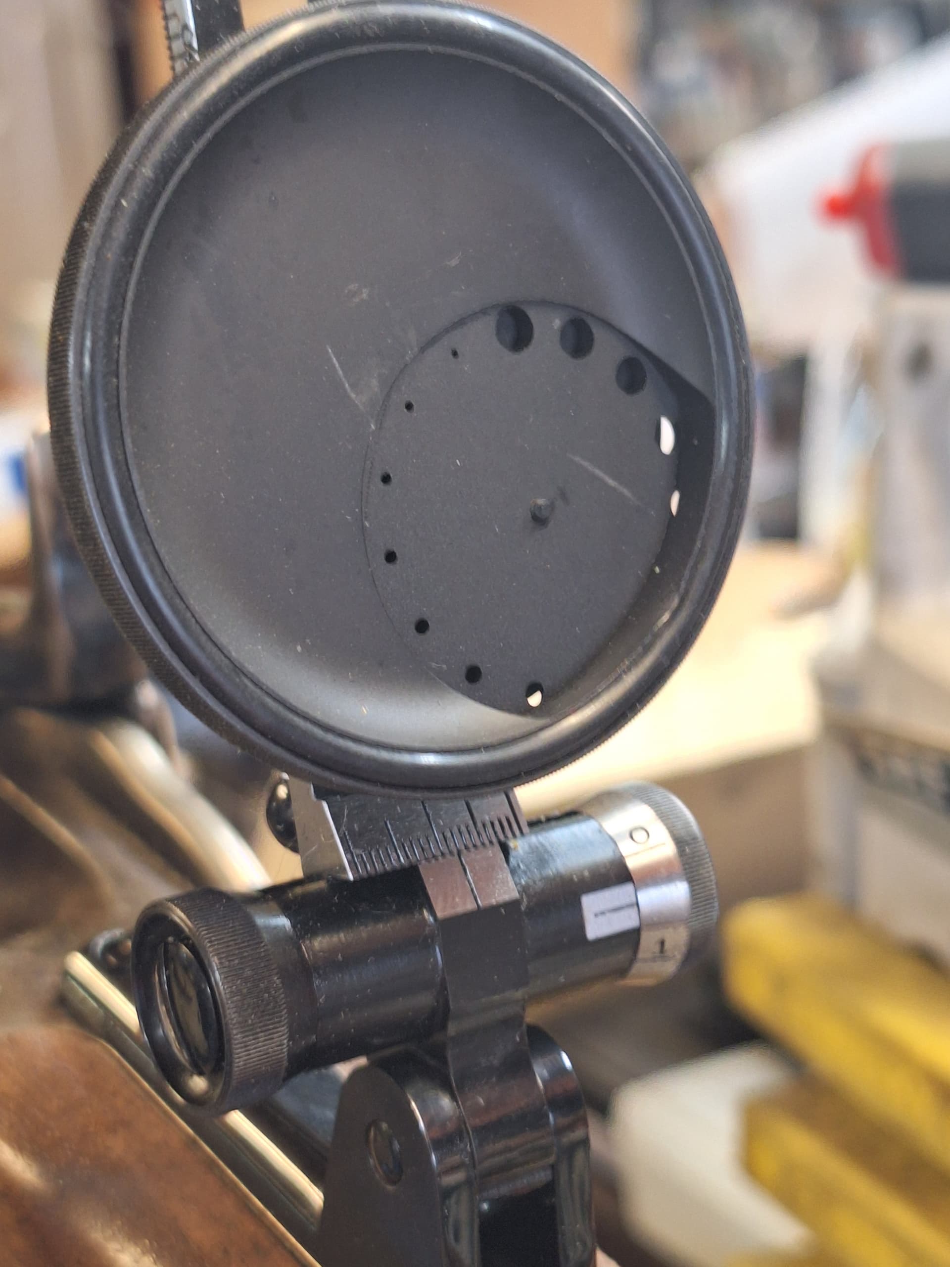

Back to the range with the 45-70. Trying to get a handle on the Soule aperture sights from Montana Vintage Arms I installed a while back. Loaded some easier shooting loads, getting tired of getting beat to hell when I pull the bang switch.
Been really trying to get an understanding of exactly how to use the aperture sights and combine with a ballistic calculator.
So Observation 1: Sight radius 36-1/4”. I’m calling that 1 yard. Vernier rear sight is calibrated at 100 to the inch, 20 lines @ 0.5” to the inch. That makes it pretty easy, 1/100th of an inch @ 1 yard =1” @ 100 yards. 2” @ 200yards.
Observation 2: Vernier scale breaks the 0.05” increments into 0.01”

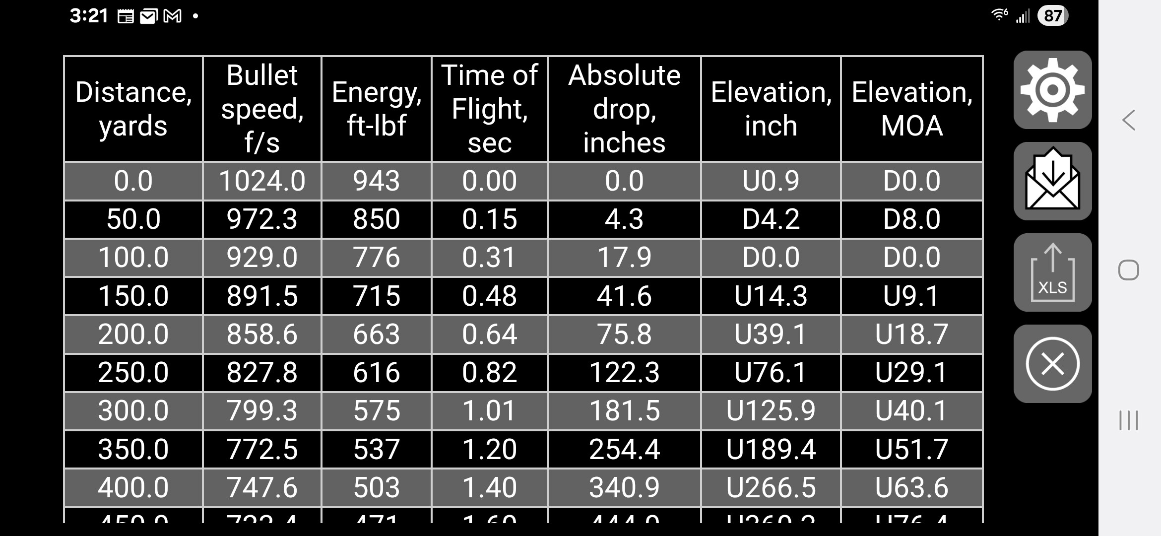

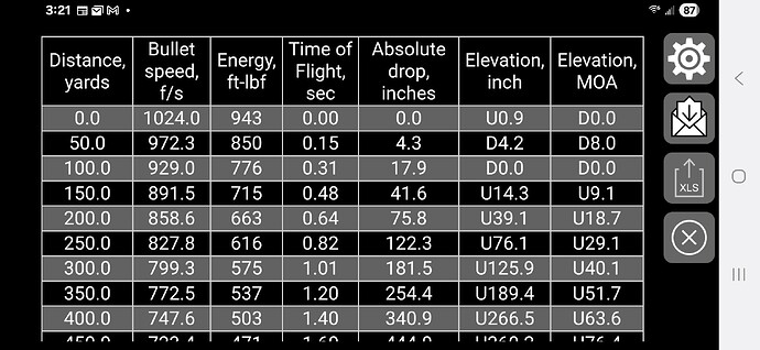

So put that into the ballistic calculator, measured the front sight height and used that for the scope height, found a bullet similar to the Laser Cast for BC, from memory put in 1300fps. target at 200 yards. Calculator showed 13moa drop. Fired a group, hit a good 6” low.

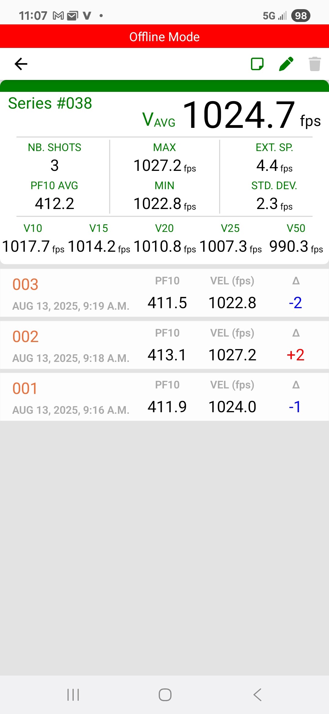

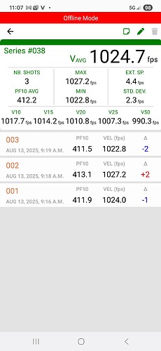

Got out the LabRadar, hell, 1024fps, not 1300. The old, alcohol soaked brain cells can’t be relied on for velocity data anymore. Put that in the calculator 19 moa drop, not 13. Dialed that up, misread the scale, couple inches high. Readjusted, threw in a little windage, 3rd and last group pretty close.
405gr Oregon Trail Laser Cast bullets over 13gr of Trail Boss. I could easily shoot these with no hearing protection. Sounds like a pellet rifle.
