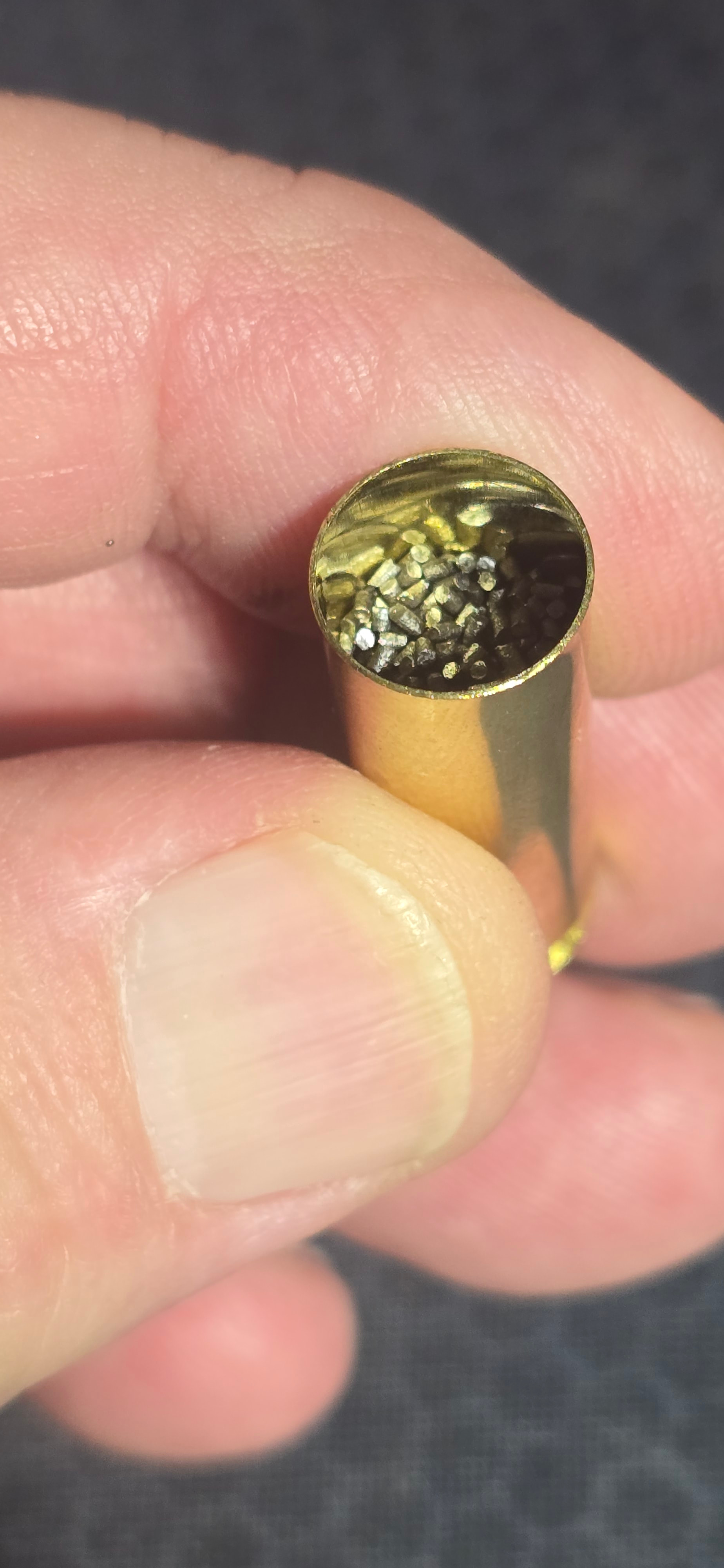

It is a clean burning powder. vihtavuori powder (that I use anways) has always been a clean burn.
The loads I have used so far is as follows:

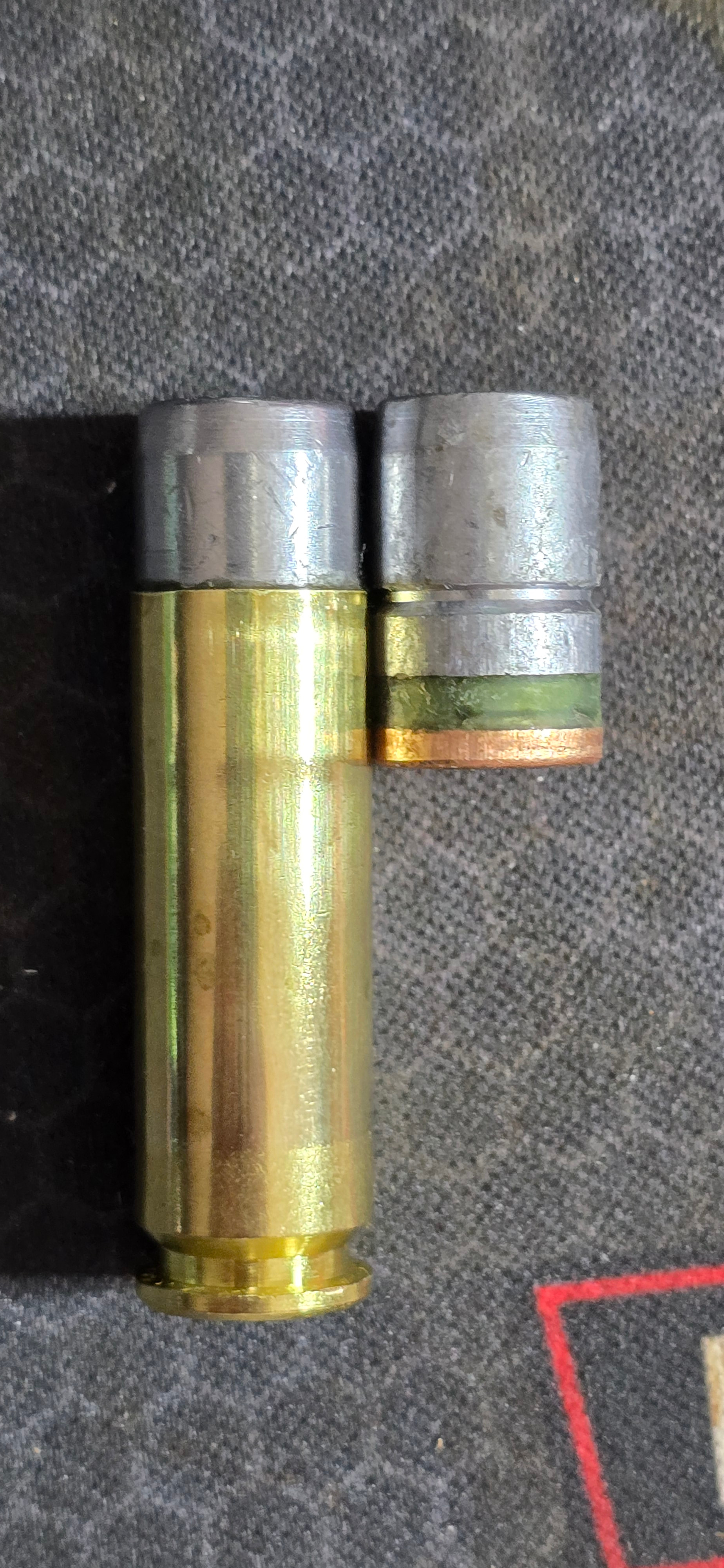

N105; Hardcast bullet/s:
206gr over 18gr: 1620fps
196gr over 17.5gr: 1534fps
206gr over 17.7gr: 1601fps
206 over 17.3gr: 1598fps
With the N105 it is filling case & is slower burning, hence dropping grs has made significant fps drops.
I am using CCI 300 primers (I will try Federal Match Magnums next)
Recoil is a very solid “push”, not a 357 flippy recoil.
