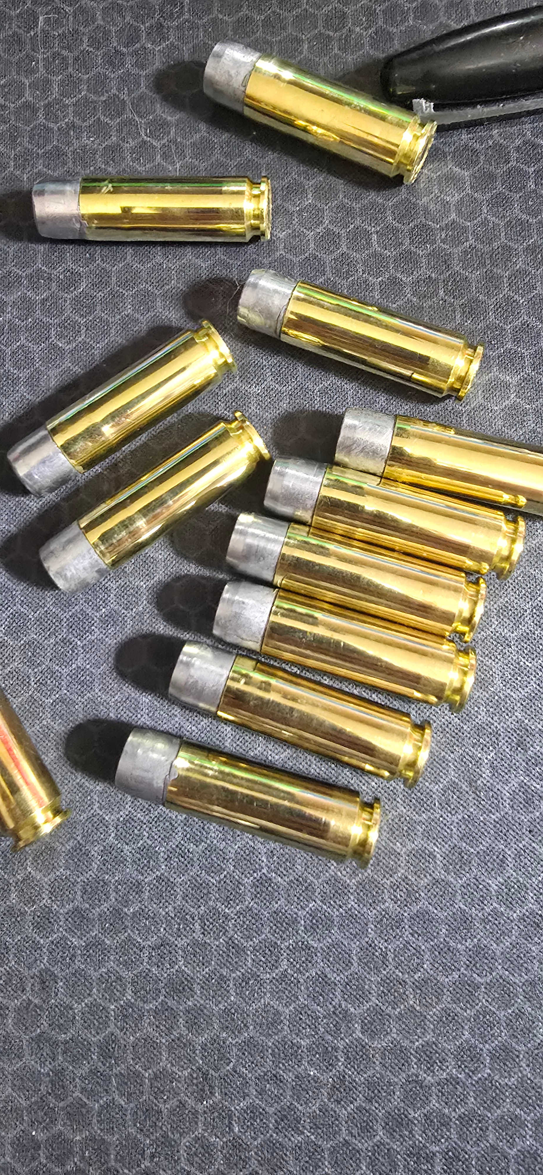

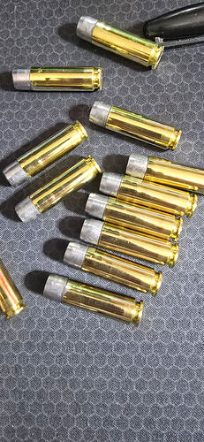

It is putting out 3 in groups now, before the work. I personally (just a me thing) am not quite happy with that. I was in the process of load development (powders/bullets, specifically 196gr & 209gr sized @ .400, .401 & .402).
With the throats being so big, it will not help with accuracy (previous experience with multiple 45 colts). So I am thinking staying with the .403 throats, size bullets @ .403 & lap the barrel out to .401 1st. I am hoping this will bring the groups in tighter.
Well, hopefully things will get buttoned up on the pistola soon, then I can start getting load & data….
Yeah that sounds great , what exactly are ya doing with the revolver ? New cylinder ? .
Wellll..long story, but ultimately having the .40 cylinder reamed to the 10mag. Should (hopefully) be in hand tomorrow. Been a long journey indeed.
I may end up sending it to Reeder Custom eventually for some extra work. Will see how it does for now.
*I should note good friend has sent his to Reeder for 10mag conversion with new cylinders that will have correct throat sizes. Extremely reasonable pricing also.

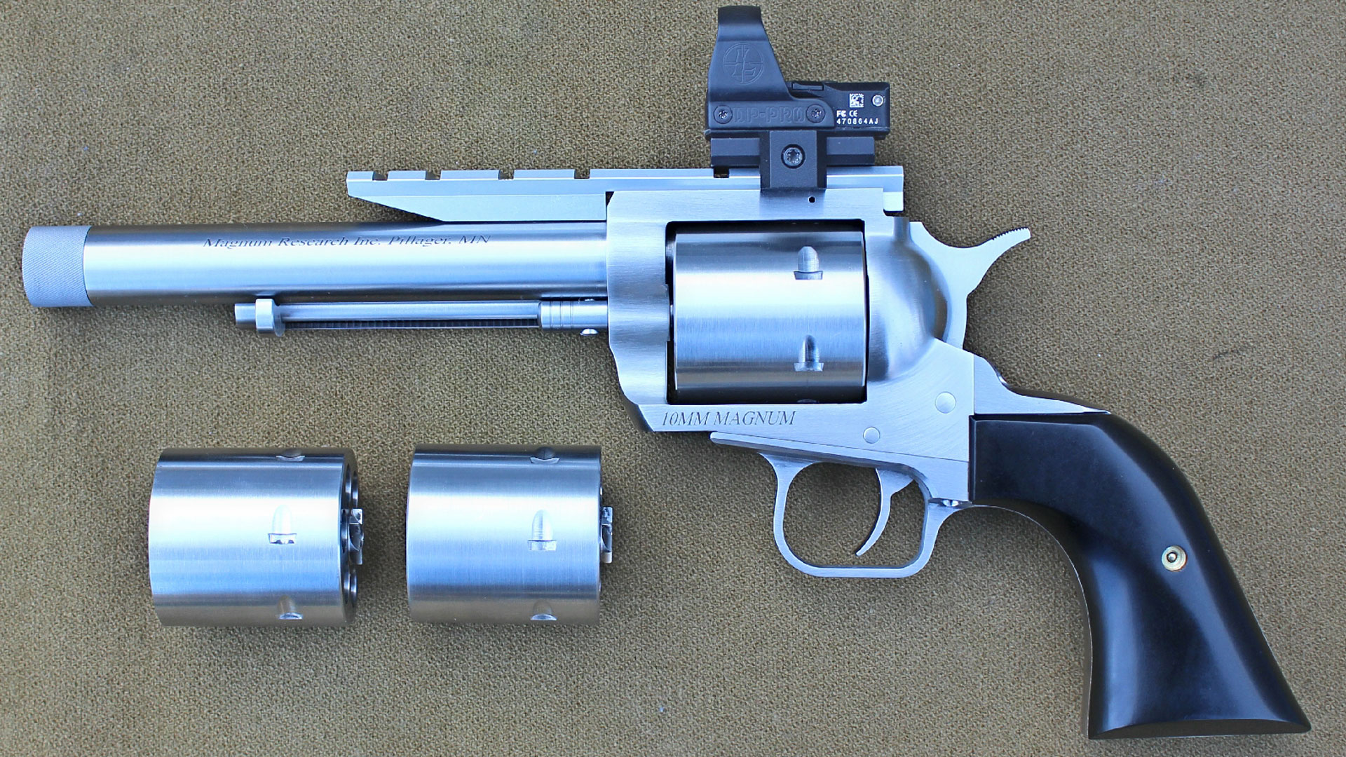

This looks nice.
Oh that is Saaaaweet
Yeah I wasn’t wanting one until AL had to post that :angry:

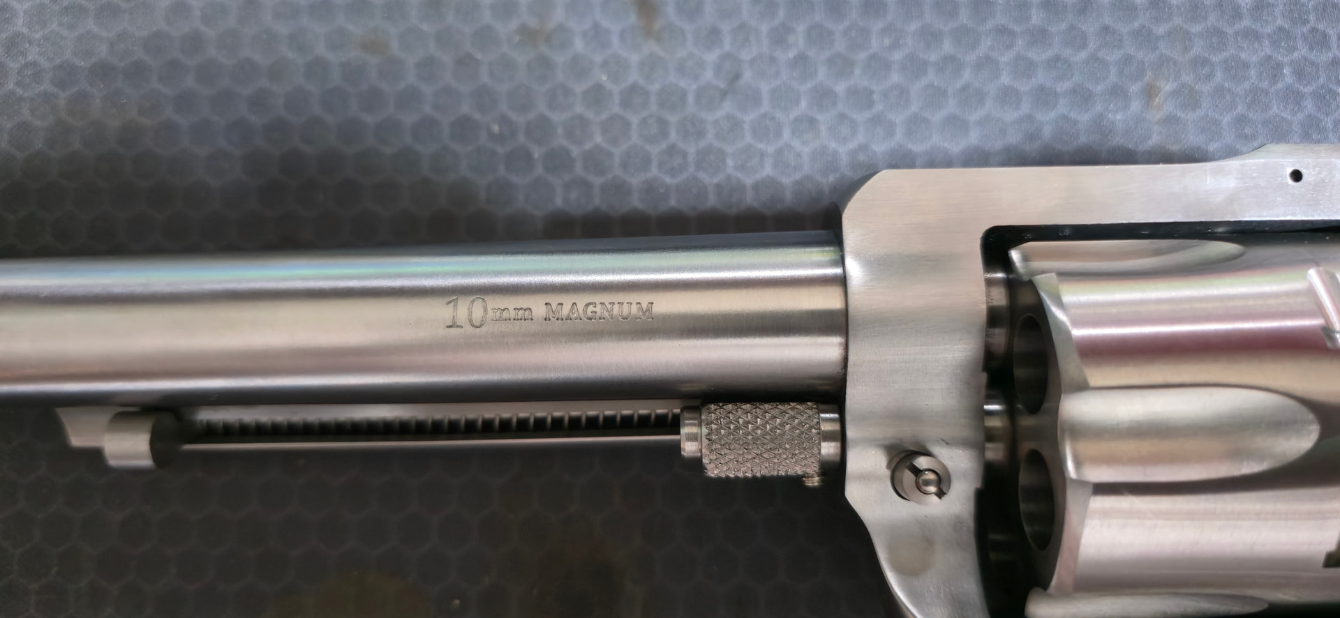

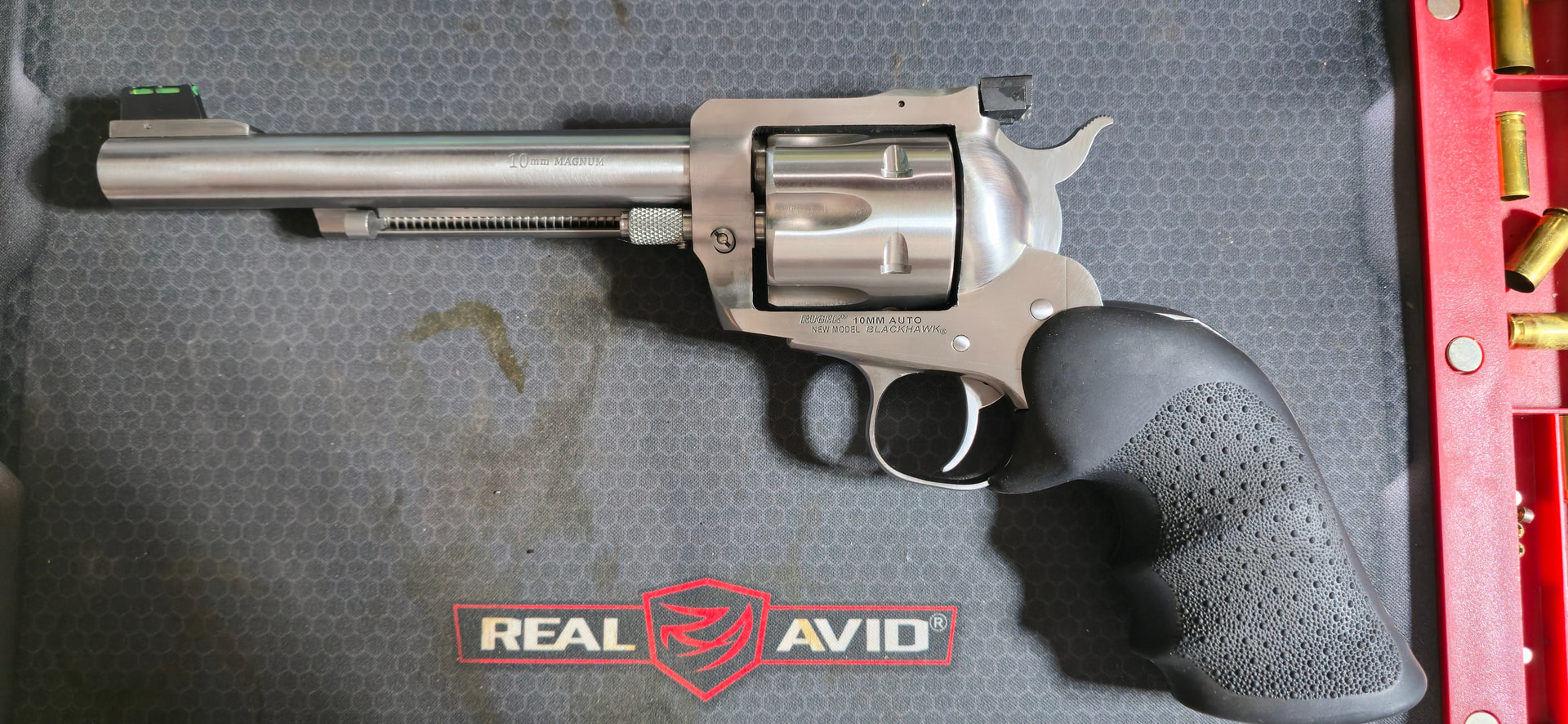

And here it is…
Thats a lot of bad assery there, and will fire 10mm auto too?
I had the 40 cylinder used for the 10 mag, so the 10 auto cylinder is good to go. I can swap cylinders to shoot either one. (I should note friend has his @ Gary Reeder having a new 10mag cylinder being made, EXTREMELY reasonable pricing!). He will be able to shoot all 3, 40/10auto/10mag)
That’s awesome, I had been down the 460 road much for those same reasons, I’d give that one a whirl too no doubt :+1:

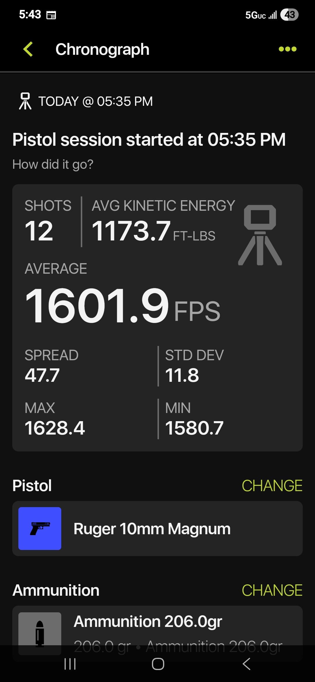

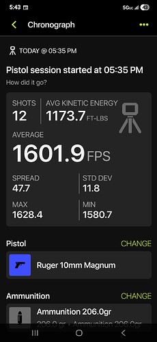

I should note: 206gr Hard cast over 18gr N105. I also tested with 17.7gr N105 with no real change, I believe the no difference is due to powder just isn’t being burned all the way. Will bump down to 17.3 for testing (see if it changes velocities).
