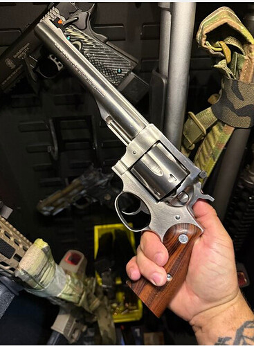

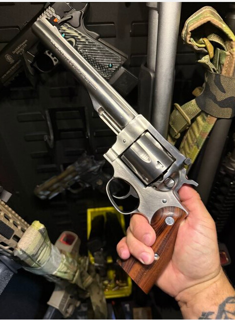

I been lookin at a Ruger redhaxk in 44 mag for a bit. he wants 1100 for ir. it’s used but never shot. after tax it’s gonna be over 1200. i keep leaving it with them.
Given other expenses (gas/food) you might find he drops the price aggressively and your wait is worth it
Probably not, it’s a consignment gun and he has done called the guy a couple times to lower it. Meh! it don’t shoot fast enough anyway. lol
There is a nice one for sale on WAGuns website for 1000. I prefer the Super Redhawk if I’m going with a Ruger DA but this one looks nice. Has my digital fingerprints all over it.
