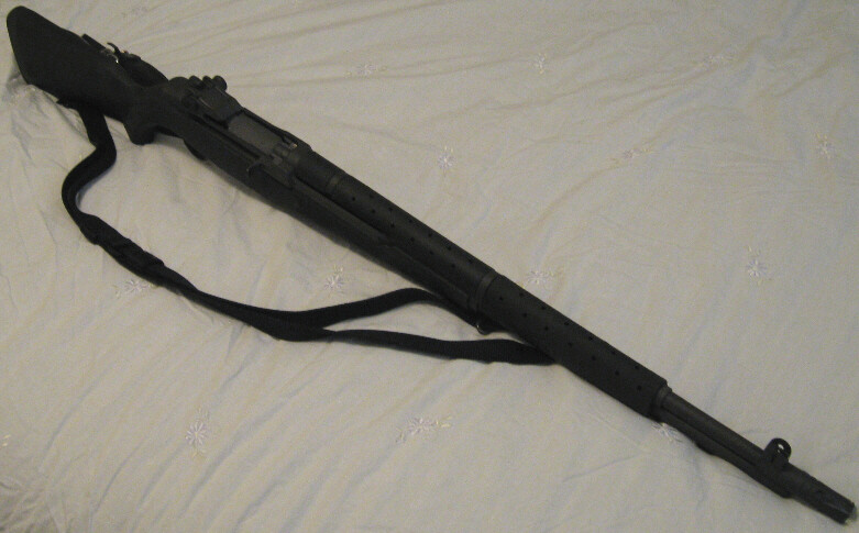

My M14 (Yes it’s a polytech)

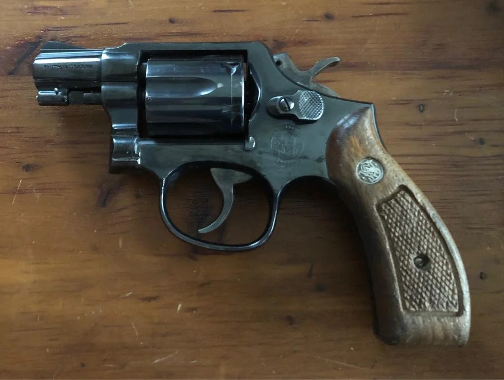

S&W 10-7 snubby, surplus from some overseas police department. It’s one of those J&G had sans barrels, a few years ago.
That’s a neat surplus carry piece. The “sans barrels” J&G origin makes it even more club-gun than catalog queen.
I actually bought two of them. Bought a barrel from Numrich and installed it on this one, and played around with various cheap British surplus cut-down barrels on the other one. Eventually just bought a regular 4" pencil barrel and made it a 4" round butt, which I had always wanted. I love Model 10s in general.
That’s the right way to do it. Building the 4" round butt from parts instead of hunting down a factory example is half the fun of these guns — you end up with exactly what you wanted and a story to go with it.
The British cut-down barrels are a fun rabbit hole. Some of those were rough, but they make great beater guns for the range.
Yeah I enjoyed playing around with those. First one was 2-1/2 inches, then I got a 4" one (cut down from 5 or 6) and cut it to 3 inches. I left it like that for awhile, but eventually decided that I didn’t really like it any more than 4".
I don’t think I ever gave more than $15 for a British barrel. One really cool thing I discovered is that Model 10 parts are incredibly interchangeable. Pinned barrel, post-pinned, pre-10, even WWII era British lend-lease can usually be swapped.
Another thing I learned is that the British barrels are still the standard .357" groove diameter. I had always thought they were .362" or something since they were .38 S&W instead of Special.
The British barrel groove diameter thing trips up a lot of people. Those .38 S&W guns were bored to .
357" to simplify production, so the only real difference is case length and rim — which is why the cut-down barrels work so cleanly on a .38 Special cylinder. That part interchangeability across pinned, post-pinned, and lend-lease guns is the real gift of the Model 10.
It’s why they’re still the cheapest way to build a shooter that’ll outlast you.
