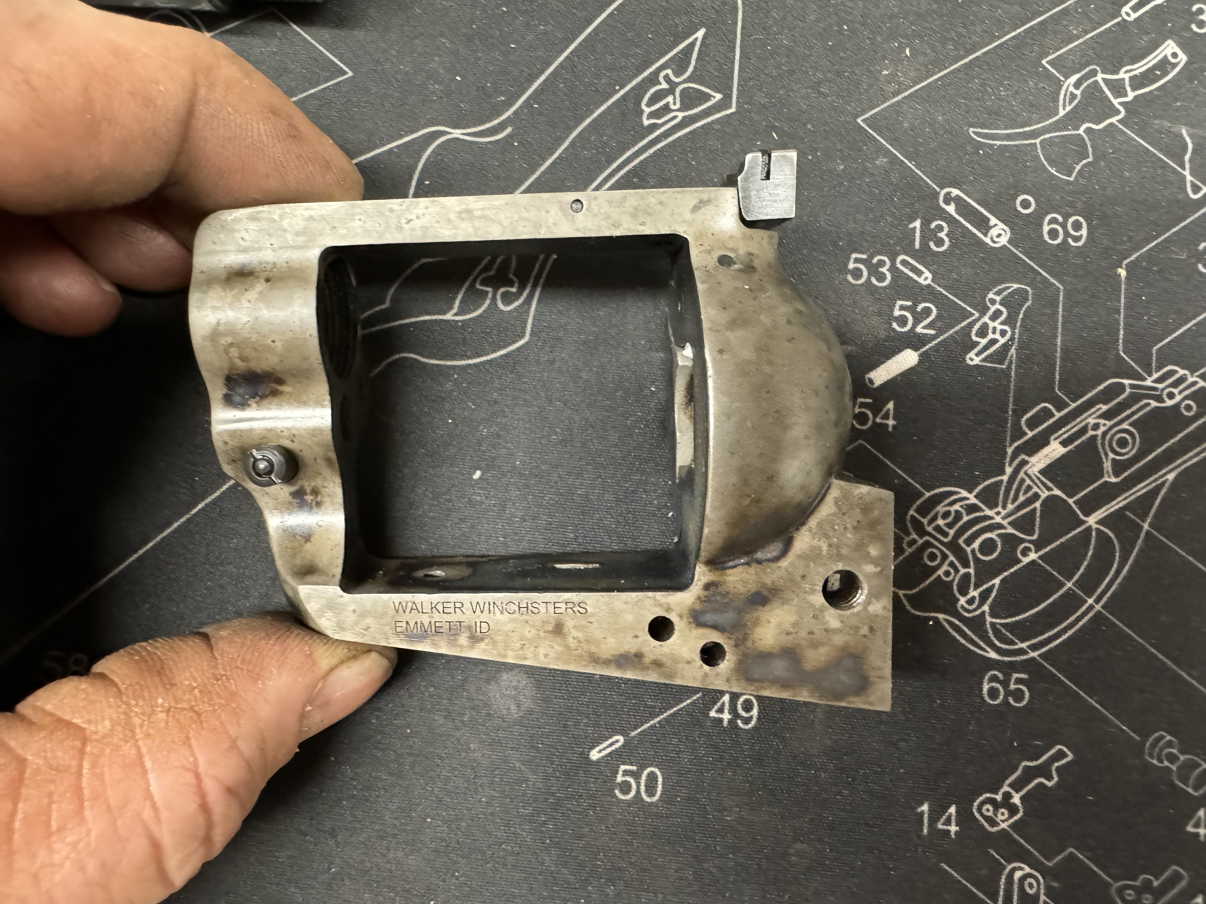

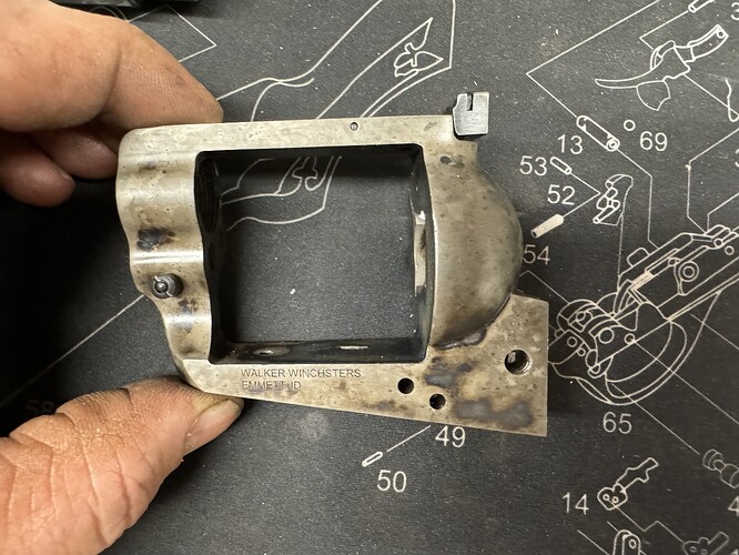

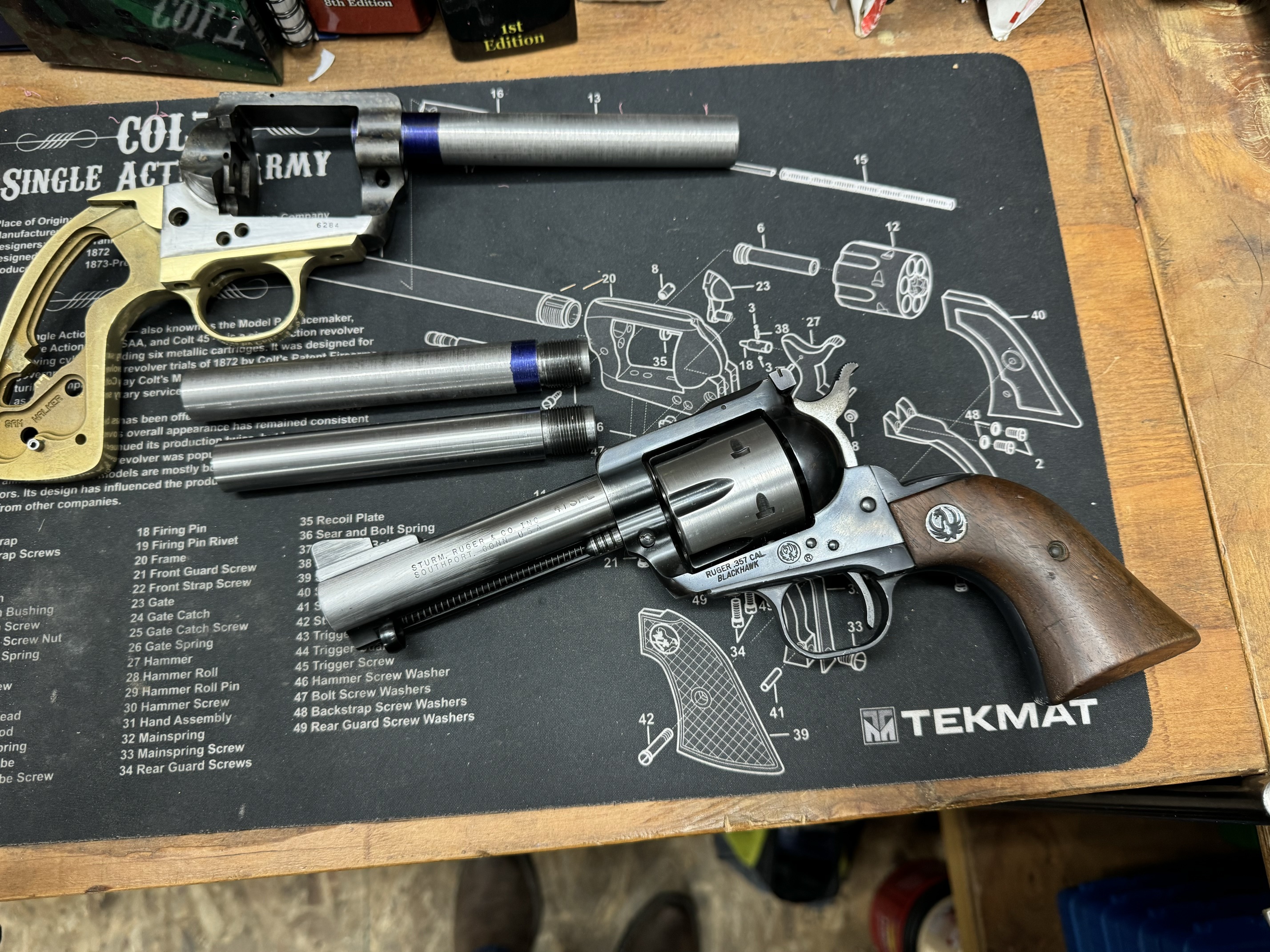

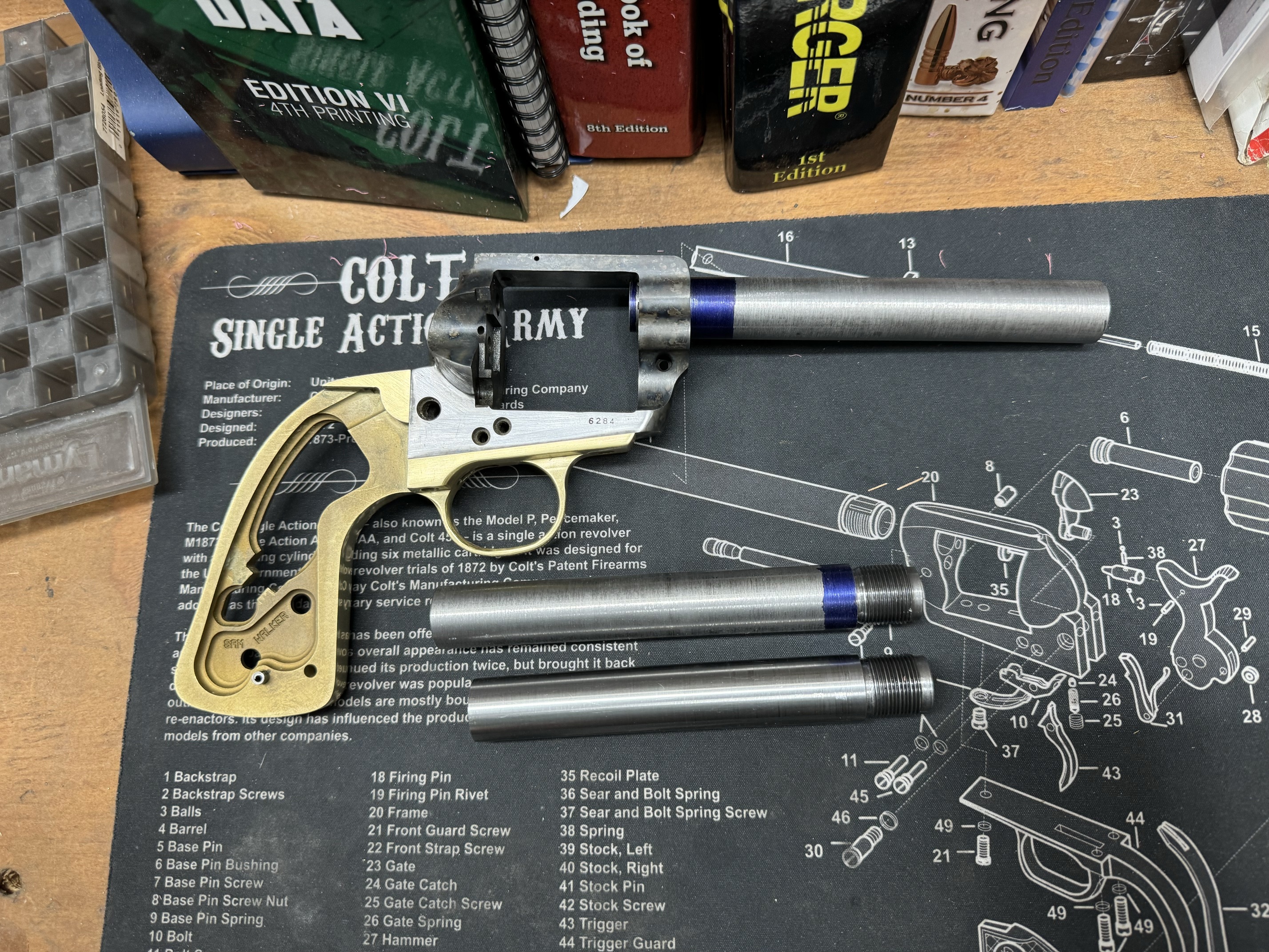

So this is the custom flattop from 1956 4 digit serial number i converted to 41 Special. The only things original to the revolver is the frame, loading gate, and cylinder.

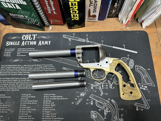

Thats a great looking piece , why 3 barrels ?

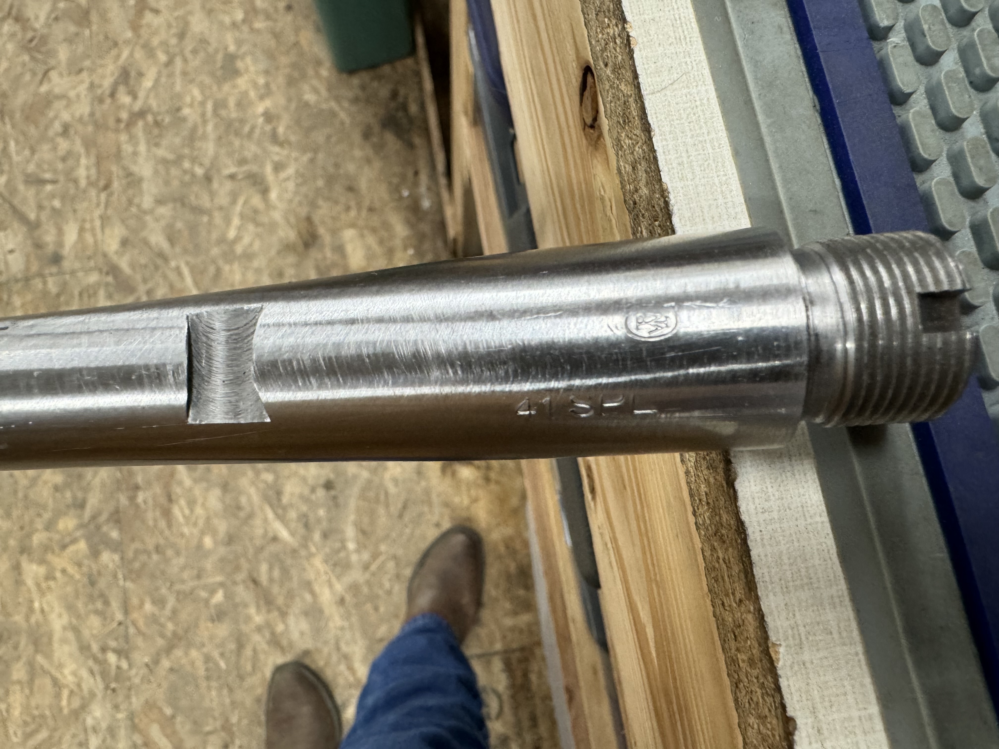

They are cut from a blank. I made a 14” 1892 trapper barrel and 3 ruger barrels for custom revolvers.
Just cutting them while i have it set up in the lathe.
Oh okay I see said the blind man to his deaf daughter ![]()

That brass grip frame ?? Tell me about that . And I see 2 Revolvers I take it both was rebarreled ?

Sorry been in the mountains all day. So to answer your questions. the brass grip frame is from RW Grip Frames in Texas. That is the potato judge. So made for someone with big hands. Helps control recoil like you would not believe. The weight of the brass helps put put the center of gravity just behind the hammer taking into account the 5-1/2” bull barrel 3/4” diameter.
The top one needs a colt bushing installed in the cylinder then an oversized base pin. Finish the barrels.
The lower revolver was converted to 41 special but a guy saw mine and wanted a duplicate. That is an entry level 41 Special. It is a old model ruger blackhawk that i rechamber the cylinder then use a 41 mag barrel. Nothing else is really done to it. That is the entry model. Then there is the full custom model the only parts original are the frame, loading gate, and cylinder.

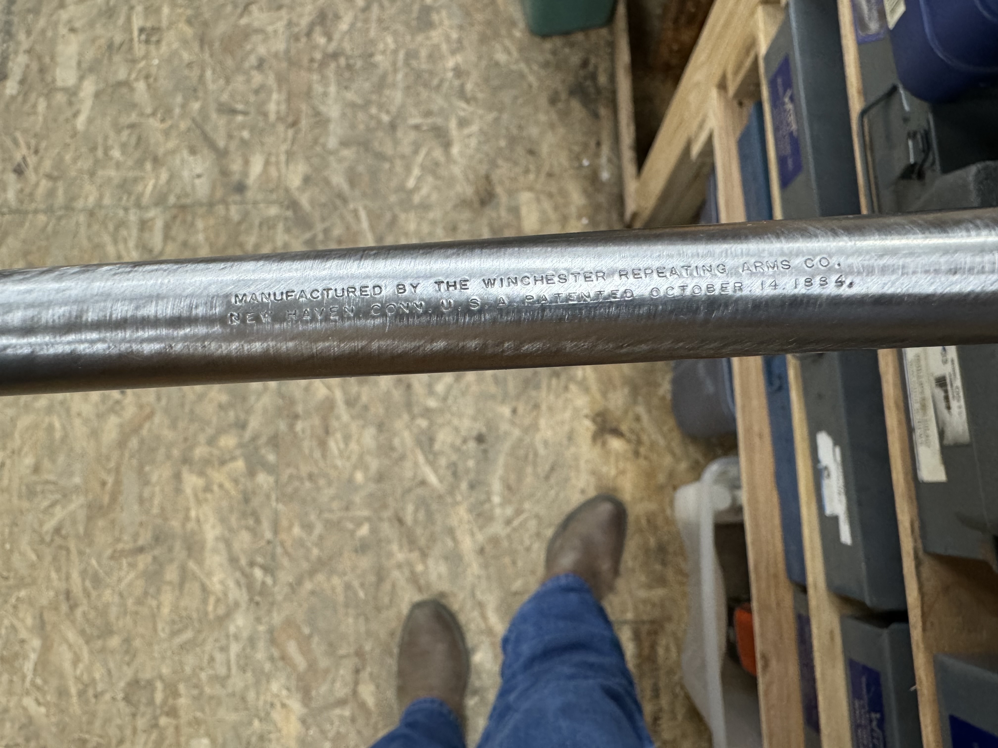

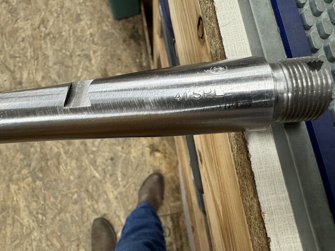

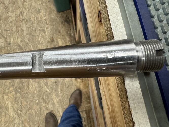

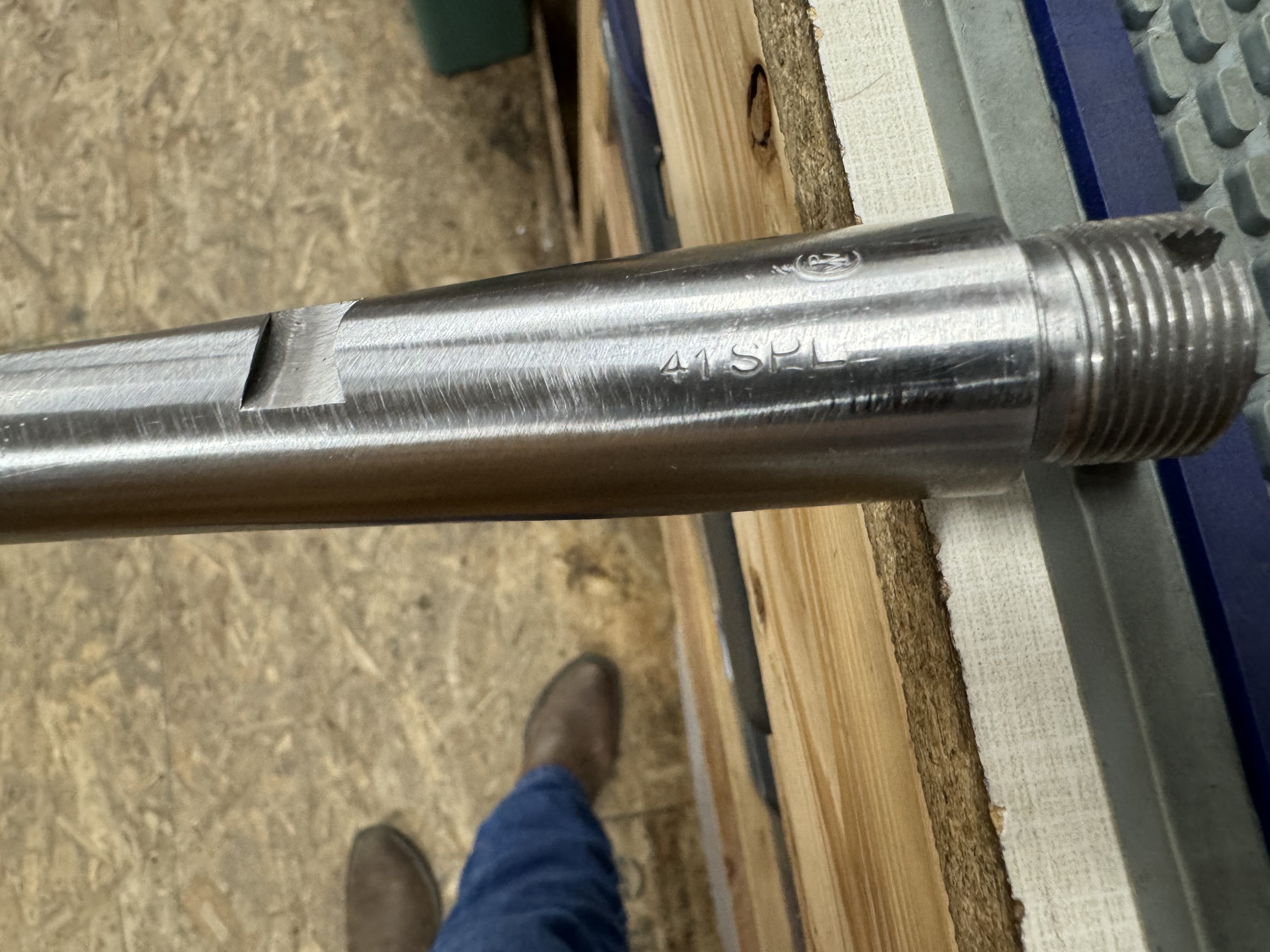

You asked earlier why 3 barrels. Yes i made 3 revolver barrels well here is my 1892 winchester 14” trapper barrel in 41 Special. In the next couple weeks i will begin that carbine to trapper conversion from 44 WCF TO 41 SPECIAL. Yes when i make barrels i have all the roll stamps, caliber stamps and winchester proof stamps.
