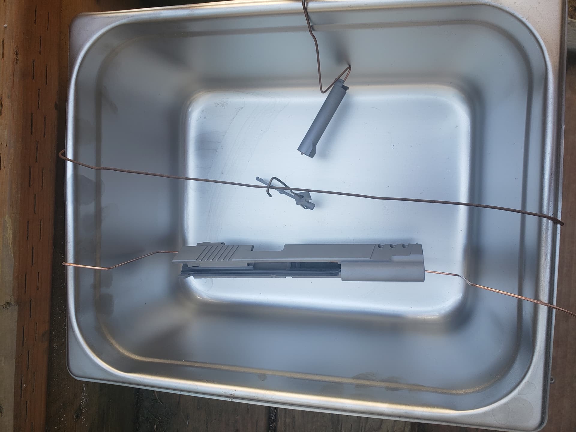

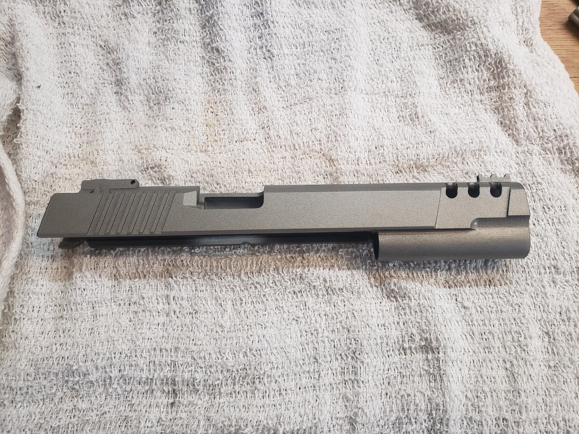

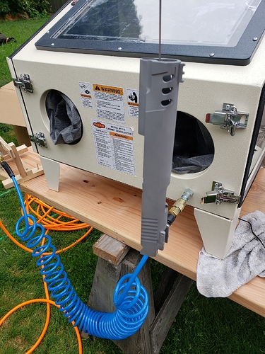

Media blast with 120 aluminum oxide after degreasing, then into a mix of manganese phosphate and hot water basically. bubbles for a while about 10-15 min then wash off with lots of water. At that point you can soak in any light oil or post parkerizing solution, or on to Cerakote.

So its chemical etching in a way

Its more like a type of rust then etching.
The tooth from the AlOx media blasting gives it a lot of suface area to hold oil or cerakote.

Super dry air. (Same for media blaster) I run a cheap oil/water, a nice coalesing filter, after that a dessicant filter.

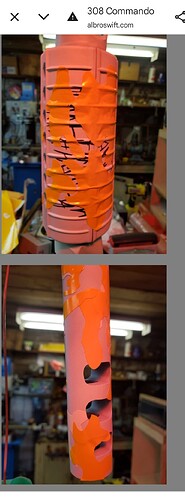

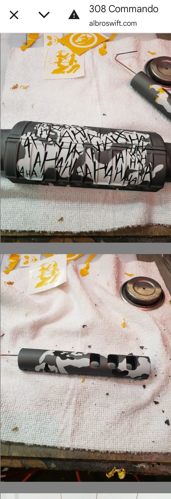

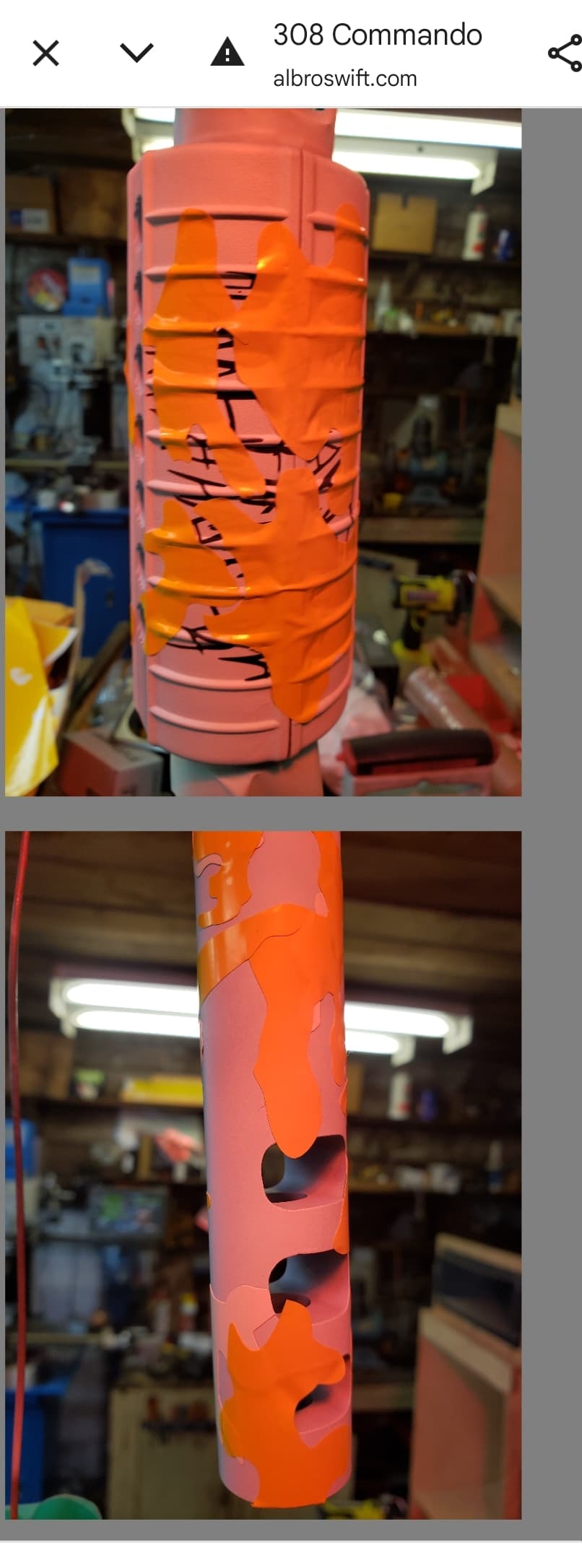

If you want masking/stencils flash each coat for 15-20 minutes at around 180F and it is hard enough to apply/peal high temp masking but will still accept more coats. After full cure can’t apply anymore.
