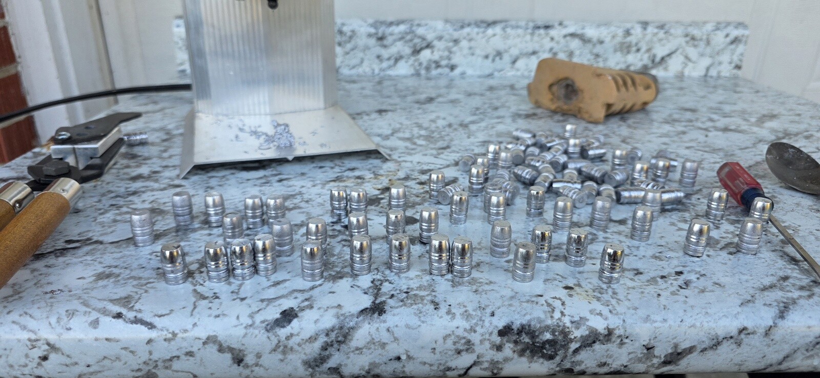

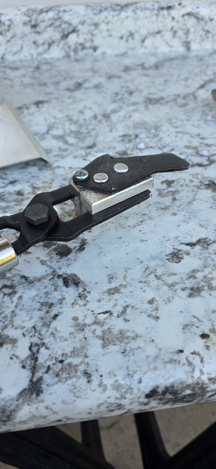

I ran into a small problem today. My sprew plate got loose and messed up several before I figured out what was going on.
Then my bolt for my handle got loose and messed some of my bullets …lol I have cast hundreds with that set and guess it just needed some adjustment .
After figuring that out It seemed to get the hang of it.

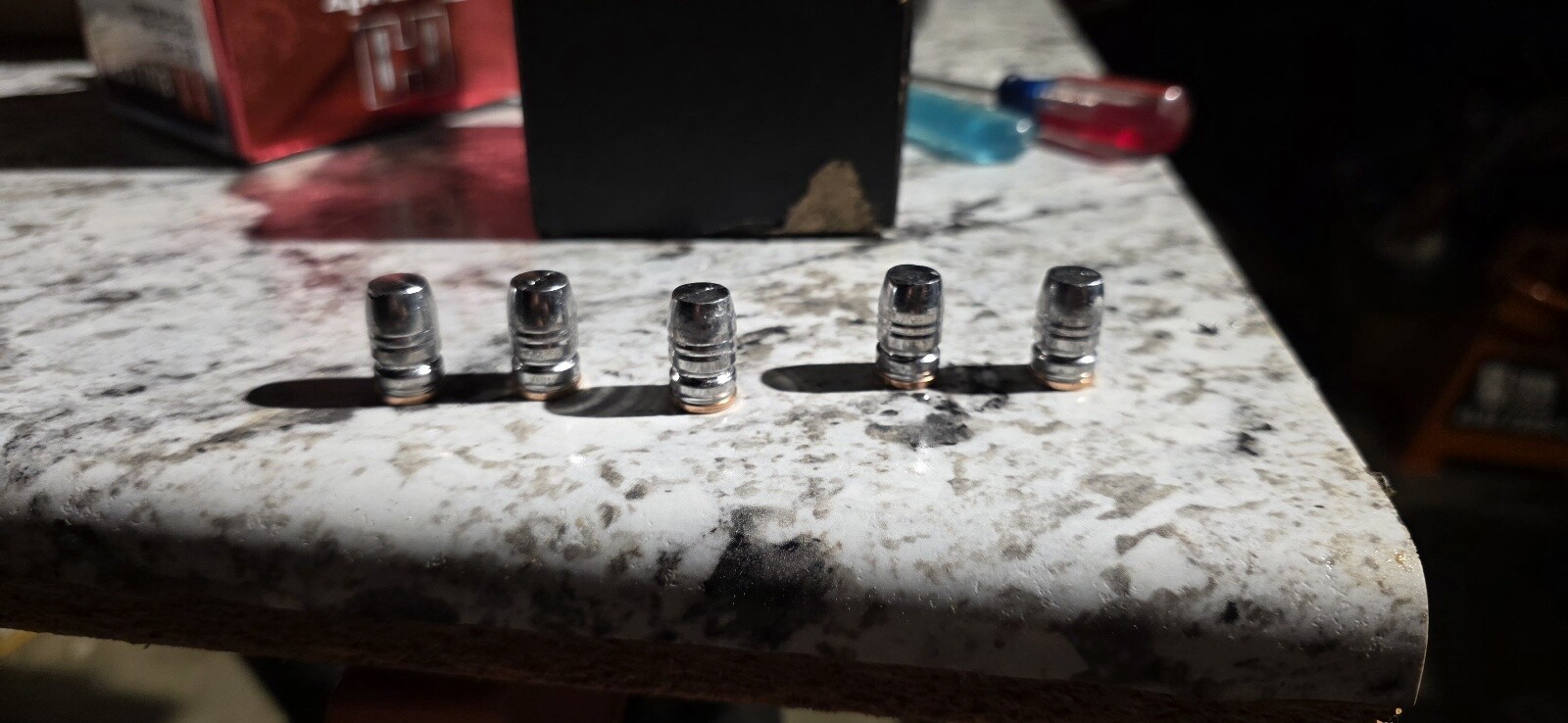

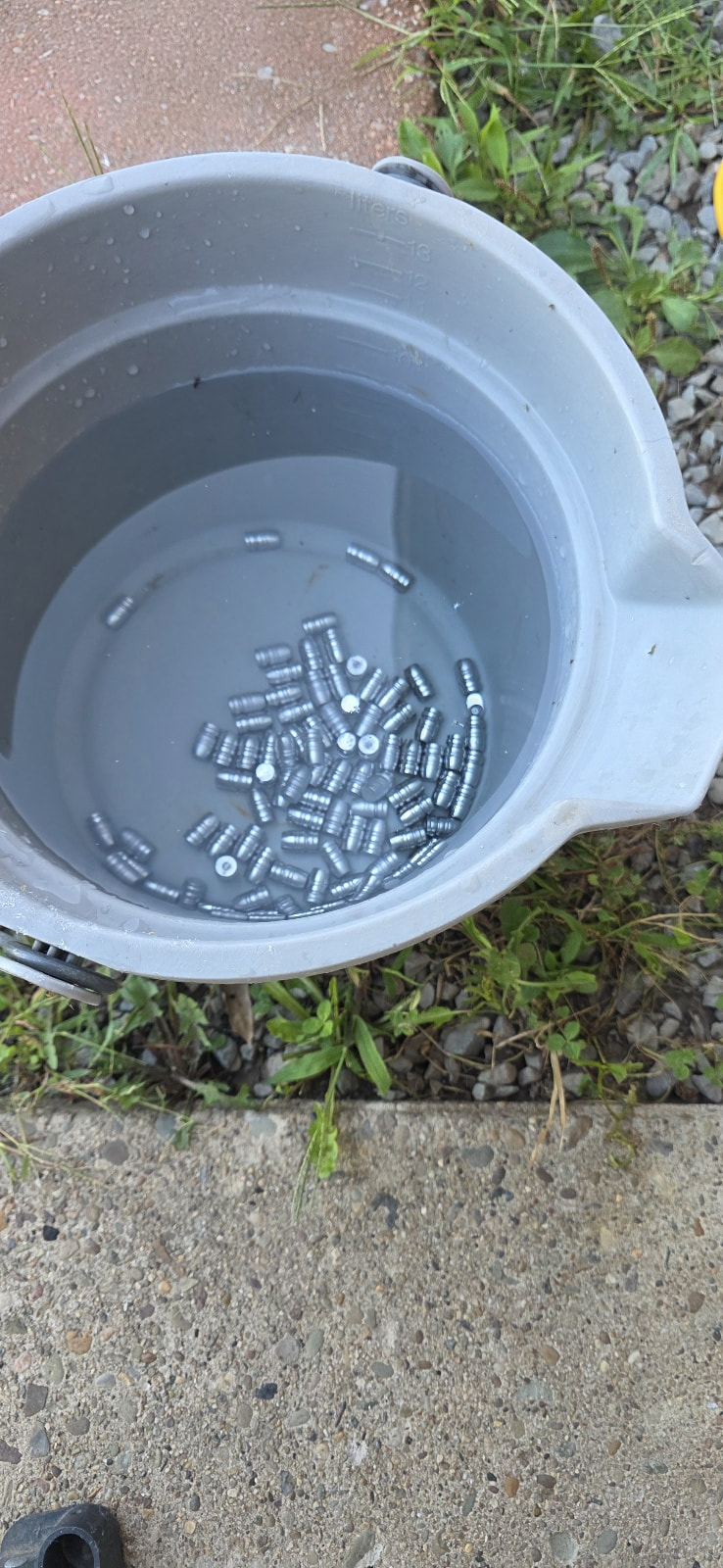

Had about 10 failures then remelted added all my sprews poured about 20 more bullets and ended up with a few I just didnt like . But all in all over 100 good bullets.
Then I sized them with my Lee sizer and of course added the gas checks while sizing.

I always size as I am adding the gascheck . They are all ready load except the alox . Which I just did and they are drying now
