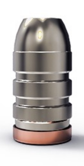

When you are done playing around, this is what we use. Even says “best” right in the data.
They are good looking moldes
I use Lee molde also for my stuff love em. Easy to use
