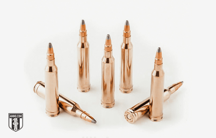

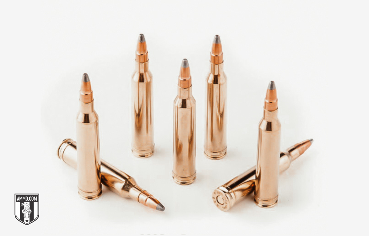

7mm Rem Mag Recoil: How Does It Compare to Other Magnum Rifle Cartridges?
The 7mm Remington Magnum excels at long-range hunting thanks to its bullets’ high ballistic coefficients. But do its long-distance capabilities mean increased recoil?
Let’s discuss everything you need to know about 7mm Rem Mag recoil: how hard it kicks, how it compares to other magnum cartridges, and how to reduce it if needed.
How Much Recoil Does 7mm Rem Mag Have?
The 7mm Rem Mag generates 22 ft-lbs of free recoil energy on average. Recoil typically ranges from 16.7 to 24.8 ft-lbs when fired from an 8-pound rifle, which means it is definitely a shoulder thumper.
Most shooters would find 7mm Rem Mag recoil unmanageable. Anything stronger than 15 ft-lbs is generally considered challenging for the average shooter to control. However, the 7mm Rem Mag’s recoil is on par with many of the magnum cartridges commonly used for long-range shooting and hunting.
