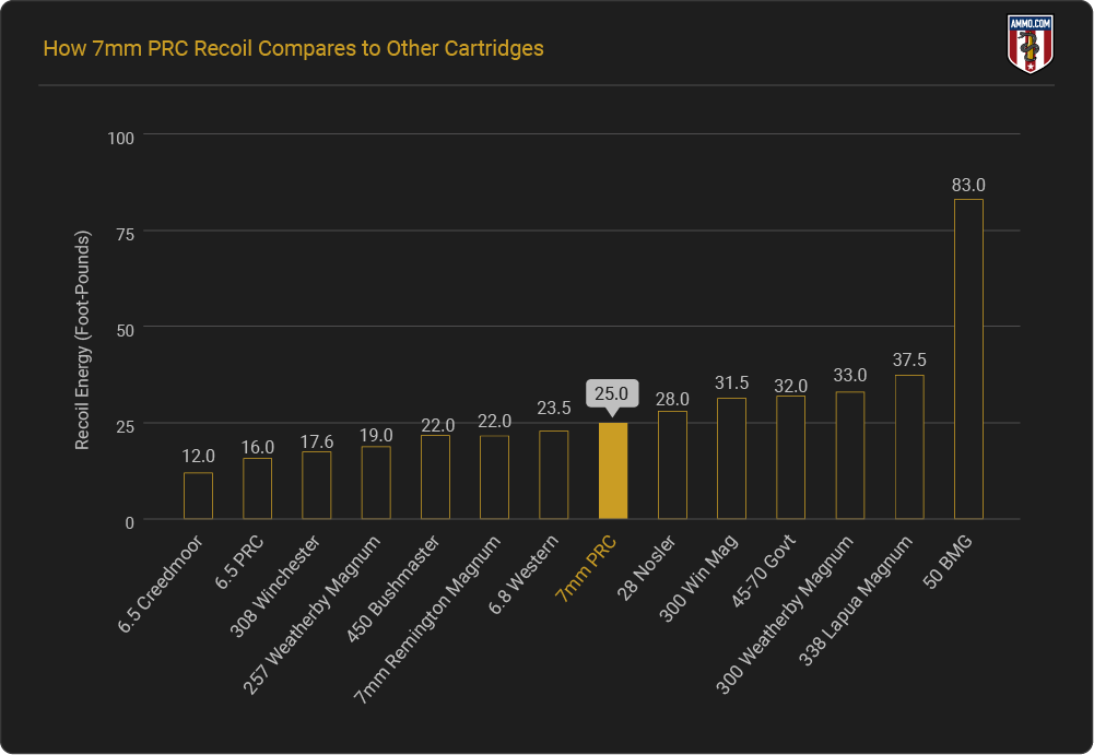

The 7mm PRC’s recoil is middle-of-the-road compared to many other long-range magnum rifle cartridges. Refer to the chart below to compare it to several different standard and magnum rifle cartridges commonly used for hunting and long-distance shooting. This table assumes 8-pound rifles across the board to produce as equal a comparison as possible, which is why figures differ from those listed above.
