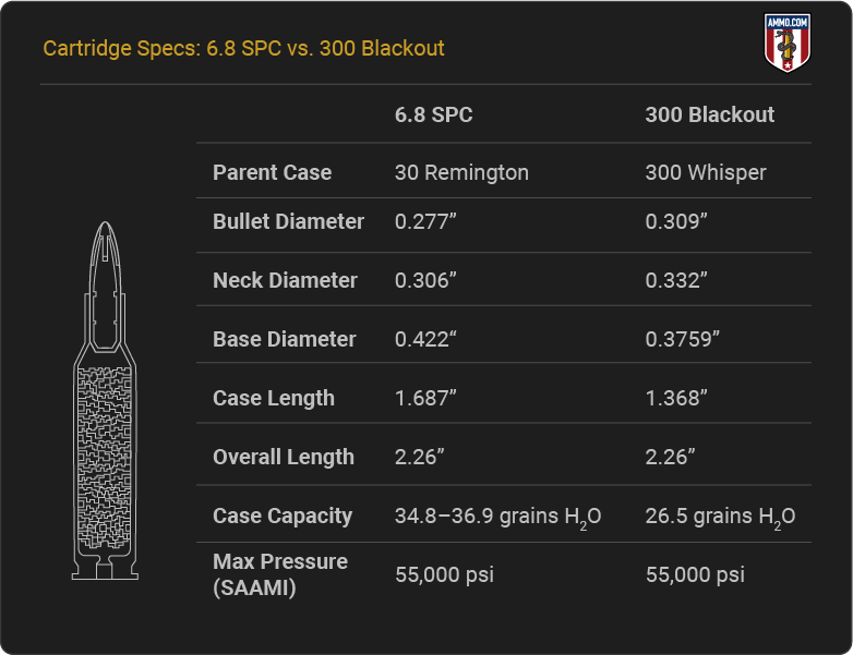

Cartridge Specs
When evaluating two cartridges, it’s good to begin by analyzing their physical specifications.
The most striking difference between these two cartridges are the calibers of the bullets either fires. The 300 AAC Blackout launches America’s iconic .30 caliber bullet –0.309" diameter, which is almost identical to the 308 Win – whereas the 6.8 SPC fires a 0.277" diameter bullet just like the 270 Winchester.
A 300 Blackout AR-15 uses the same bolt as one chambered for 5.56 NATO, while the 6.8 SPC requires a new bolt for caliber conversion. Both rounds require a barrel change, but in terms of ease of conversion, the 300 Blackout requires fewer specialized parts.
