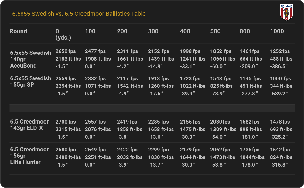

For this comparison, we will select two of each cartridge: 6.5x55 Swedish Lapua 155 grain SP and 140 grain AccuBond; and 6.5 Creedmoor 143 grain ELD-X and 156 grain Elite Hunter.
There are many other factory loads we could have selected for this comparison. However, we felt that these represent some of the most popular options.
Looking at the 6.5 Swedish vs. 6.5 Creedmoor ballistic table above, we see some impressive numbers across the board for both rifle cartridges.
In terms of muzzle velocity, the 6.5 Creedmoor rules the roost with the top two slots: 2,700 fps for the 143 grain ELD-X, and 2,680 fps for the 156 grain Elite Hunter. However, the 6.5 Swedish 140 grain AccuBond is a mere 30 fps slower than the Elite Hunter, clocking in at 2,650 fps. The 155 grain Lapua SP had the lowest muzzle velocity at 2,559 fps.
The Creedmoor was more efficient at conserving its velocity over long distances. Both rounds averaged around 1,500 fps at 1,000 yards. The AccuBond was only slightly slower at 1,252 fps, while the SP bullet had become thoroughly subsonic at 1,000 fps by 1,000 yards.
The story repeats itself when it comes to muzzle energy, as the 6.5 Creedmoor boasts a slight advantage there as well. The Elite Hunter had the highest muzzle energy at 2,488 ft-lbs. The ELD-X came in second at 2,315 ft-lbs. The two Swede cartridges measured 2,254 ft-lbs (Lapua SP) and 2,183 ft-lbs (AccuBond).
At 1,000 yards, both Creedmoor rounds remained above 650 ft-lbs of kinetic energy. The Swedish rounds fell below 500 ft-lbs at the same range.
In terms of short-to-medium range trajectory, both rounds were relatively equivalent out to 500 yards. The 6.5 Creedmoor rounds exhibited -53.8” and -54” of bullet drop for the 143 and 156 grain loads, respectively. The 6.5 Swede 140 grain AccuBond was relatively close to the 6.5 Creedmoor rounds with -60” of bullet drop at 500 yards. The 155 grain SP had the steepest bullet drop at -73.9”.
At 1,000 yards, the differences between the 6.5 Creedmoor and 6.5 Swedish become even more pronounced. The 6.5 Swedish 140 grain bullet dropped approximately -60" more at 1,000 yards than the Creedmoor 143 grain load. The Lapua SP had the worst bullet drop at -539.2”.
