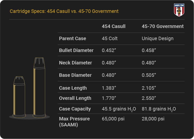

The 454 Casull is based on the 45 Colt. Its bullet diameter is 0.452”, and its neck and base diameters are 0.480”. Its case length is 1.383”, making the overall length 1.770”. Its capacity is 45.5 grains H2O. Thanks to the 454 Casull’s longer case, 45 Schofield and 45 Colt cartridges can both chamber in a 454 Casull firearm (but not vice versa).
The 45-70 Govt was a unique design, without a parent case. It uses a bullet with a 0.458” diameter. Its neck diameter is the same as the 454 Casull’s (0.480”), though its base diameter is wider (0.505”). The 45-70 case is significantly longer than the 454 Casull case at 2.105”, translating into an overall length of 2.550”. The 45-70 Govt’s case capacity is substantially larger at 81.8 grains H2O.
Some might be surprised by the maximum pressure difference. The 45-70 Govt has a max pressure of 28,000 psi – much lower than 65,000 psi for the 454 Casull.
