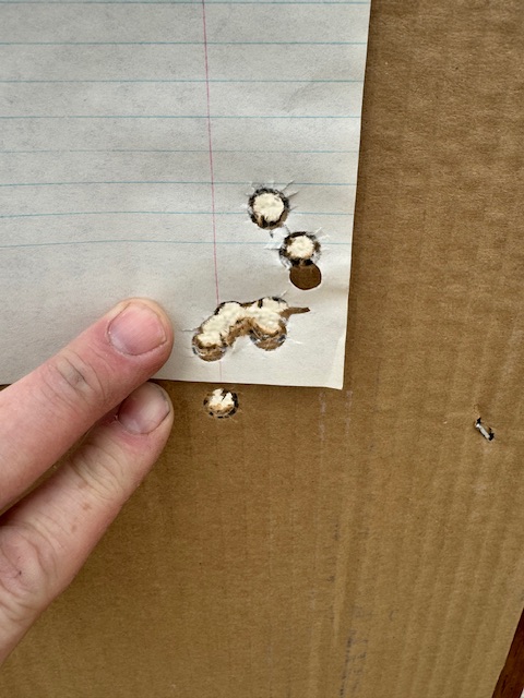

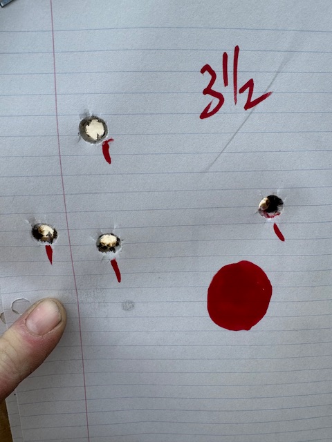

So this is my 41 Special the tight group is 2 complete cylinders 15 yards from my shooting bag. The second picture is 25 yards standing modified weaver stance. All rounds were 41 Special brass, 215 grain Keith bullet 12 BHN 6.0 grains of 231 over a WLP primer at 900 fps.
