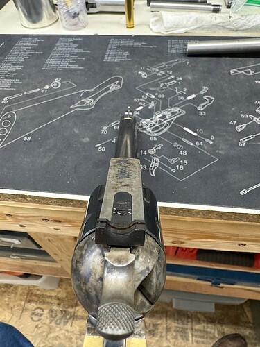

I will write more over the next few days. Here is a couple pictures of how i left a custom 41 last night.
IMG_9624
IMG_9623
IMG_9621
IMG_9618
IMG_9642
IMG_9641
IMG_9640
IMG_9643
IMG_9635
IMG_9634
IMG_9633
With the exception of the rear sight the revolver is done!!
Gorgeous gun. You do your on finish, including Color Case? The trigger guard frame, is that bronze or brass? Nice grips as well.
One custom/thought I have had, has been a rimmed 10mm equivalent. But in an L framed double action…if you can put seven 357’s in an L why not six 40’s? With two primary loads, 180gr HP at about 950 fps, and a max load of 200gr at about 1200 fps. The key being in a lighter L frame, with std or light barrel, no underlug. Then a Ruger/Marlin or Win 94’ in same caliber. Sound doable?
BW
I am laughing so hard right now! Everything you just listed can be done with the 41 Special! When i proof my new custom builds i proof them with a load of XTP JHP at 1450 fps. Then with a lead Keith at 1425 fps. So after the famous FBI shoot out in Miami the bureau spent millions on developing the 40 S&W and of course bullet designs for the 10mm. So put the two cartridges on a piece of paper and next to them put the 41 special. You have a revolver cartridge that is the same as either of these automatic rounds but in a revolver cartridge. Just load it up or down.
It might be a little bit as i have so many other projects but i am making a matching 1892 41 Special trapper with a 14” barrel in 41 SPL. I also made a 14” octagon barrel for a short rifle in 41 SPL. I still prefer my favorite load of 900 fps! But the 41 is very versatile! I just prefer it in the solid special velocity range.
Yes i do all my own finishing. BLACK OXIDE Bluing, Niter bluing, Rust bluing, parkerizing and color case hardening etc. yes it is brass frame!
The front sight is a Marble Sheard #10 off a 1895 Winchester. The rear sight (I am waiting on) is a Fermin Garza two dogs #7. The grip frame is RW grip frames, barrel from a McGowen barrel blank, bulls eye ejector from Borchardt rifles. Chamber reamer from Manson reamers The rest is just lots of work and time!!!
