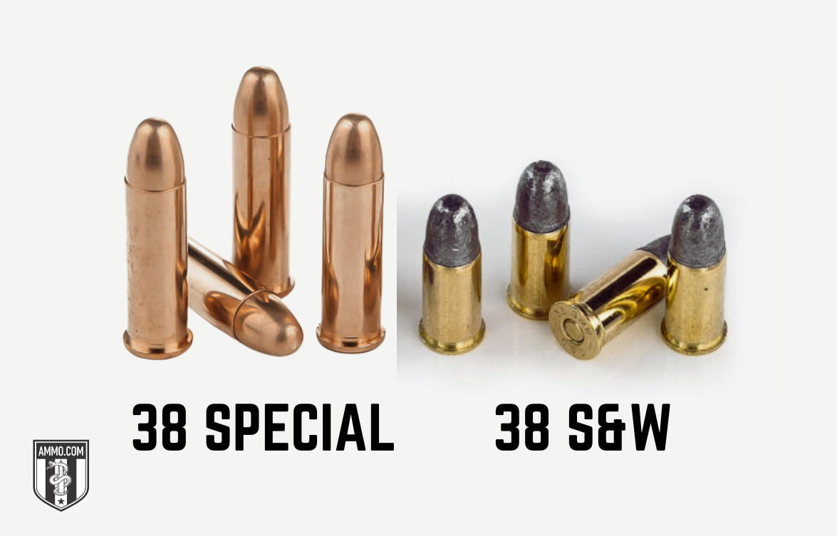

The 38 Special and 38 S&W are two different cartridges. Once you see the rounds side-by-side, it’s impossible to mix them up. However, with names so similar, it’s completely understandable why so many new firearm enthusiasts mistake them for one another.
Let’s see just how different these cartridges are and illustrate their relative pros and cons.
Is There a Difference Between 38 Special and 38 S&W?
Yes: there are significant differences between 38 Special and 38 S&W, the most obvious among them being their lengths. The 38 Special is longer than the 38 S&W, having a case that is nearly as long as the 38 S&W’s overall length.
Refer to the comparison chart below to see how these cartridges differ in size.

Are 38 S&W and 38 Special Interchangeable?
No, 38 S&W and 38 Special are not interchangeable. They fire bullets of different diameters and have other important dimensional differences, making it extremely dangerous to fire one in a firearm chambered for the other. DO NOT attempt to fire 38 S&W ammo in a 38 Special firearm, or vice versa.
