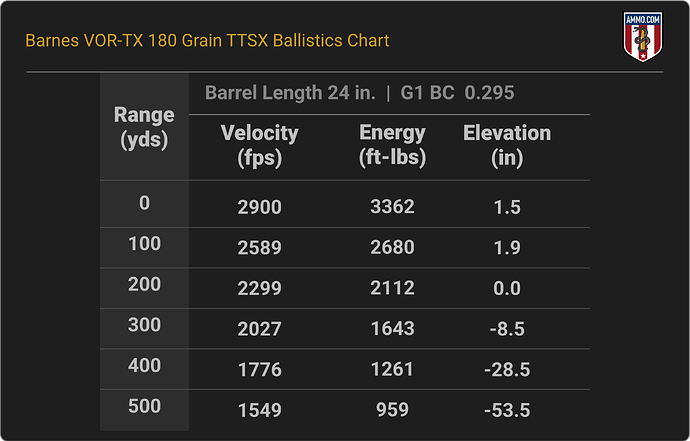

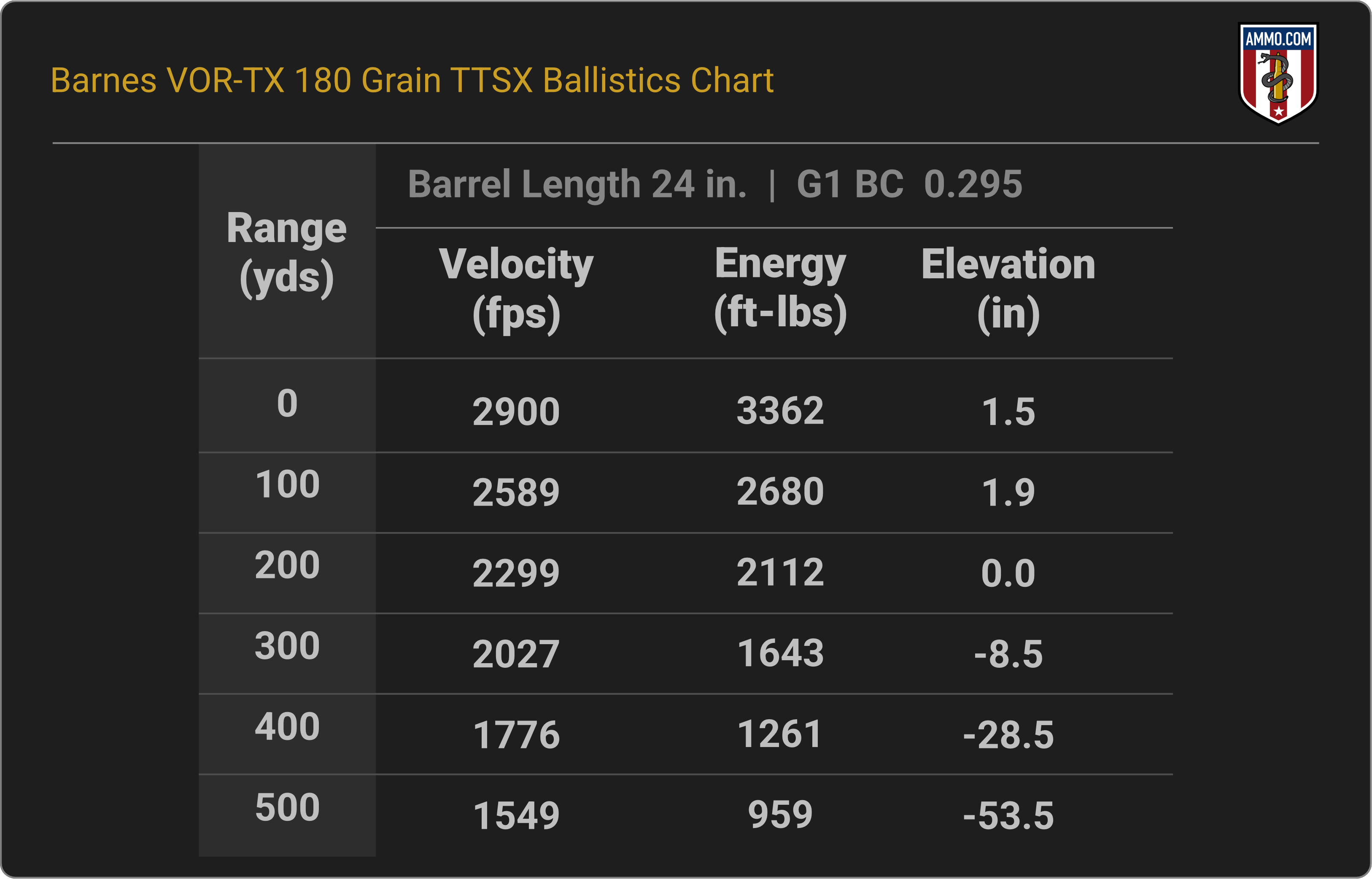

Barnes
VOR-TX 180 Grain TTSX

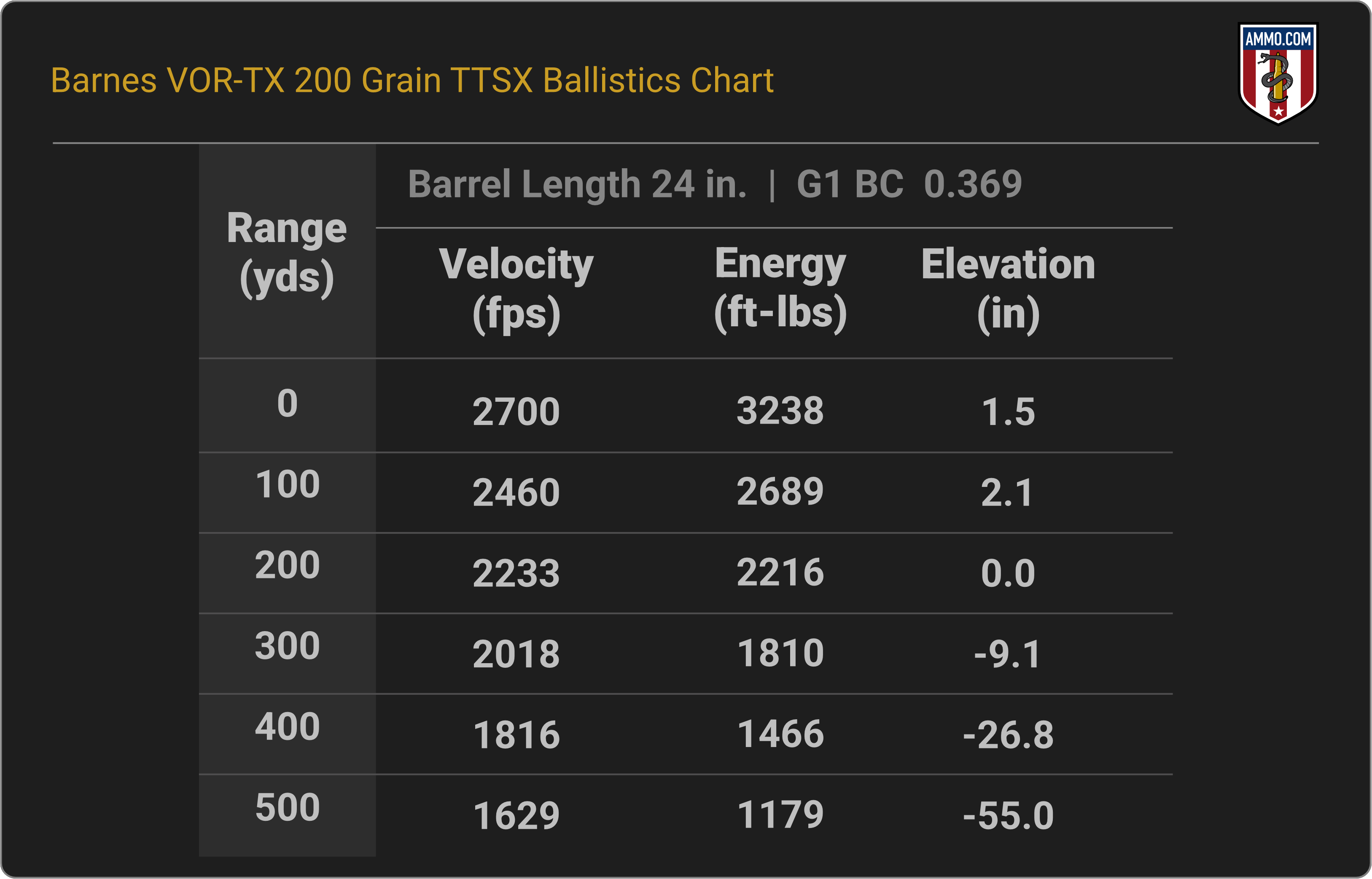

VOR-TX 200 Grain TTSX

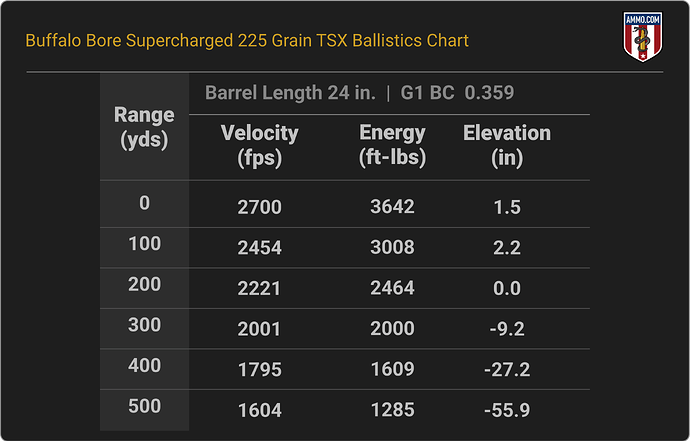

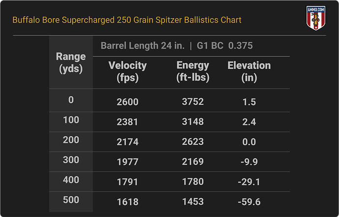

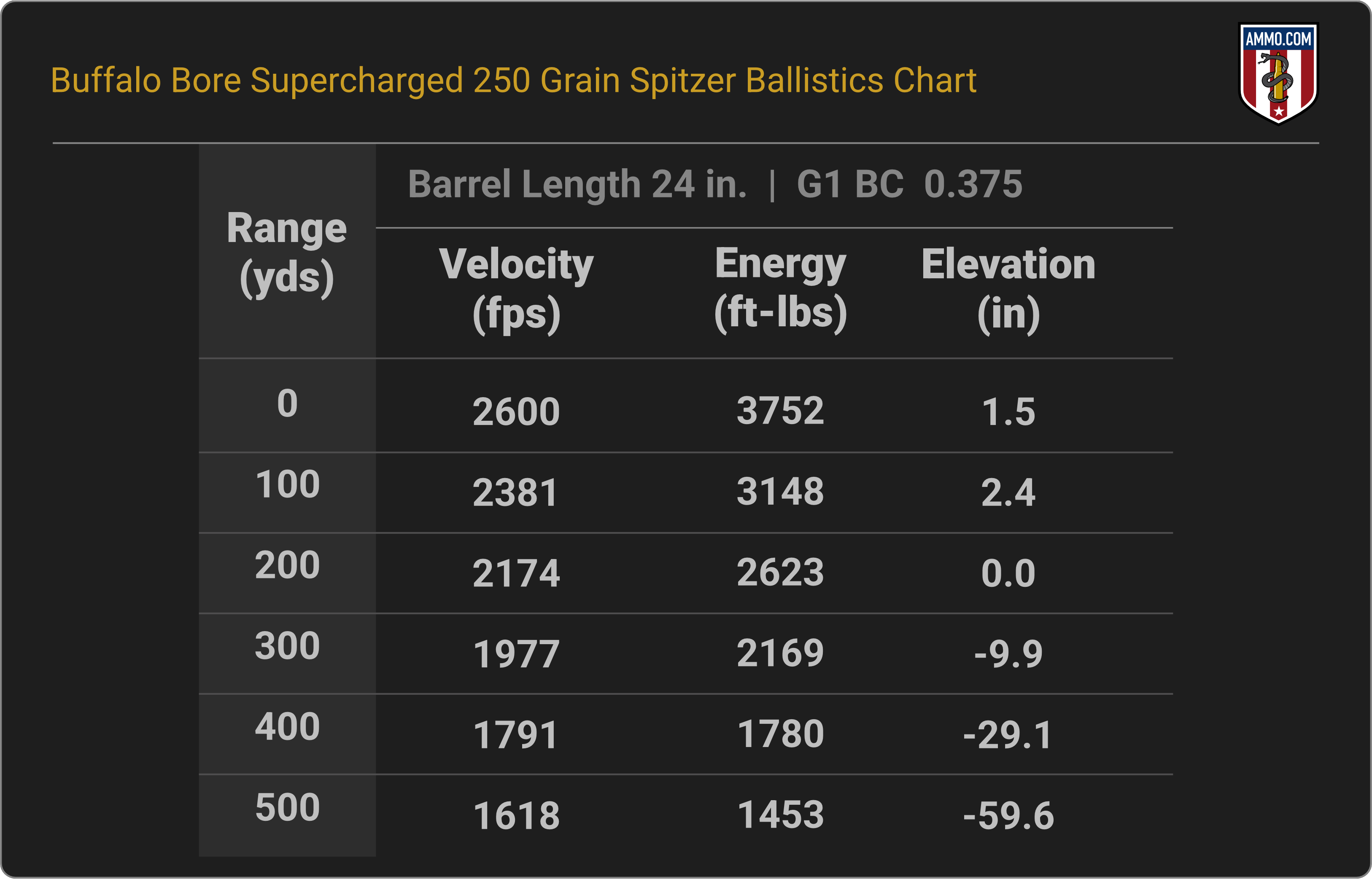

Buffalo Bore

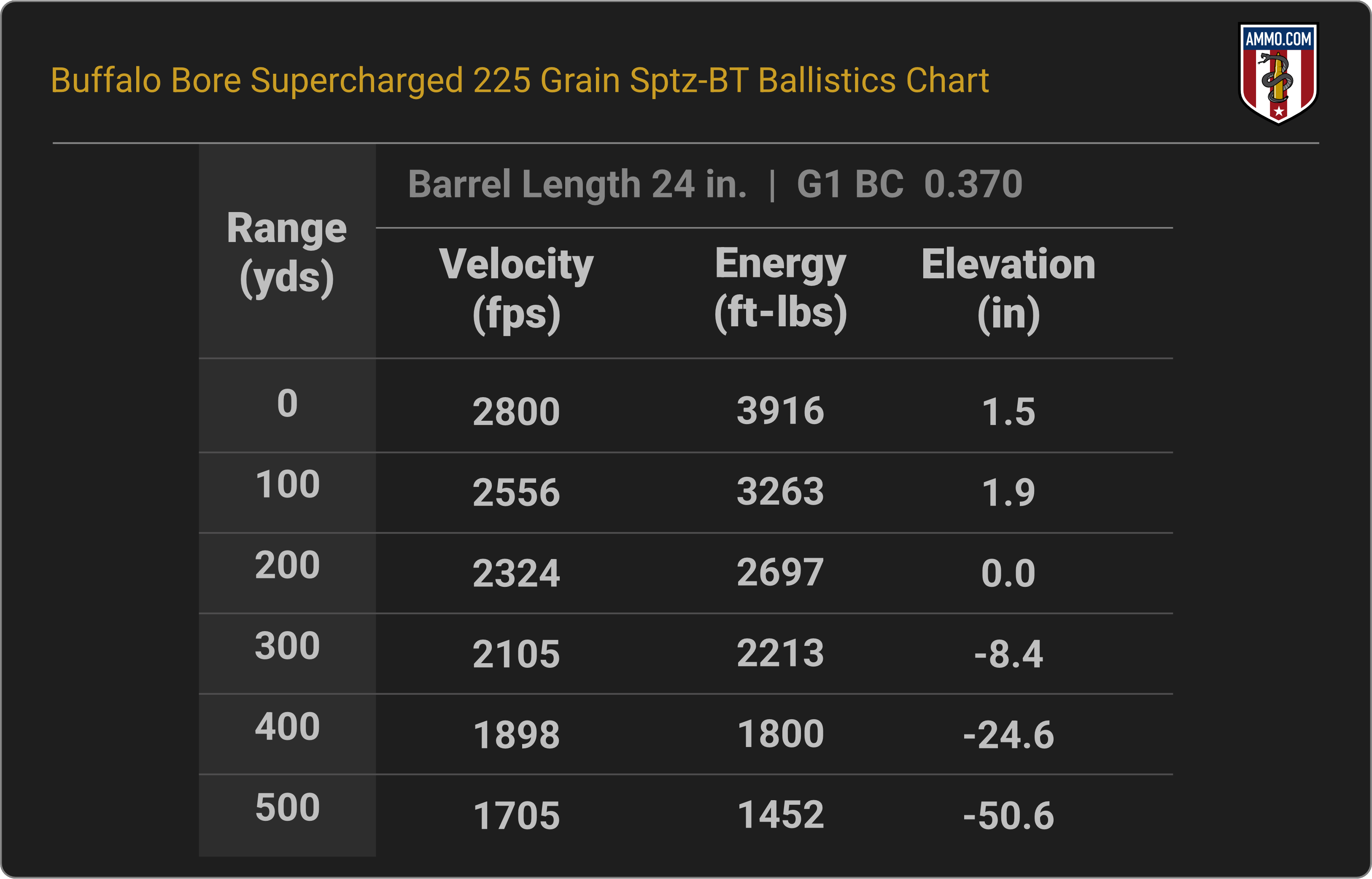

Supercharged 225 Grain Spitzer Boat Tail

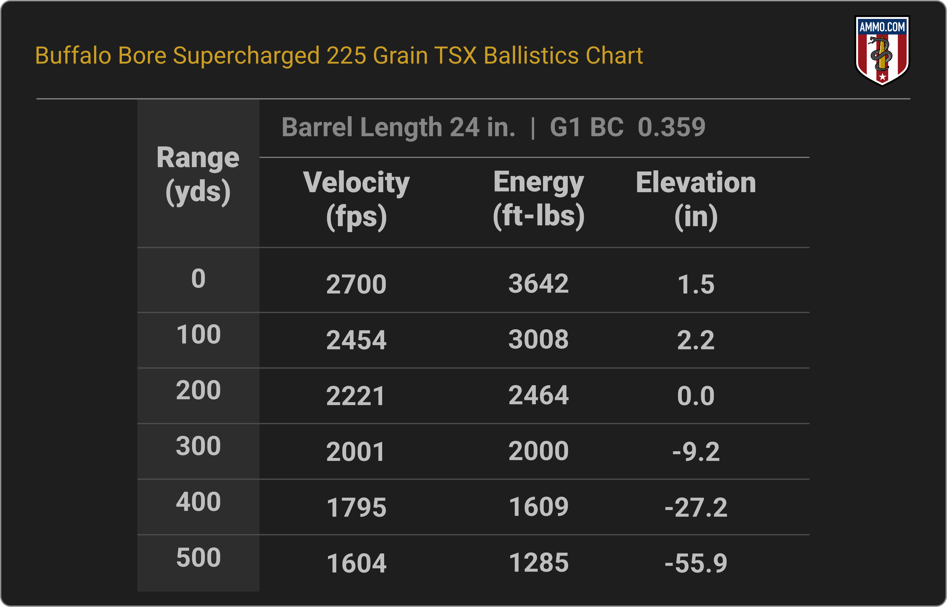

Supercharged 225 Grain TSX
Supercharged 250 Grain Spitzer
