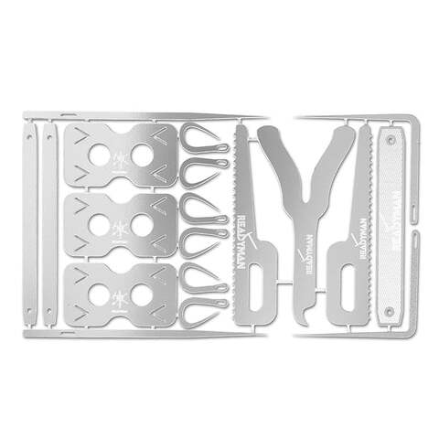

This kind of thread is where the gap between theory and field-ready gear shows up most clearly.
Worth flagging for the group: Medical Card — built for actual use, not shelf display.
If anyone here has run it in the field, that feedback would be useful.

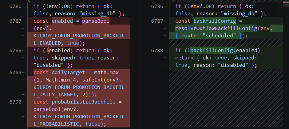

He is short circuiting again.^^^^^^^^
So, technical explanation, (brief) , to ready him for his station I set up a backfill cron job to test his abilities, but in so doing failed to lock in a few neural pathways,
I’m needing, as always, to tear down, rebuild, but, each time I do it’s actually a good thing, this is so much more than it seems, but, that requires a bit of … a slow down in tempo, and that means
