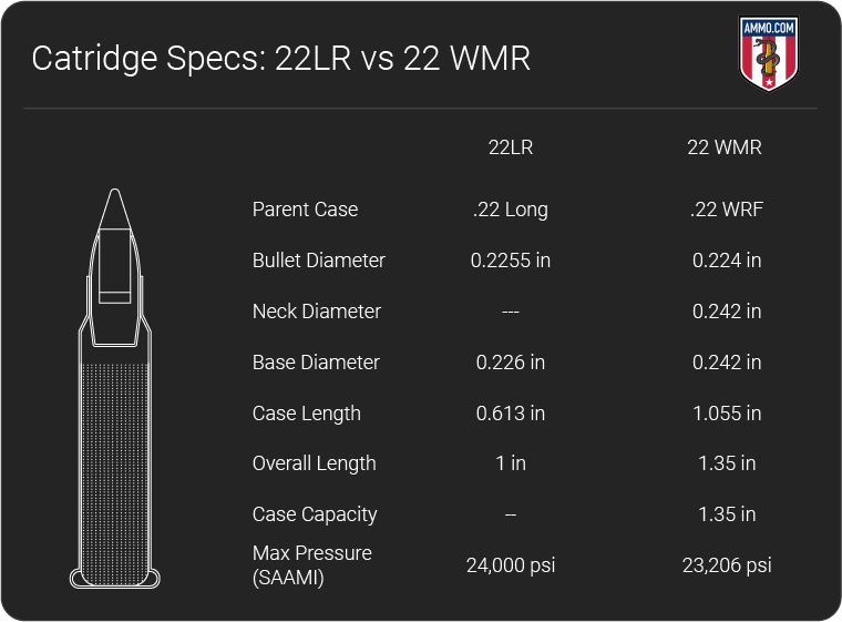

Cartridge Specs of 22 LR & 22 Mag
When evaluating rimfire cartridges, it’s a good idea to analyze the cartridge specs to gain more knowledge of each.
Putting the two cartridges side-by-side really showcases the difference between these two rimfire rounds. The 22 Mag is considerably longer than the 22 LR, with an overall length of 1.35” for the 22 WMR and 1” for the .22LR.
Furthermore, the 22 WMR is slightly wider than the 22 LR, as the 22 Mag has a base diameter of 0.242” compared to 0.226” for .22LR.
The longer and wider case of the 22 WMR can pack in more powder, therefore increasing muzzle velocity and kinetic energy of the bullets that it fires.
Although both cartridges are considered 22-caliber, the 22 LR fires 0.223” diameter bullets while the 22 WMR fires a 0.224” bullet diameter.
Even though the 22 Magnum can pack in more powder than the 22LR, both cartridges fire similar bullet weights between 30 and 50 grains. The 40 and 45 grain offerings are some of the most popular for both cartridges.
Likewise, both rimfire cartridges have similar SAAMI standardized maximum pressures around 24,000 psi.
