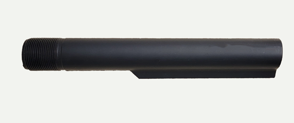

I am pretty sure that he is using a rifle receiver extension with a very heavy buffer.
I did 2-3 things at once so don’t know for sure, but first off I double checked my headspace to make sure the BCG wasn’t ramming the case mouth into the front of the chamber.
Headspace was good so I took my 10mm finishing reamer I use on the 1911’s and pushed it in until it hit the shoulder, then turned it with minimal pressure on the shoulder. It cut a bit of rifling, I think that was really the issue all along. No lead for a little bullet jump.

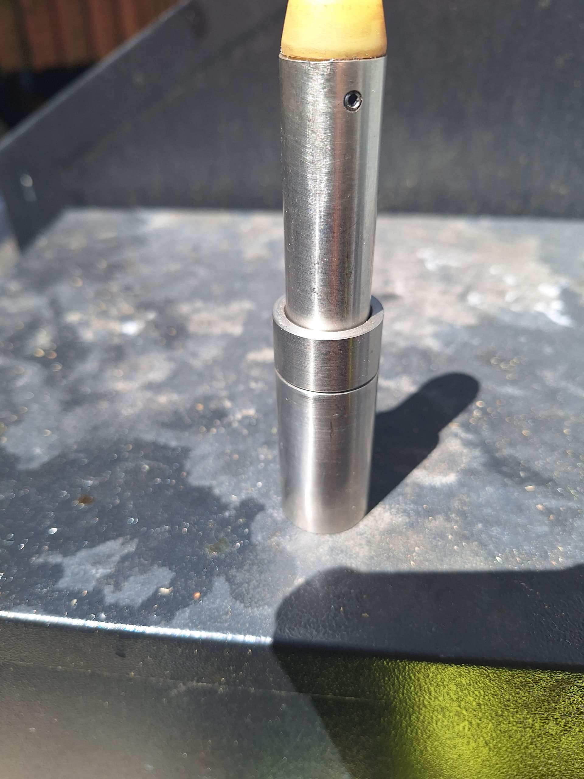

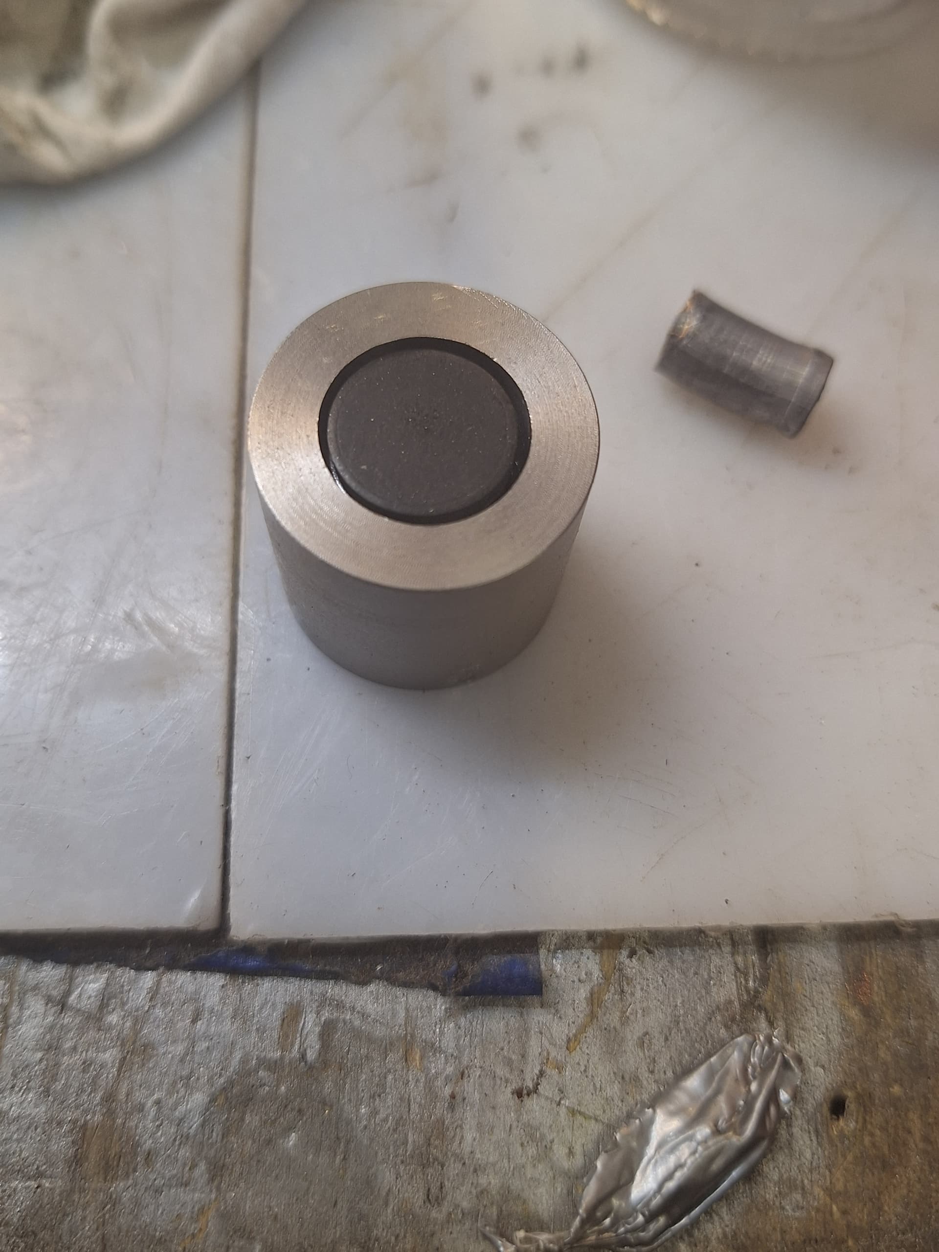

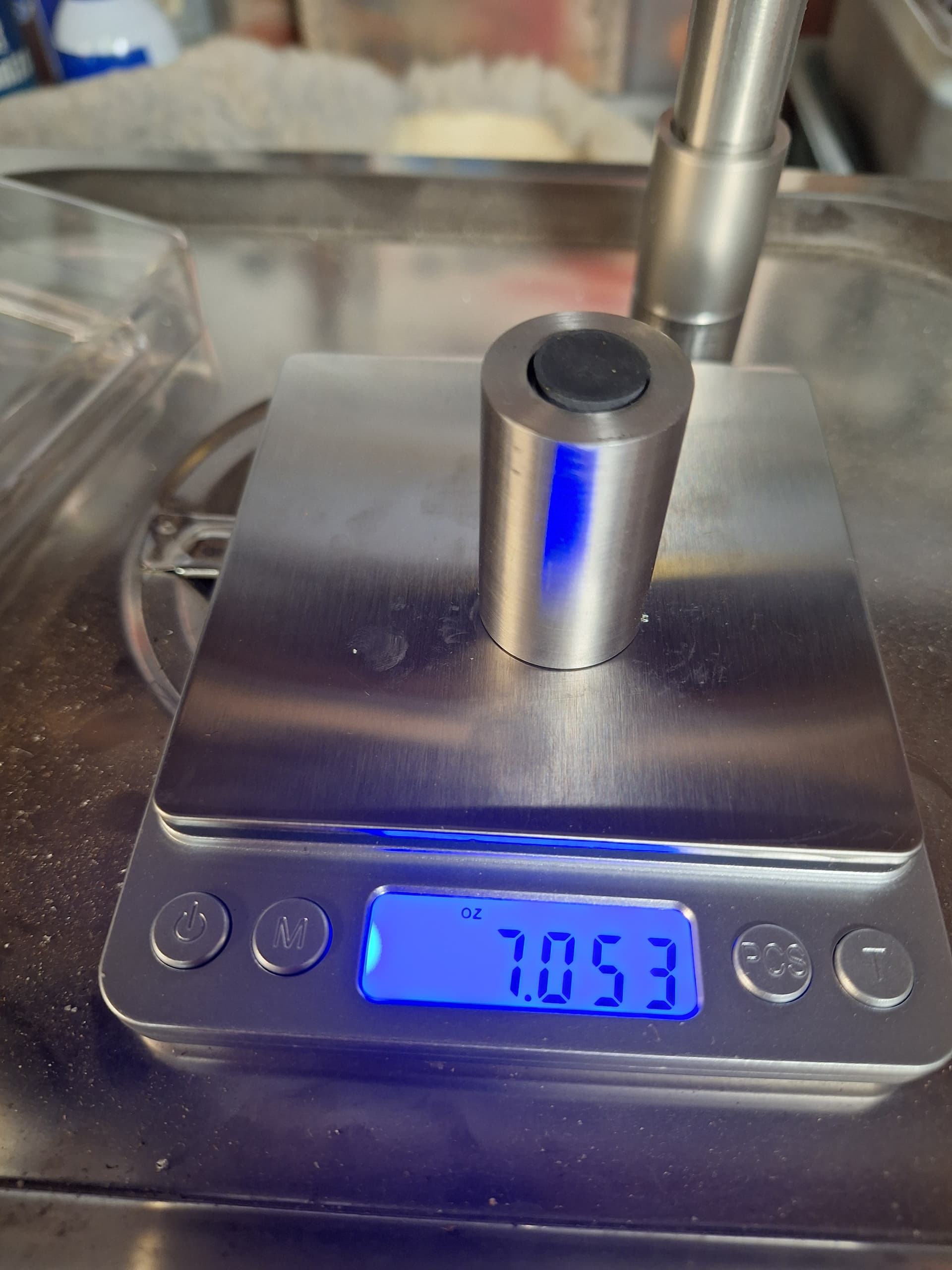

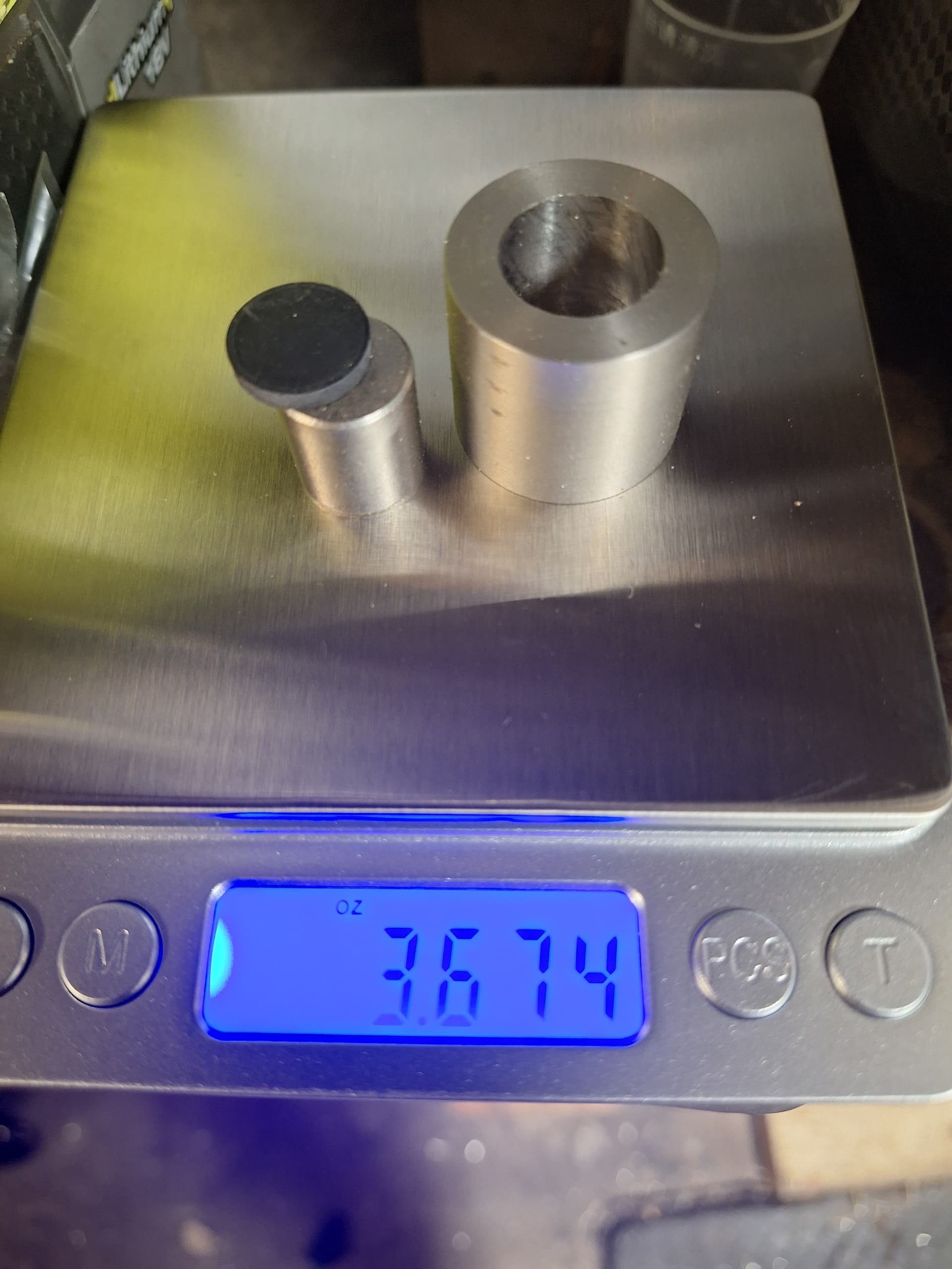

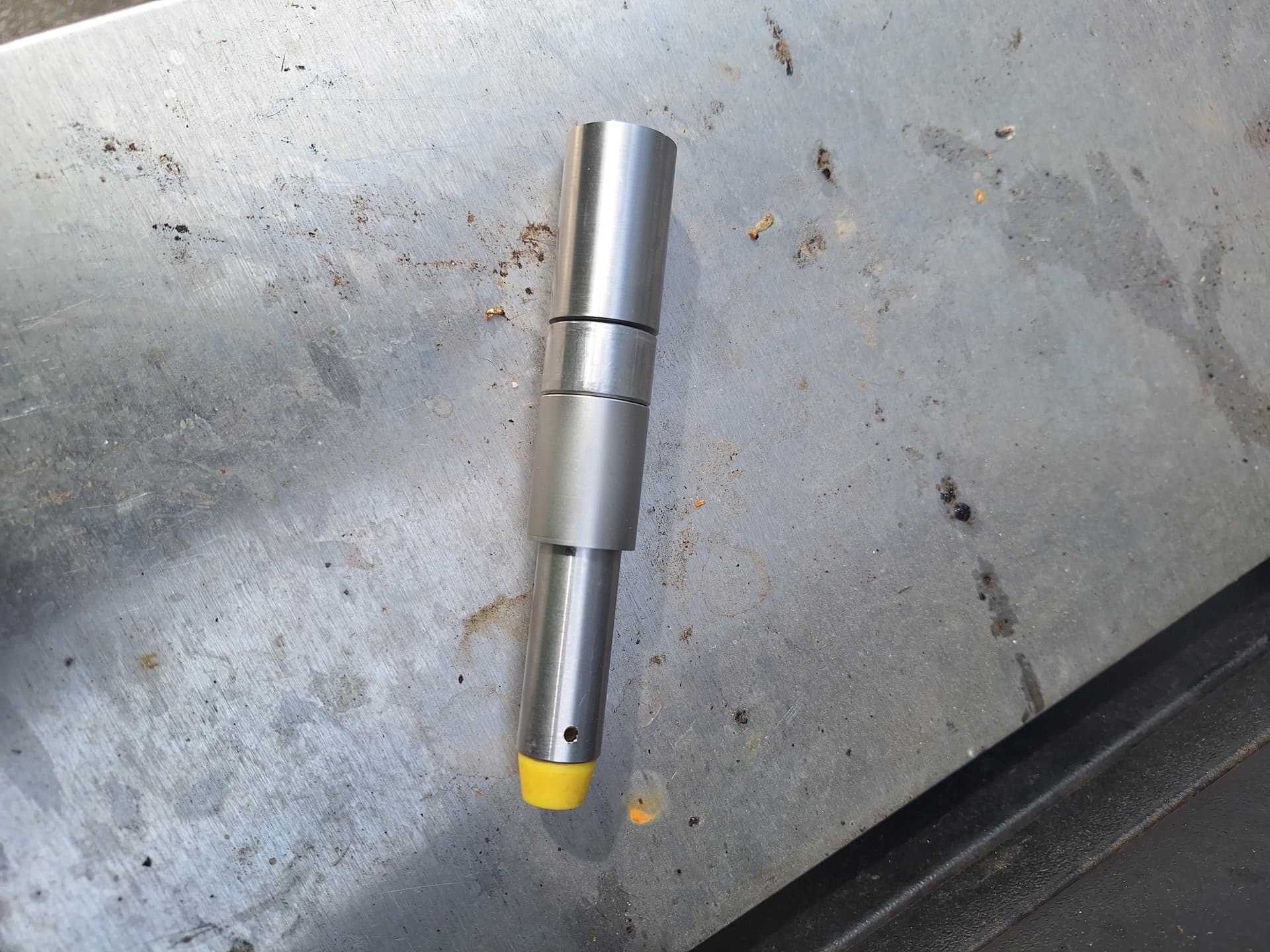

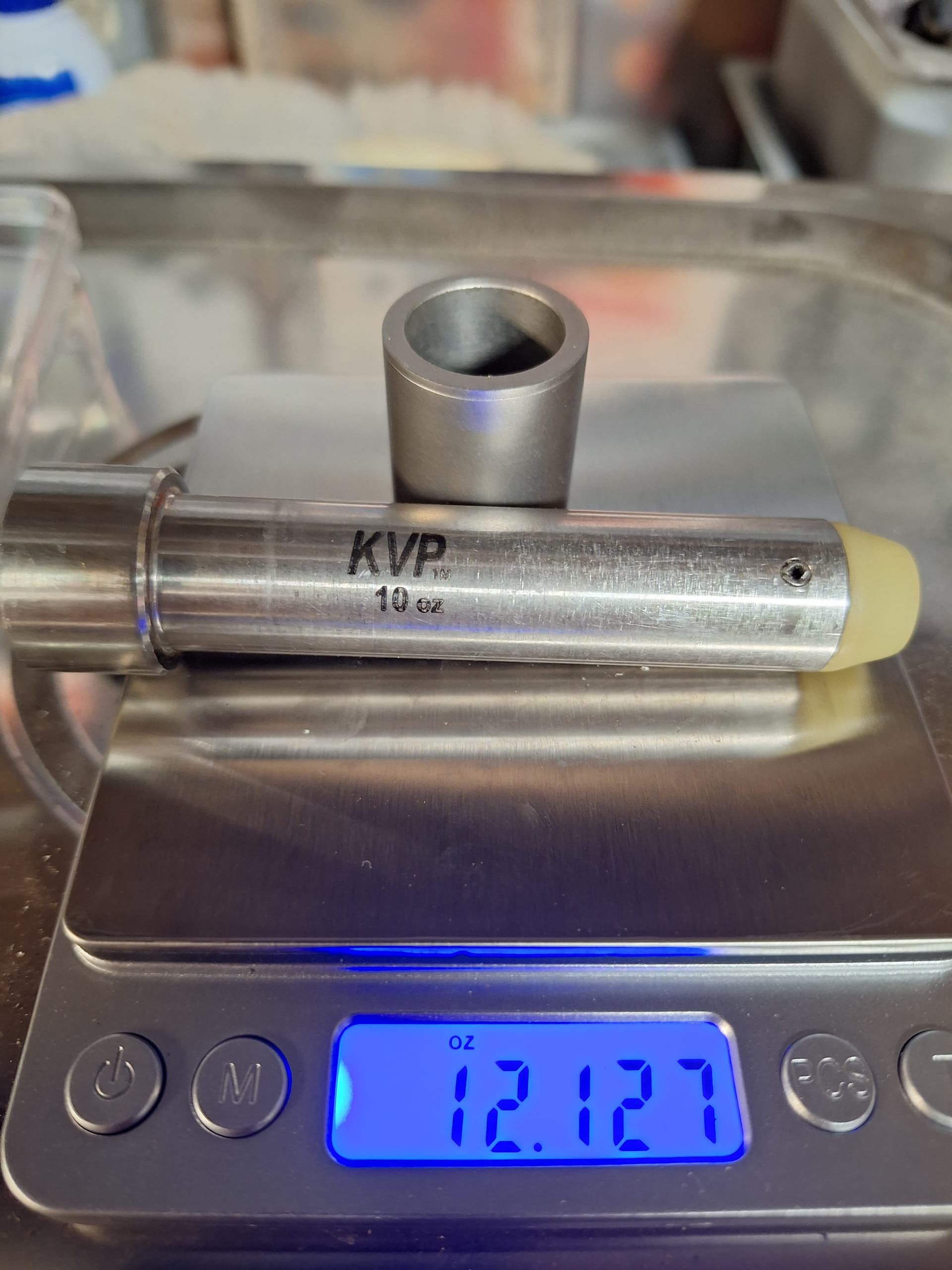

I also got an 8-1/2" Carbine extension from Just Right Carbines, didn’t even know they existed until recently. 3/4" longer then an AR 10 carbine extension, 1-1/2" longer then AR15 carbine extension That allowed for adding an additional 3+ OZ of buffer. So my recoil mass is right at 34oz including the BCG. (Compared to 24oz for 40S&W) My buffer was already made for PCC length (4-1/8") + 3/4" because I was running a AR10 length extension, so made a 3/4" weight with 2 bumper pads and a tungsten weight. Also made a 1-1/2" weighted plug for another brother that is running a KVP 4-1/8" weighted buffer in the 8-1/2" extension.
Extra weight
4-7/8" 5 weight buffer for 7-3/4" extension
Added a sleeve for a little more weight and orange spring compression
Setup for KVP 10oz 4-1/8" buffer in an 8-1/2" tube, plus spacer sleeve adding another 1-1/2ozs. Will only work with orange spring designed for shorty 308 buffers, or maybe flatwire, will get spring bind otherwise.
KVP PCC 10oz with 1-1/2" sleeve
Assembled
