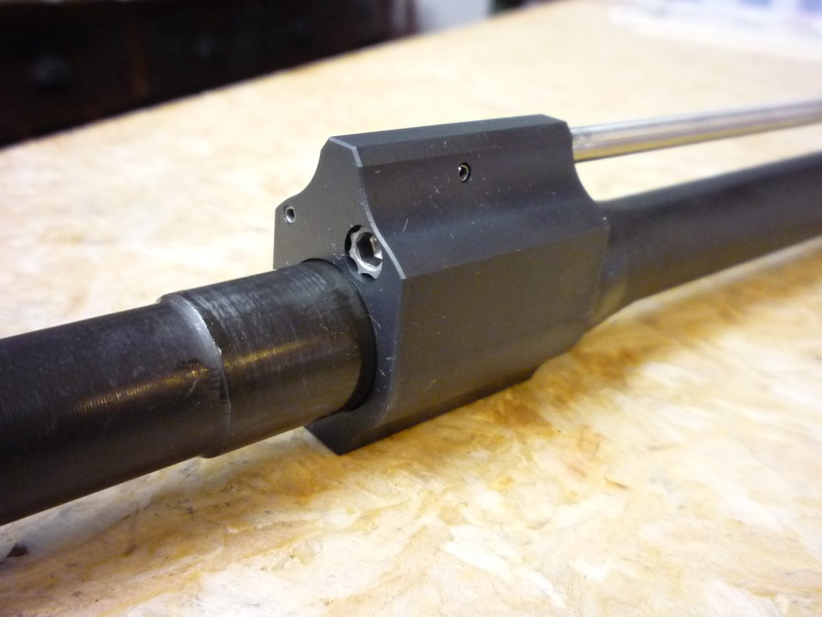

Nope, all i had was springs. gonna take it the gun guy tomorrow.
probably not enough gas getting to the bcg.
sure what it looks like, but the gas block is pinned.
Tap the pins out. slide the gas block forward and take the gas port up a couple of thousands.
the pins are tapered. don’t remember if they get removed right ot left or left to right. had to put a ball peen hammer on pins and smack the ball peen with a bigger hammer to get a set loose one time.

350 legend is fixt, they drilled out the gas port. replaced with a new valve and tube.
rings, key, what? did they tell you valve?

gas valve or some call them gas blocks
