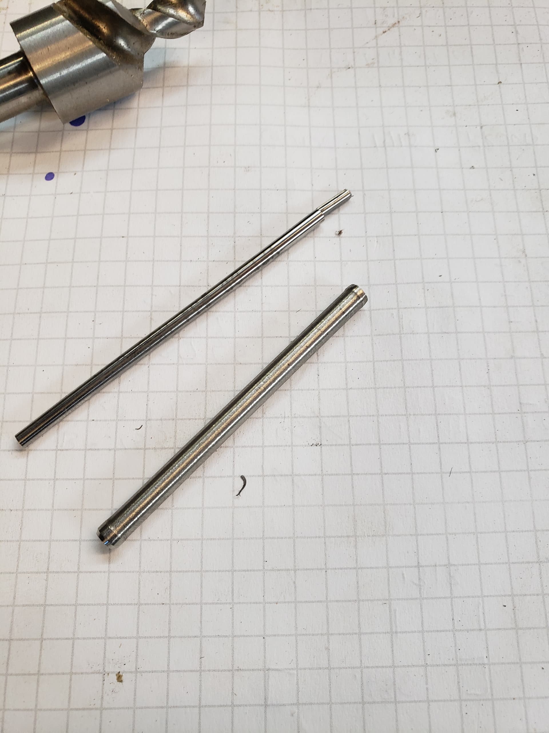

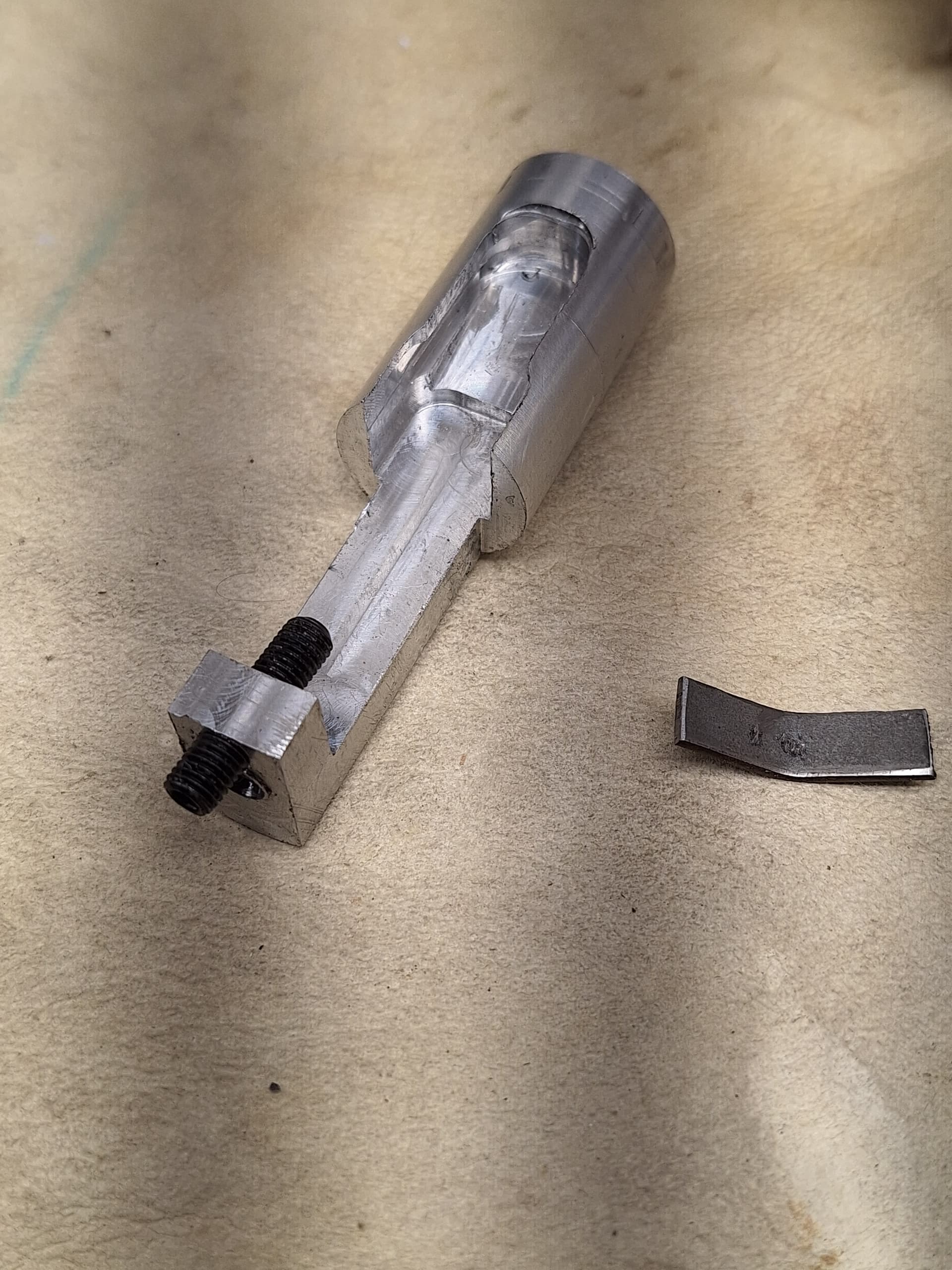

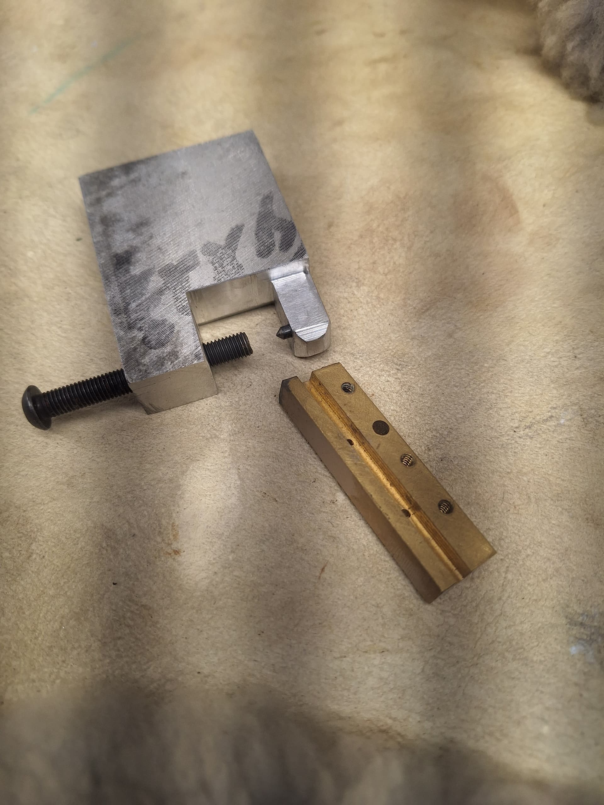

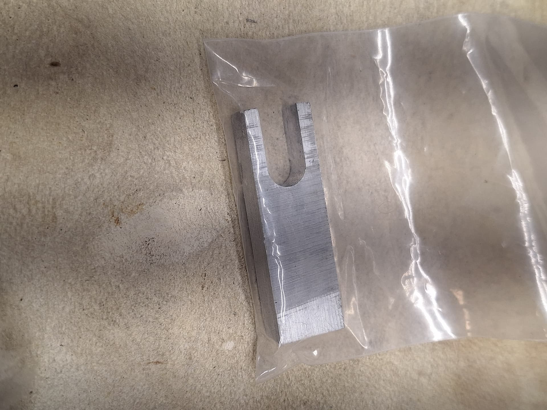

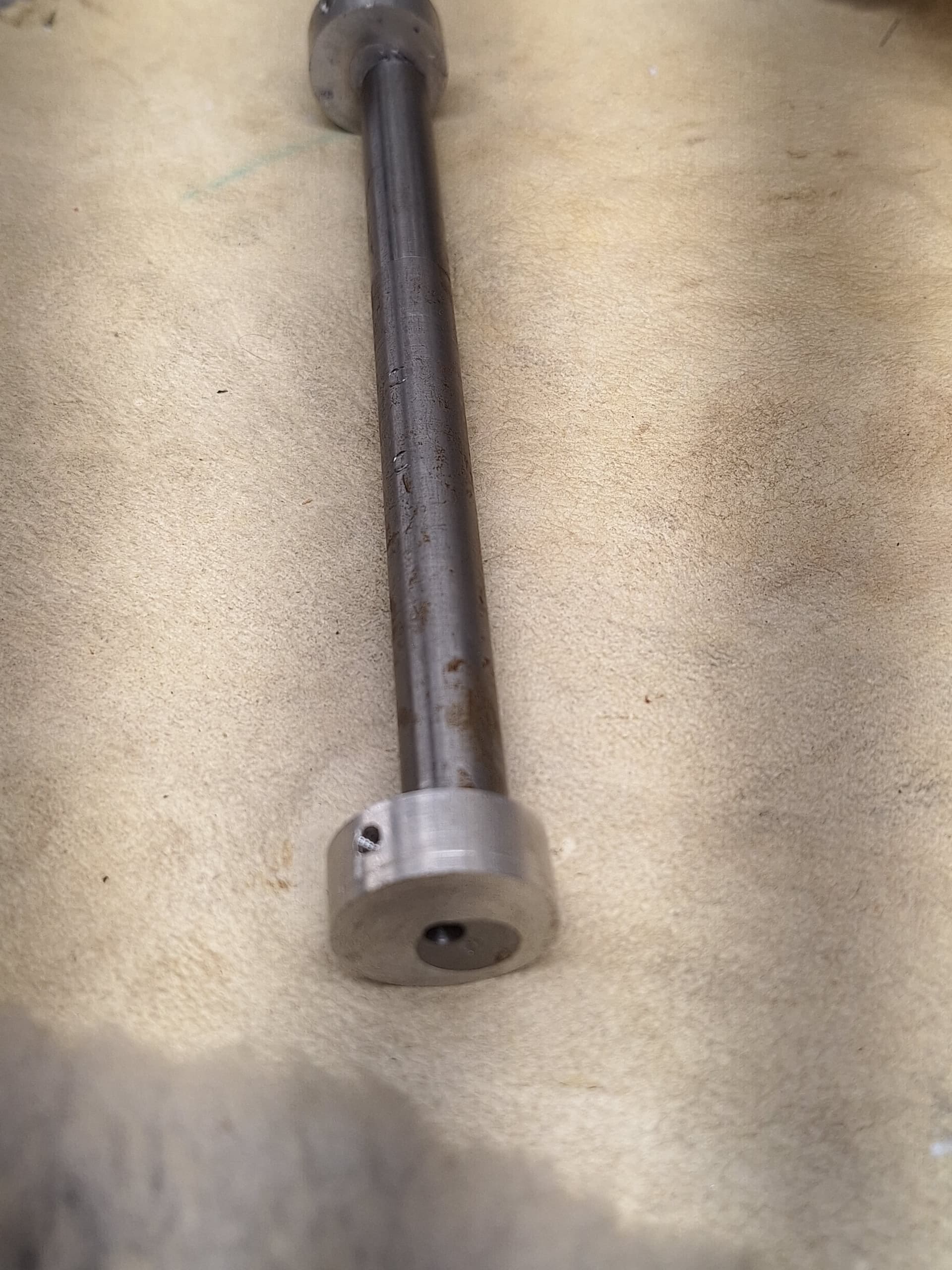

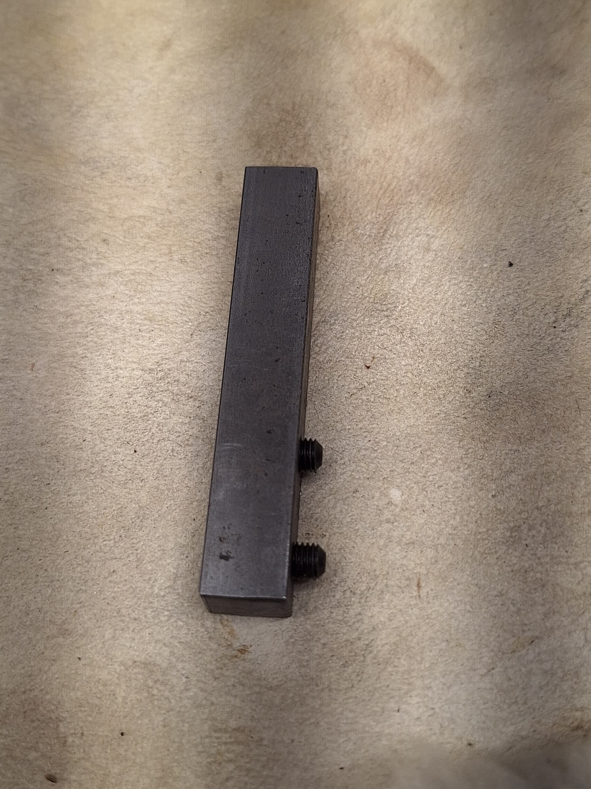

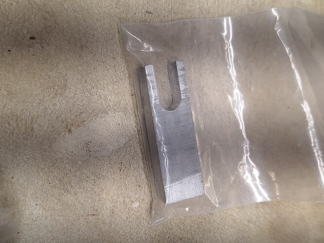

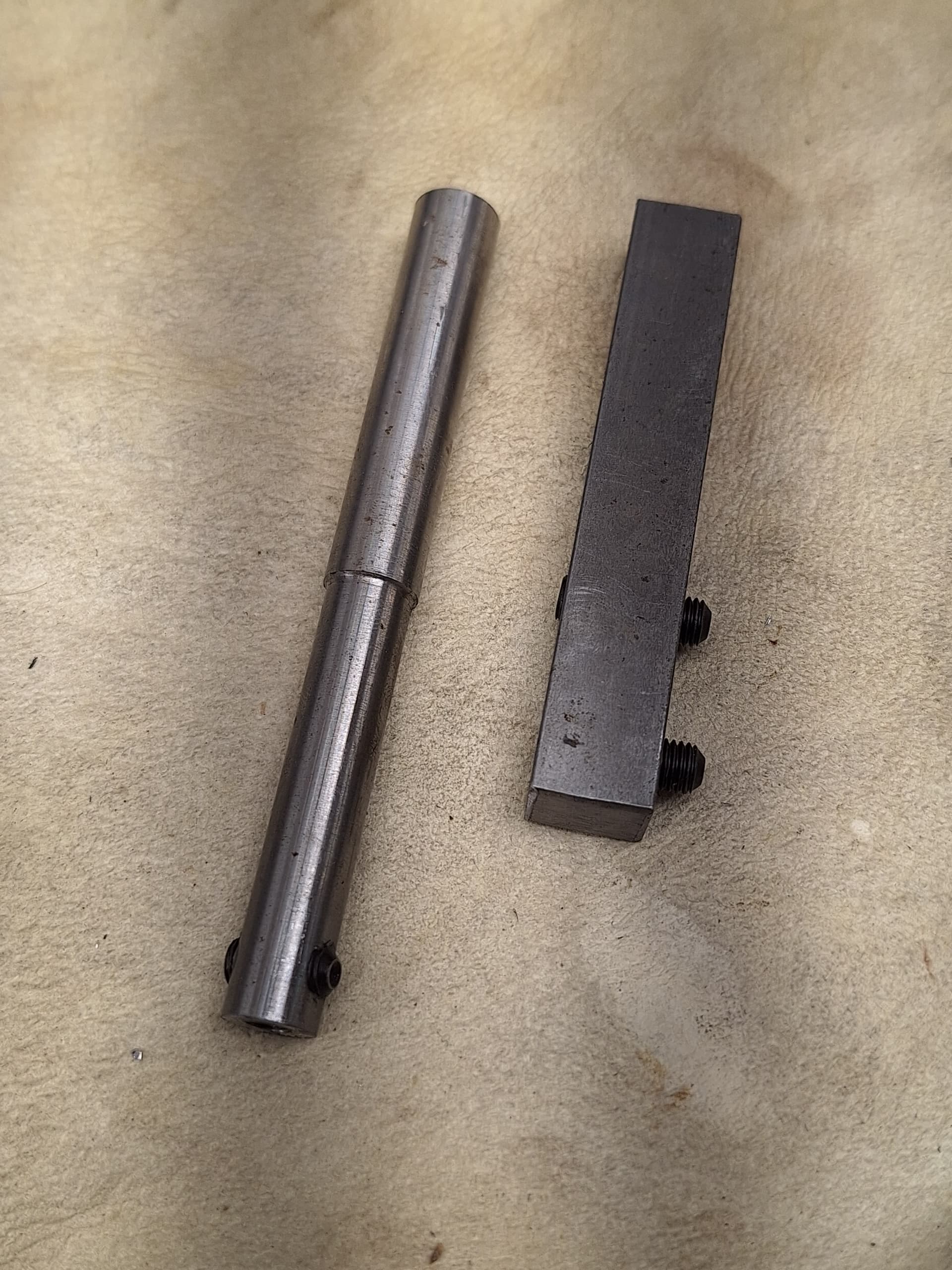

Plunger tube staking tool. Brass backing bar has been re-purposed a time or 2. Indexed drill bit to support the tube wall.

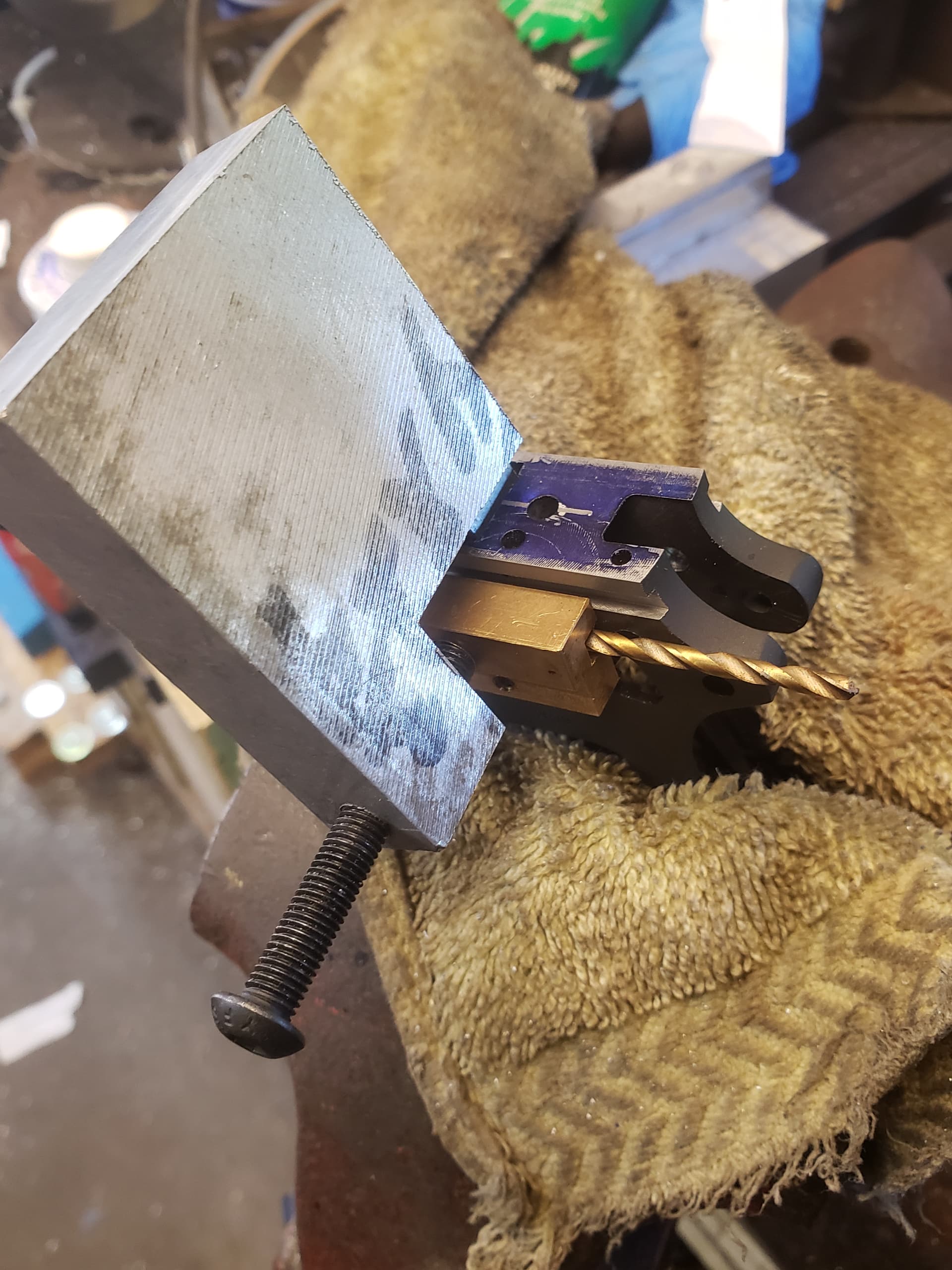

Barrel clamping bar

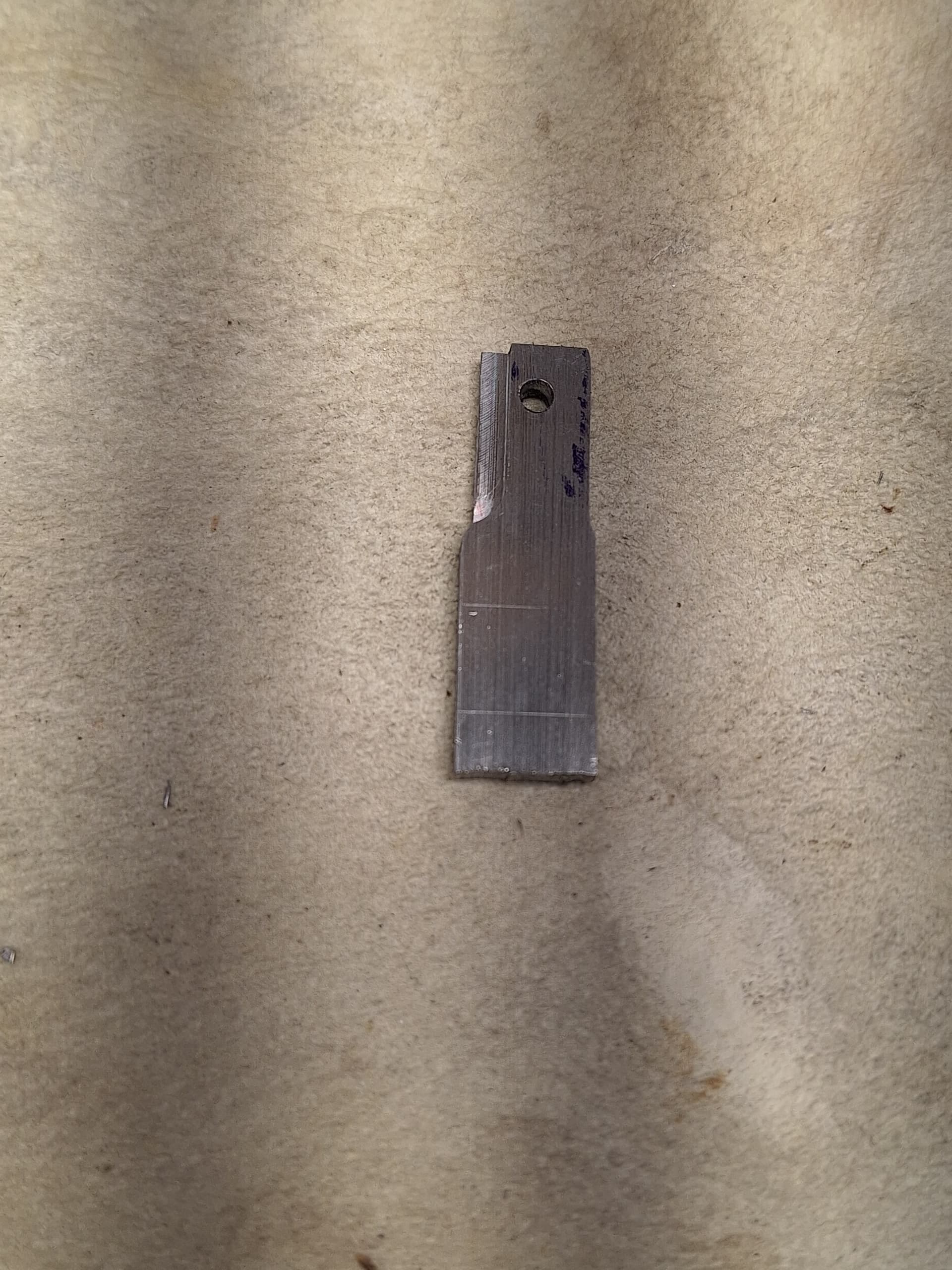

Barrel feet alignment tool 1911

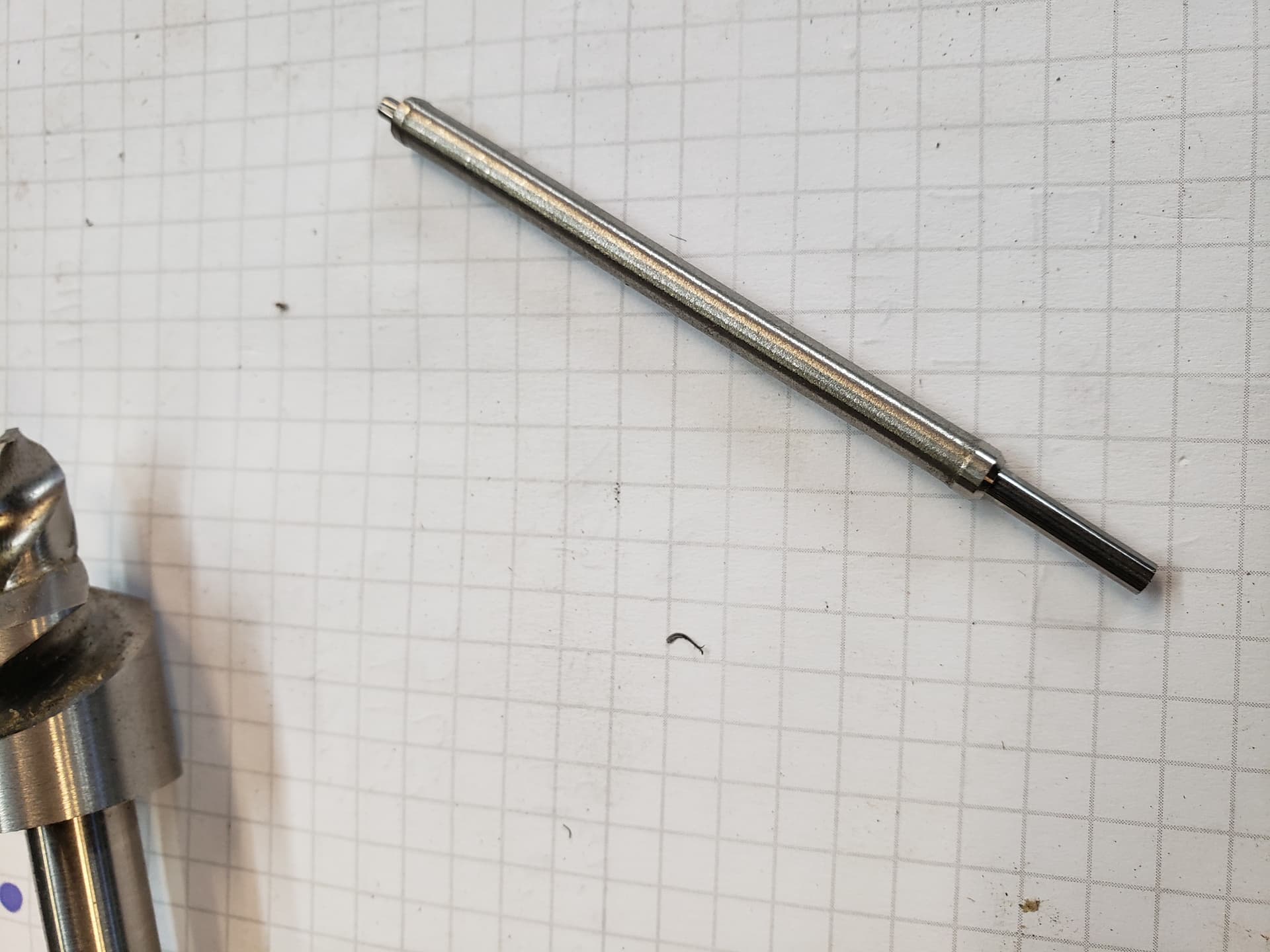

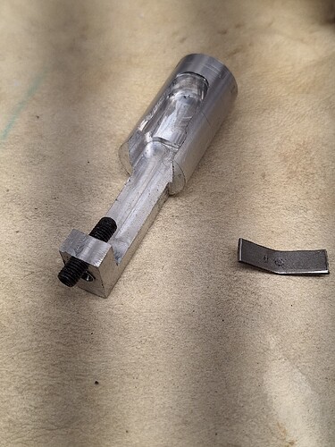

Extractor gauge 1911 10/40

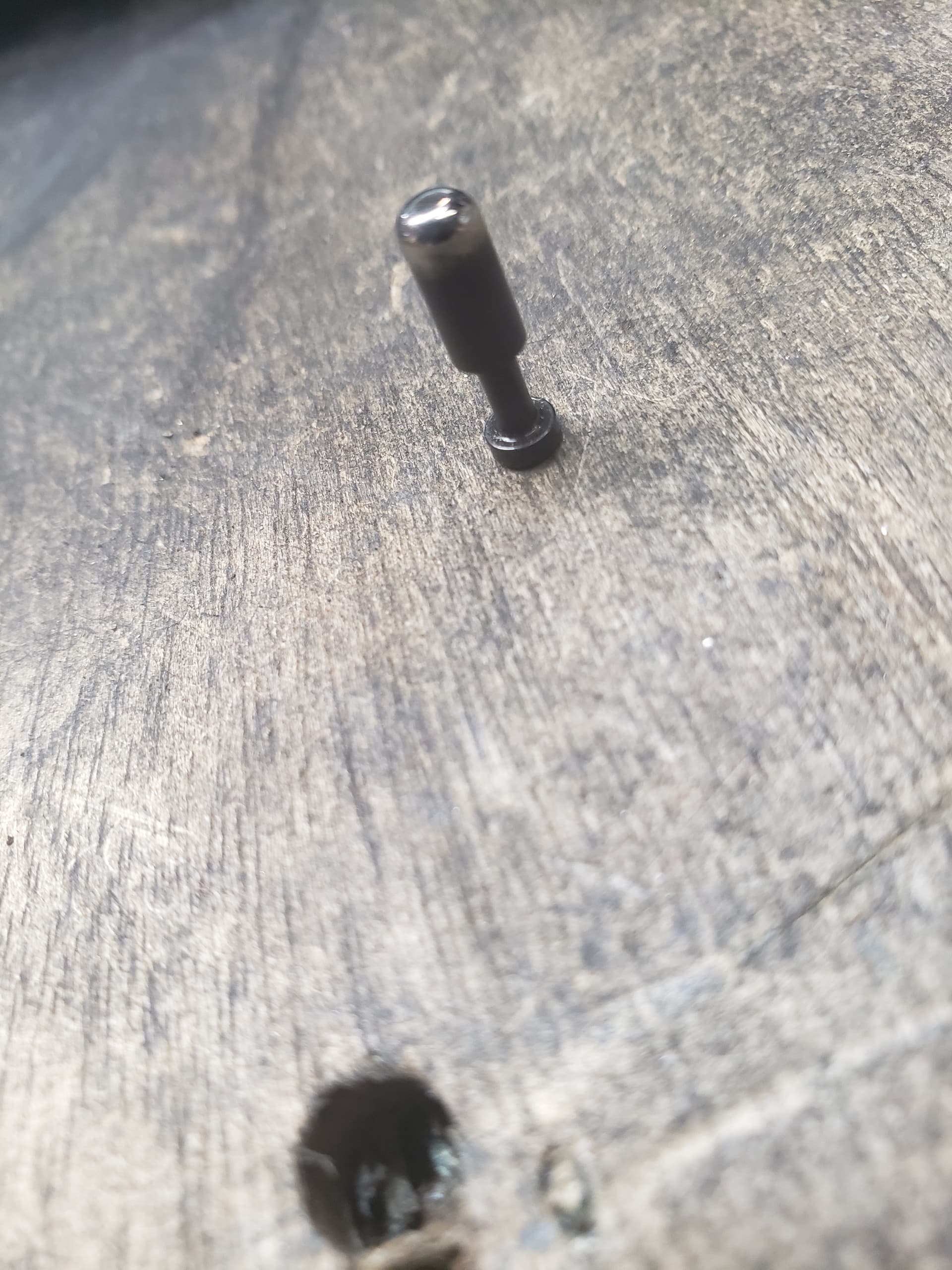

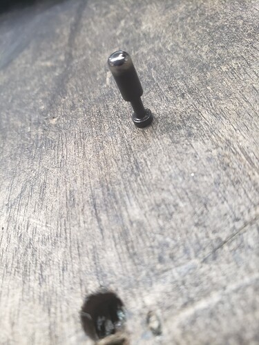

Just a cool picture of a AR308 ejector after a radius and polish job.

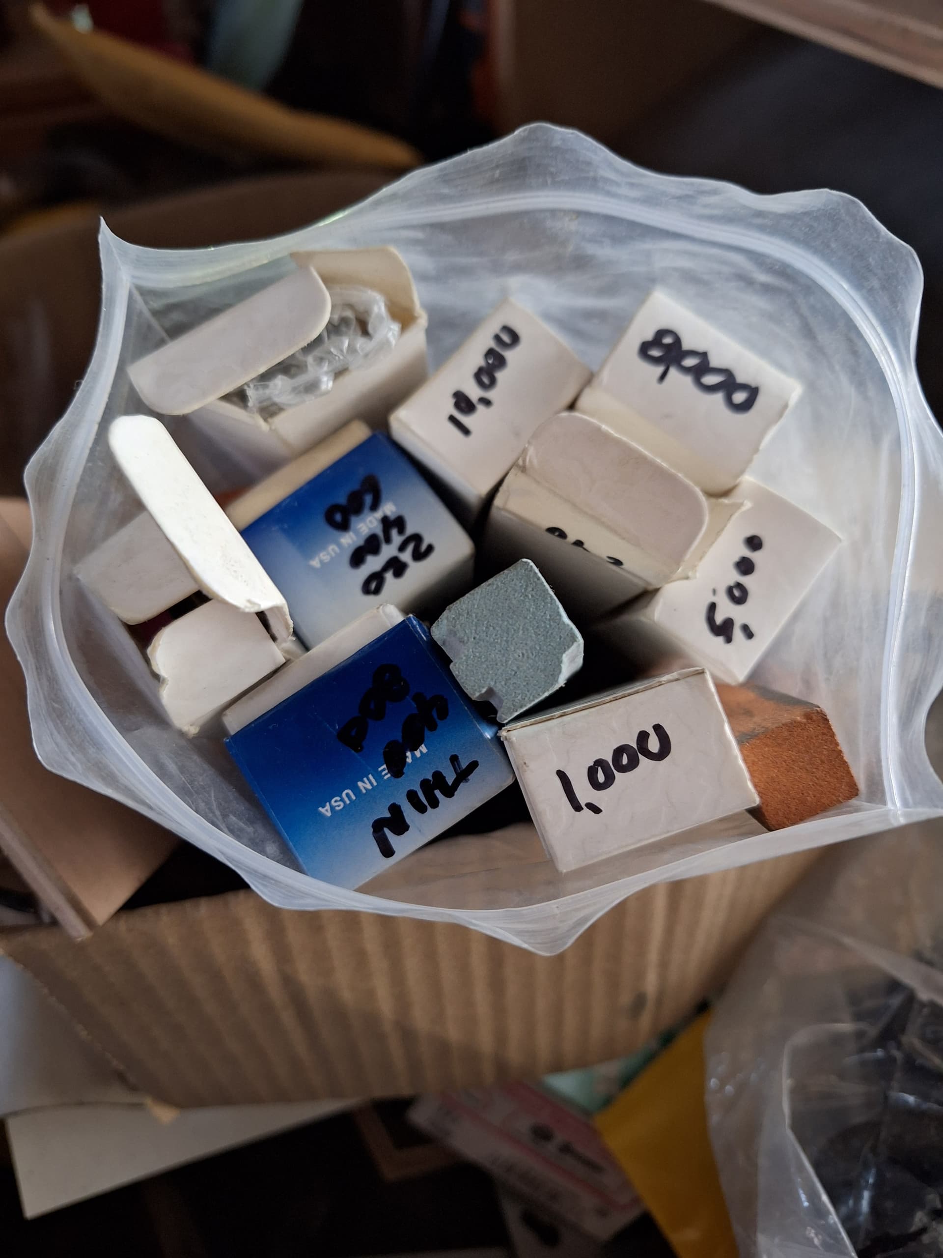

Stones

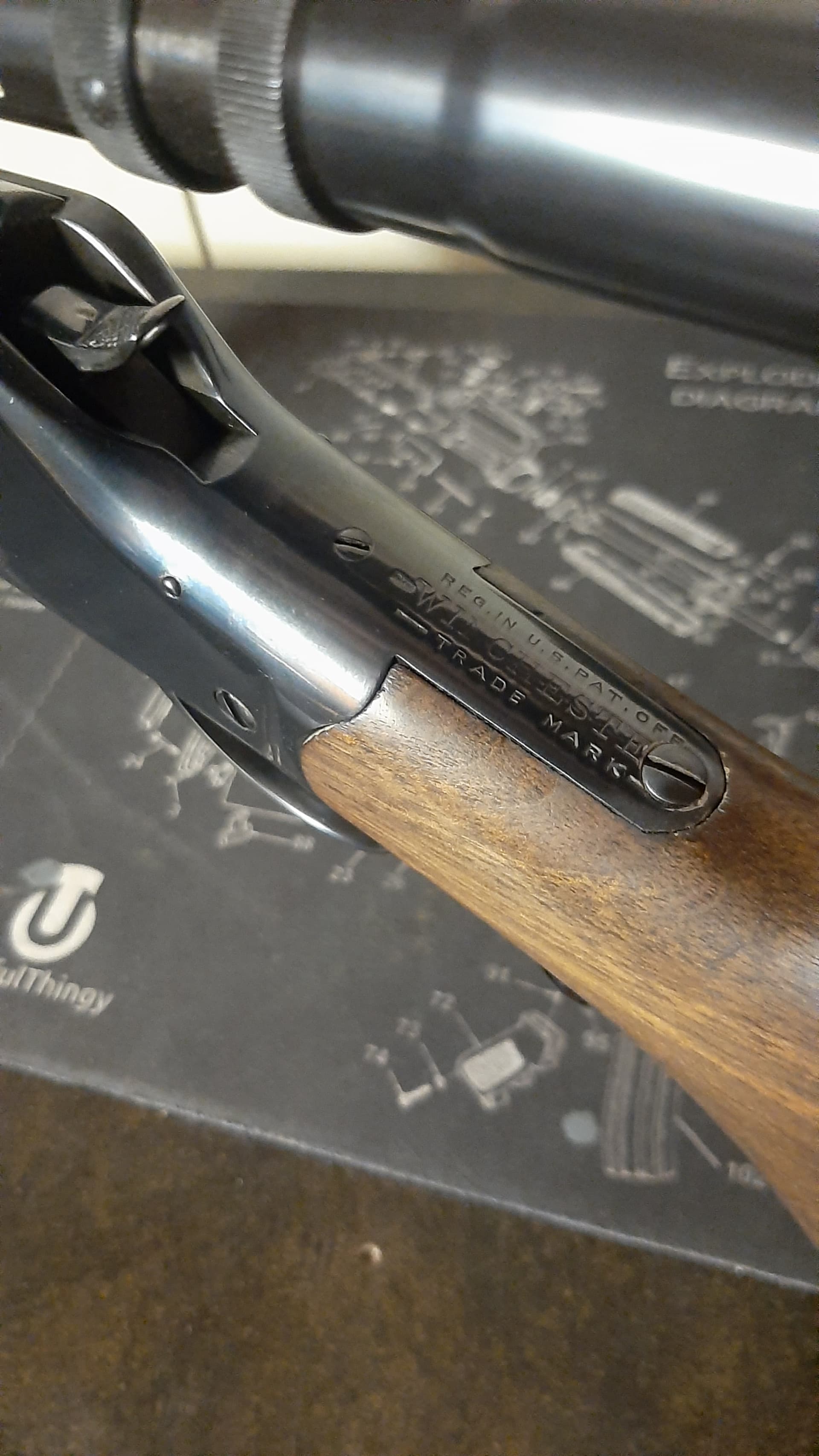

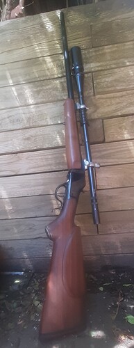

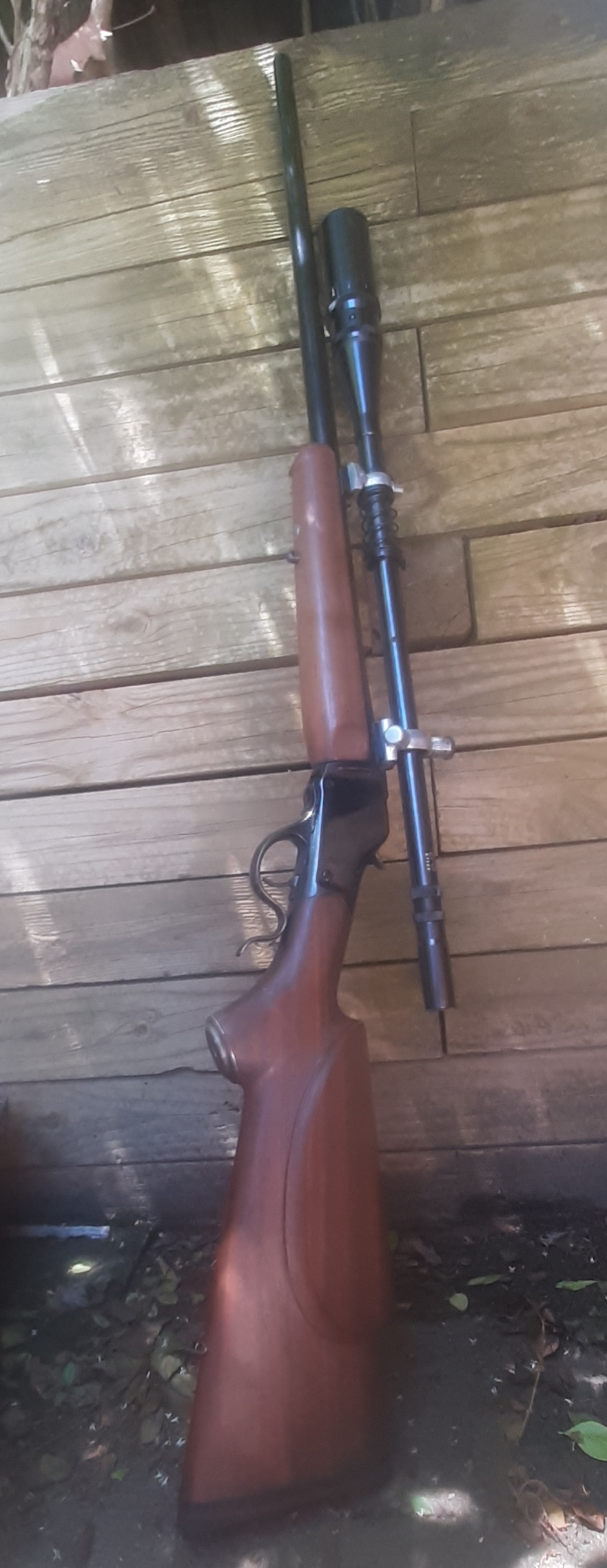

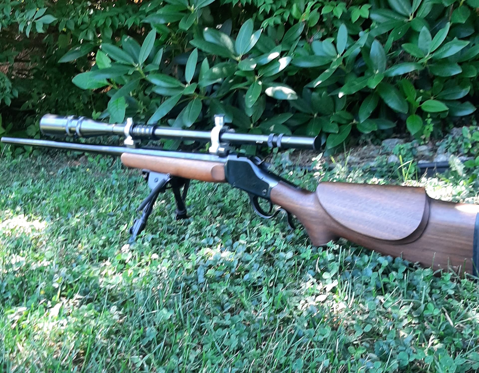

This is a Winchester 1885 that I did some work on.
I got it as a barreled action without wood. The action was probably made about 1910, or later, as the mainspring is a coil type as opposed to the earlier flat spring. The upper and lower tangs were shortened in order to accept a pistol grip butt stock.
The original barrel had been replaced with a Douglas Premium chambered in .225 Winchester. Bluing was good… one less thing.
First thing was making stocks. Got some straight grain walnut, at a really fair price, and dove in. For the fore arm, I did a Schnabel,(again), and wasn’t all that hard. The butt stock was a different story. Mating it to the tangs and reciever was difficult and time consuming for me. Alot of spotting and filing.
Finally got it close, though. Mounted a Unertl
10x.
Finally got it range ready. With factory ammo and reloads I got some decent groups but, vertical stringing was sometimes a problem
Did some research, came across a book by Frank De Hass aka Mr. Single Shot. Did some of his recommendations. I bedded the fore arm where it mates with the receiver and barrel block, clearanced the rest. The butt stock and rear tangs were modified for a through bolt, kinda shotgun style and then bedded with epoxy… Quite a bit of work but actually fixed my problem. Shoots pretty tight now and repeatable.

For accuracy? I found that it liked Sierra 50 gr. Spitzers with IMR 4064 and using a bi-pod. 5 shot groups, @100 yards, were about 3/8".
About the same as my Remington 700 varmint in 22-250.
That’s pretty impressive for the rifle, does the scope get any credit for that?
That’s what I was wondering, how good is the scope?
Just a long peep tube or actual magnification?
I can’t imagine there’s any FOV with it is there?
This one is 10×. Is parallax adjustable. Very fine cross hairs. Externally adjustable. Is not a
" sealed" design so can’t be nitrogen purged.
Finding original un-Bubba’d Winchester Single
Shots is scarce. Around about the 1940s-1950s it became common to convert them into varmint and target rifles. Mine is one example.
Well, not much. This type of scope is good for target and varmint shooting. As long as the target ain’t movin’, you’re good.

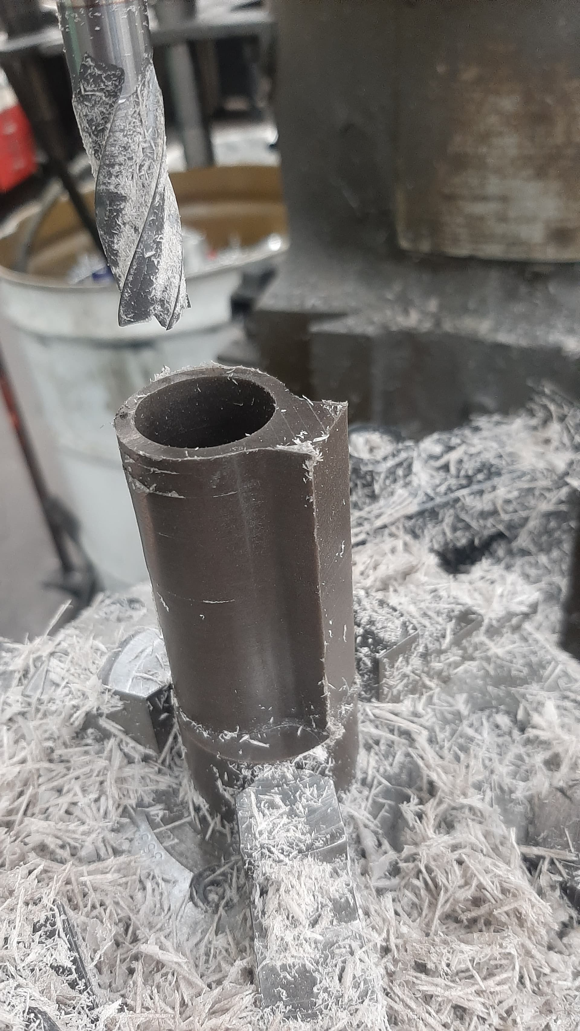

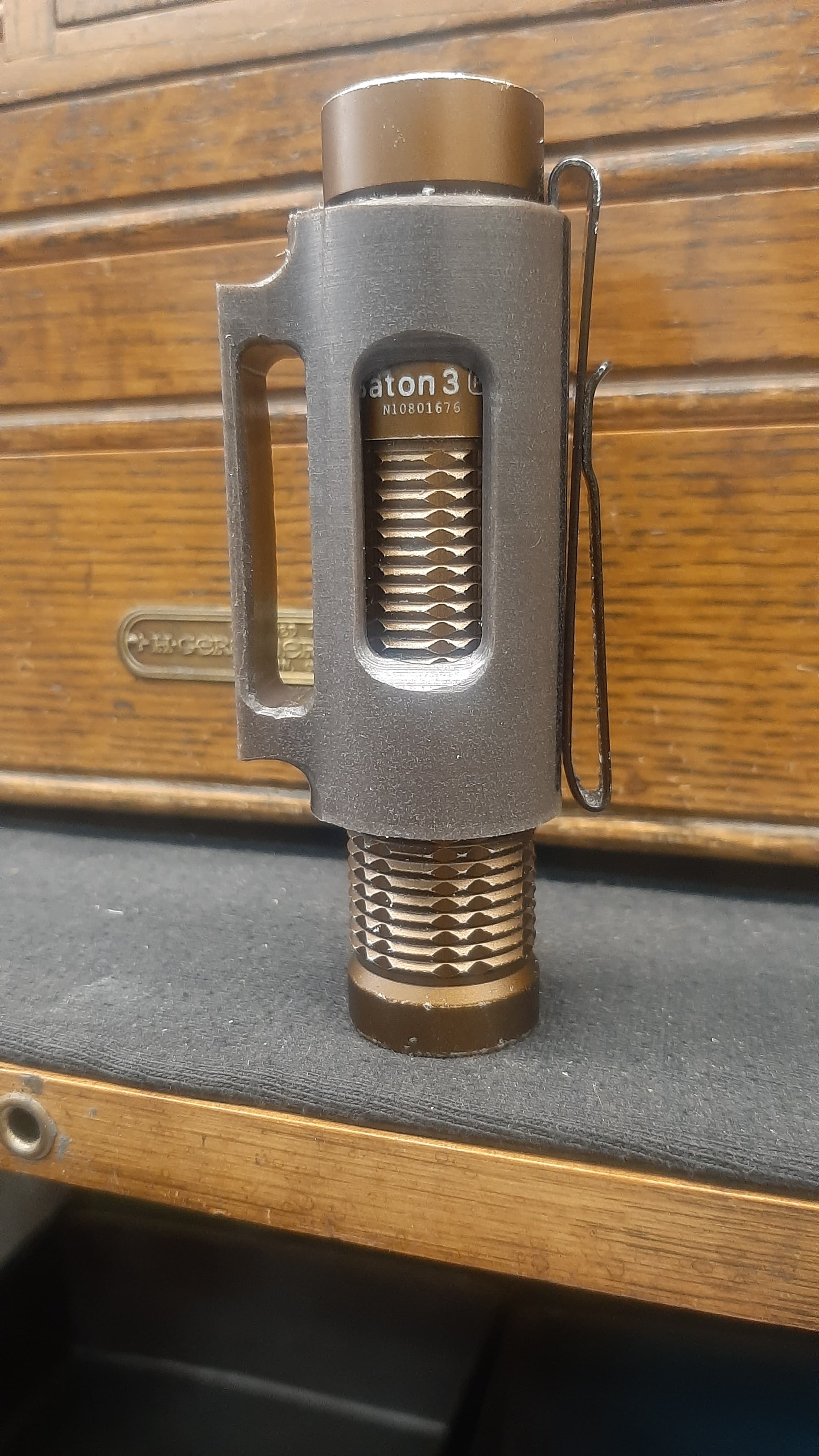

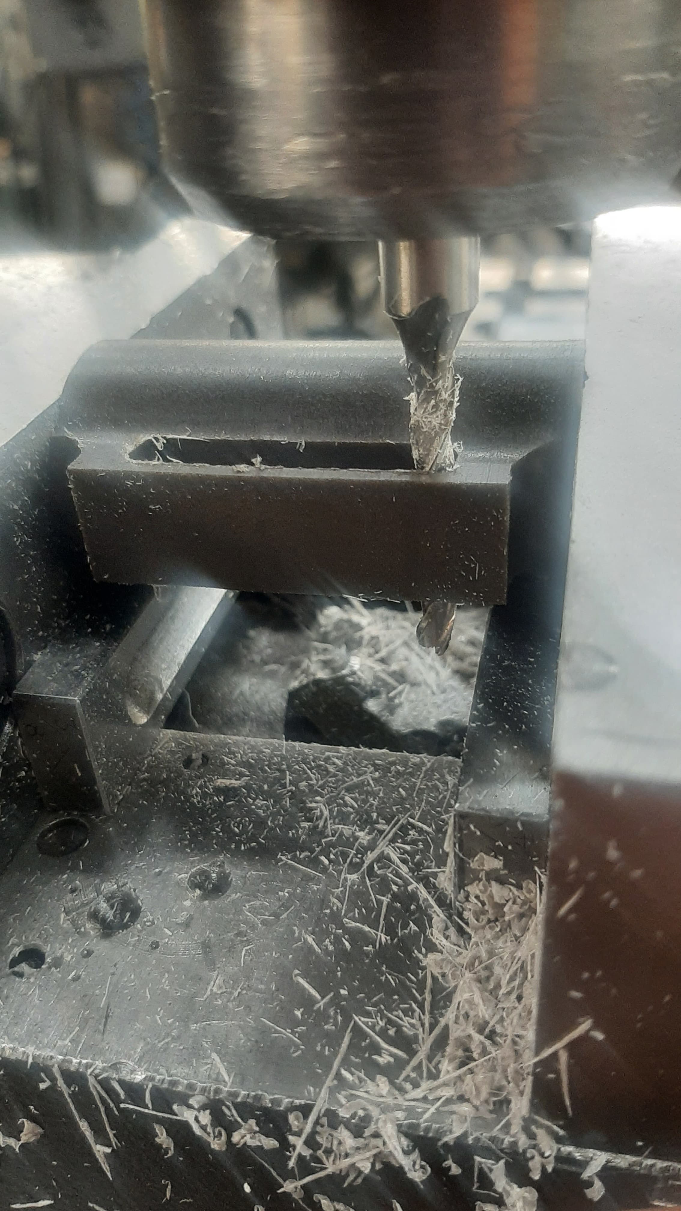

I needed a holster for a flashlight. Couldn’t find one that liked so I made one.

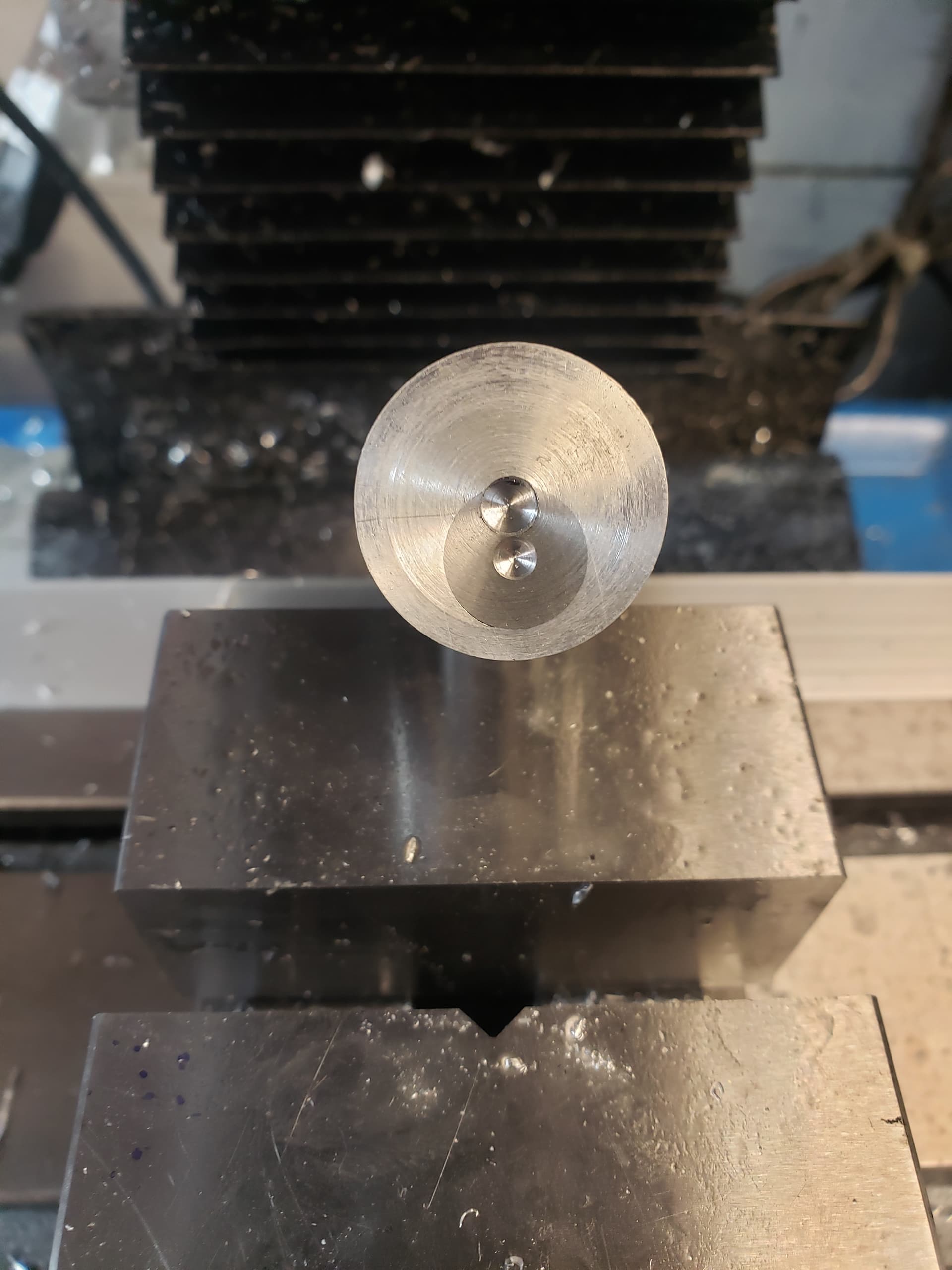

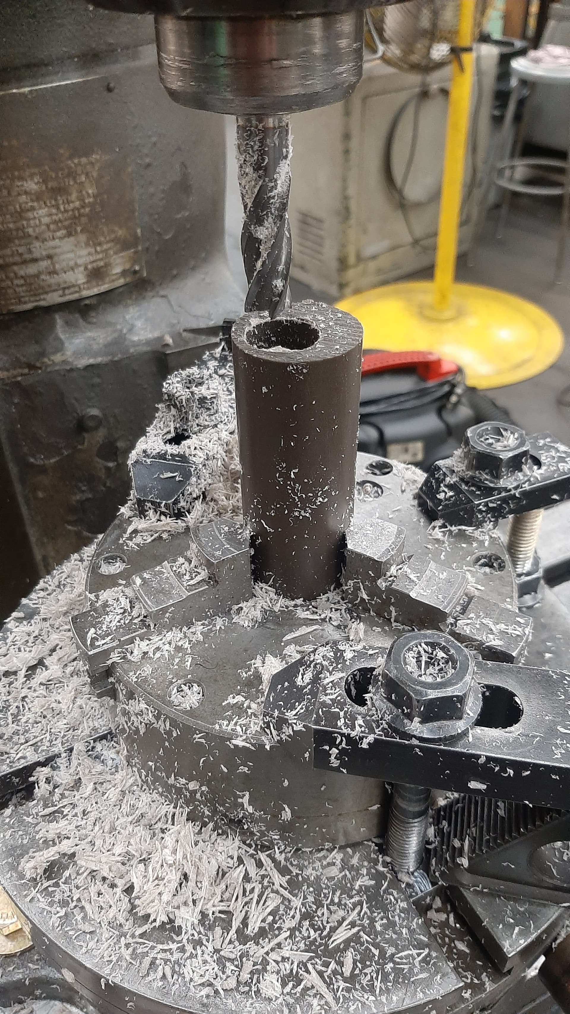

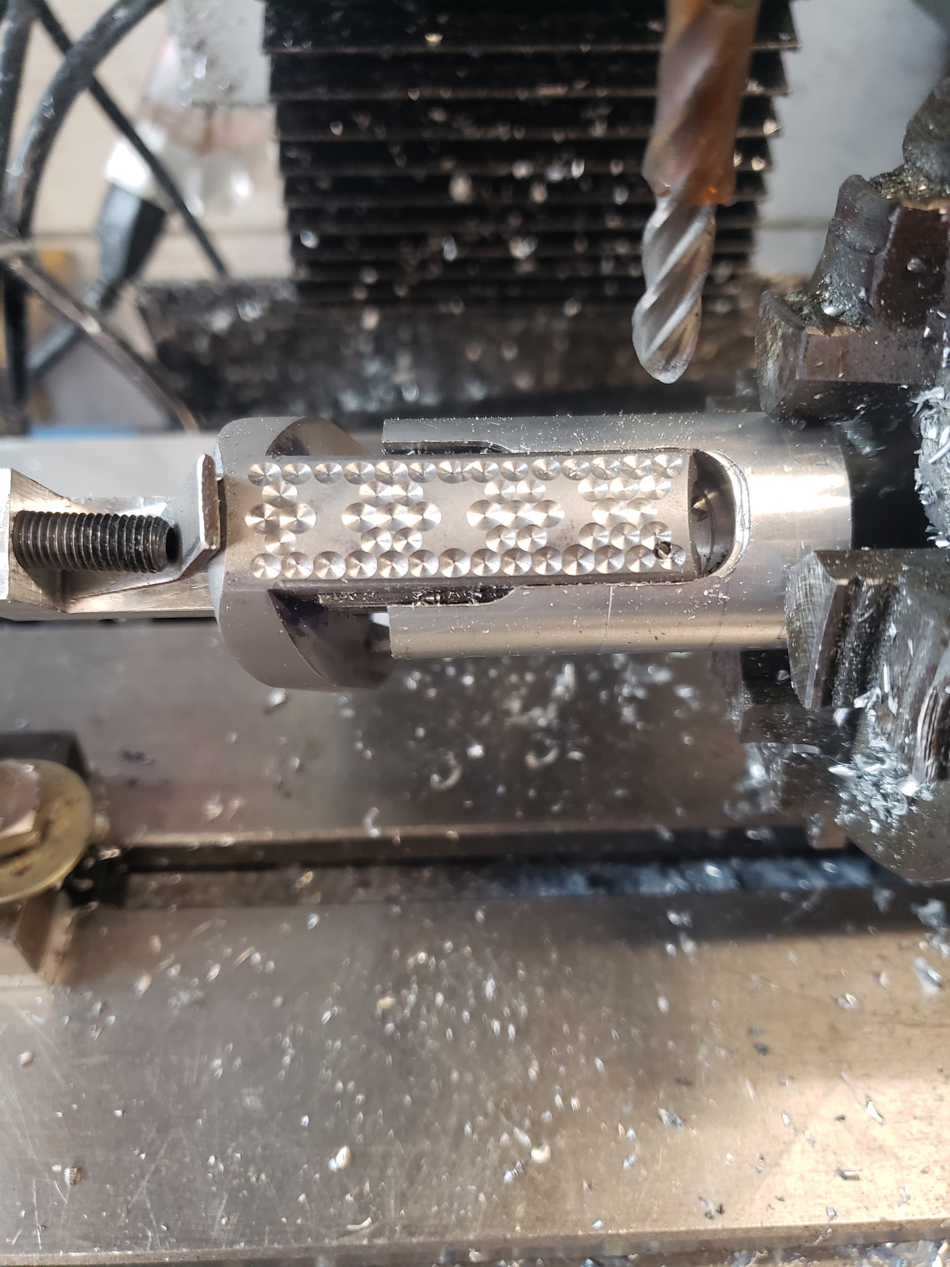

Found some brown Delrin, ( a kind of hard plastic), set-up a 3 jaw chuck on top of a rotary table. Chuck was off-set about 1/4" from center.
Did the inside & outside diameters. Off setting the 3 jaw chuck left material for a belt slot.

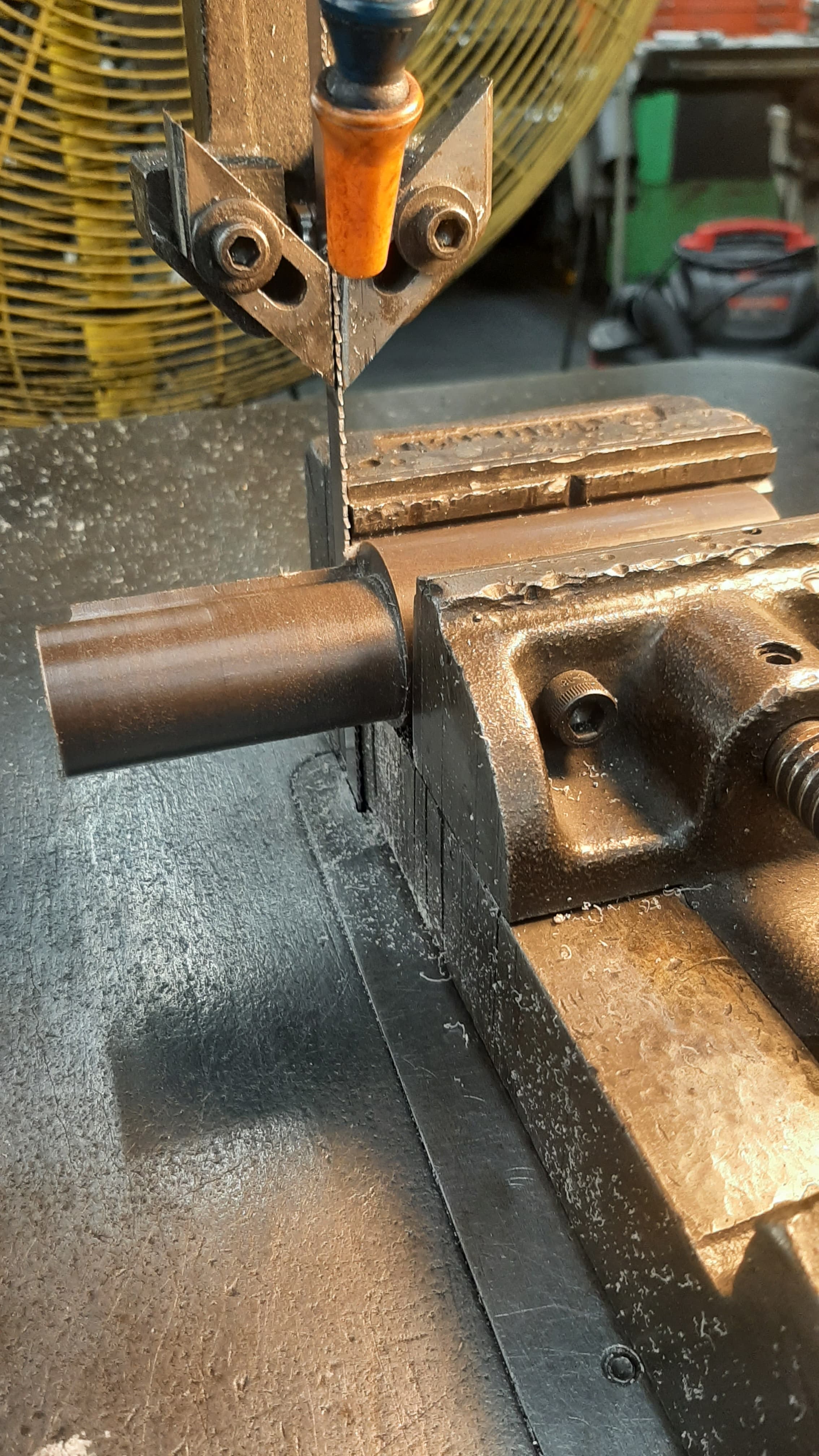

Using the band saw to cut to length.
Took the rotary off and put the vice on in order to cut the slots.
Finally done.
Nice material to mill. Cool project.
Super cool, reminded me of switchpods projects, but feel bad as I have to point out the flashlight already had a belt clip :face_with_hand_over_mouth:
Well, one of the problems I had was the switch not being protected. Sometimes it would inadvertently turn on. Wouldn’t realize that until my kidney area started getting warm. For me, the " belt clip" is most useful when I put it on the bill of my cap. Works pretty good.
