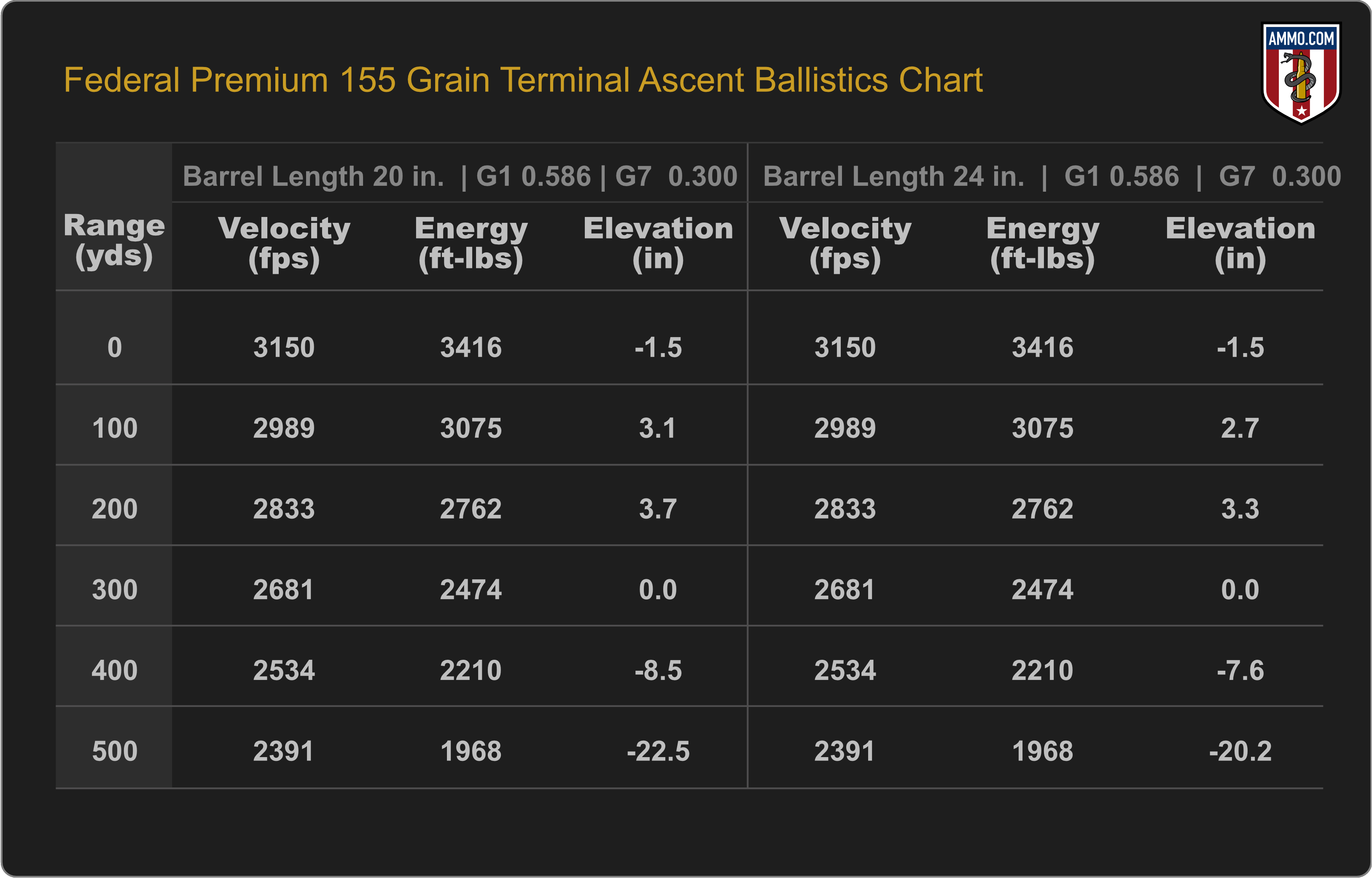

Federal Terminal Ascent 155 Grain Ballistics Chart

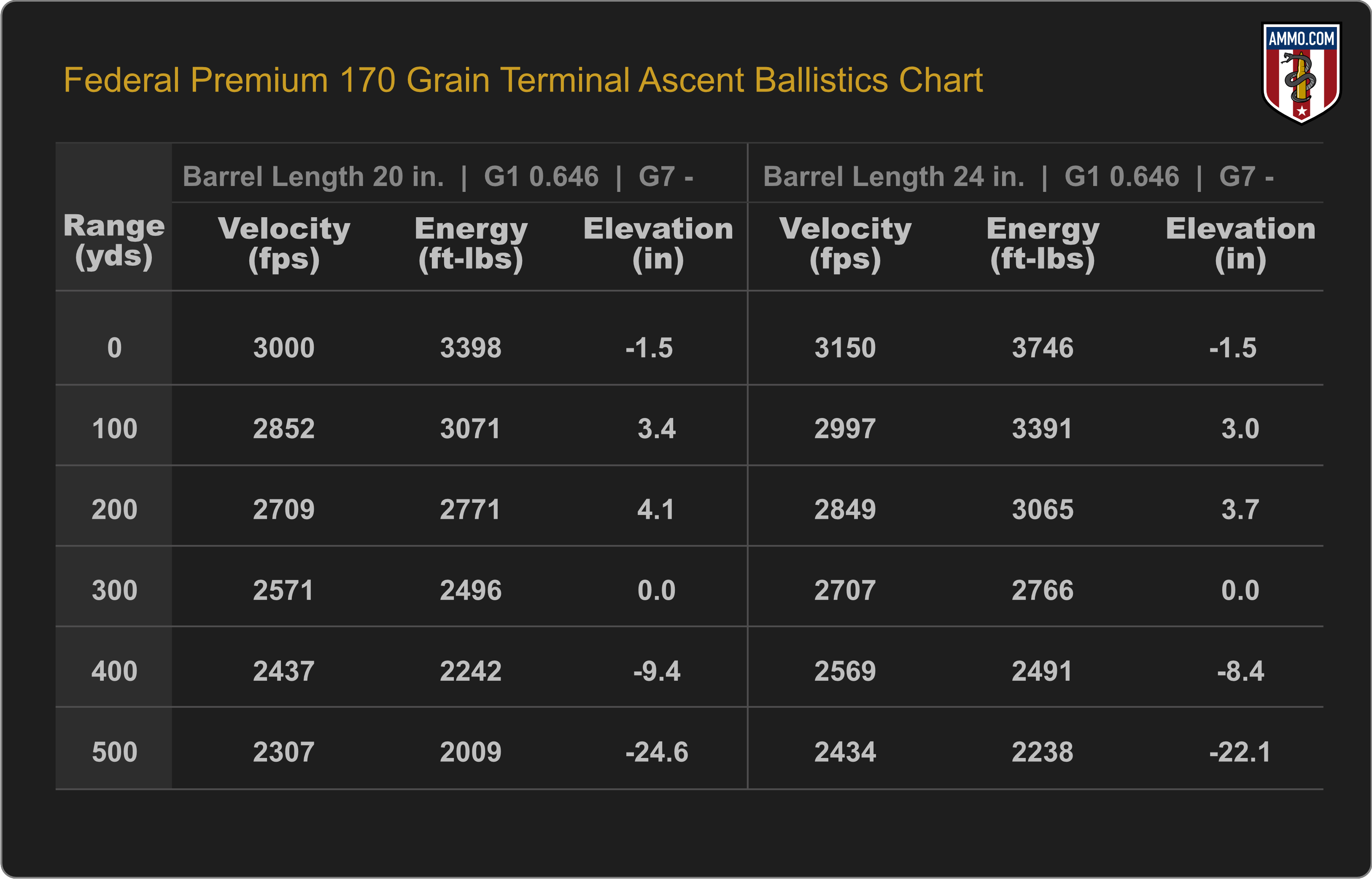

Federal Terminal Ascent 170 Grain Ballistics Chart

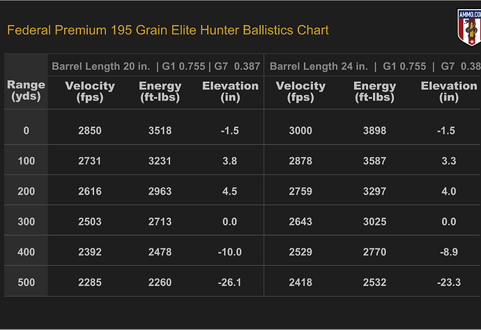

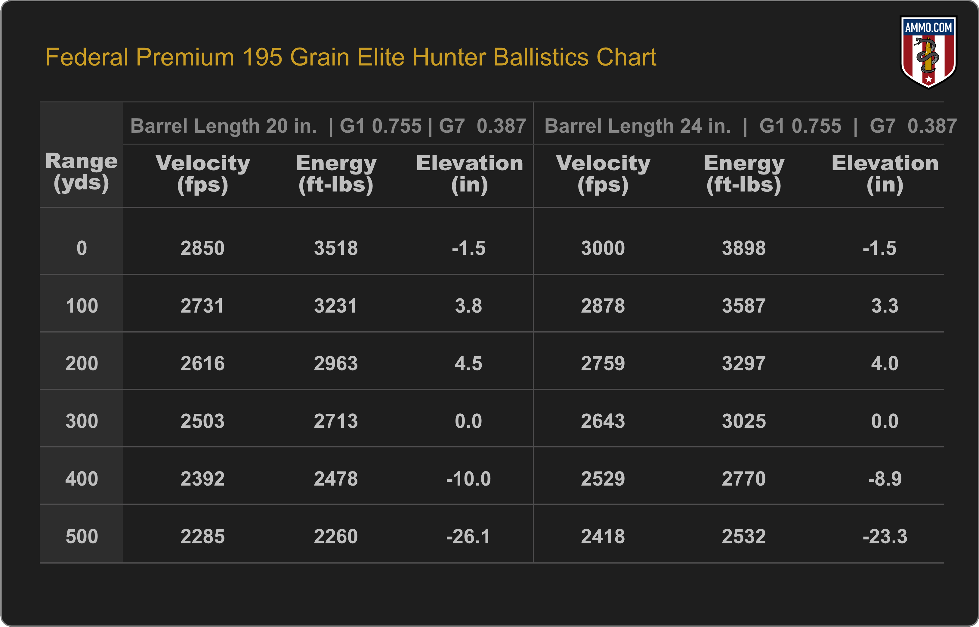

Federal Berger Elite Hunter 195 Grain Ballistics Chart

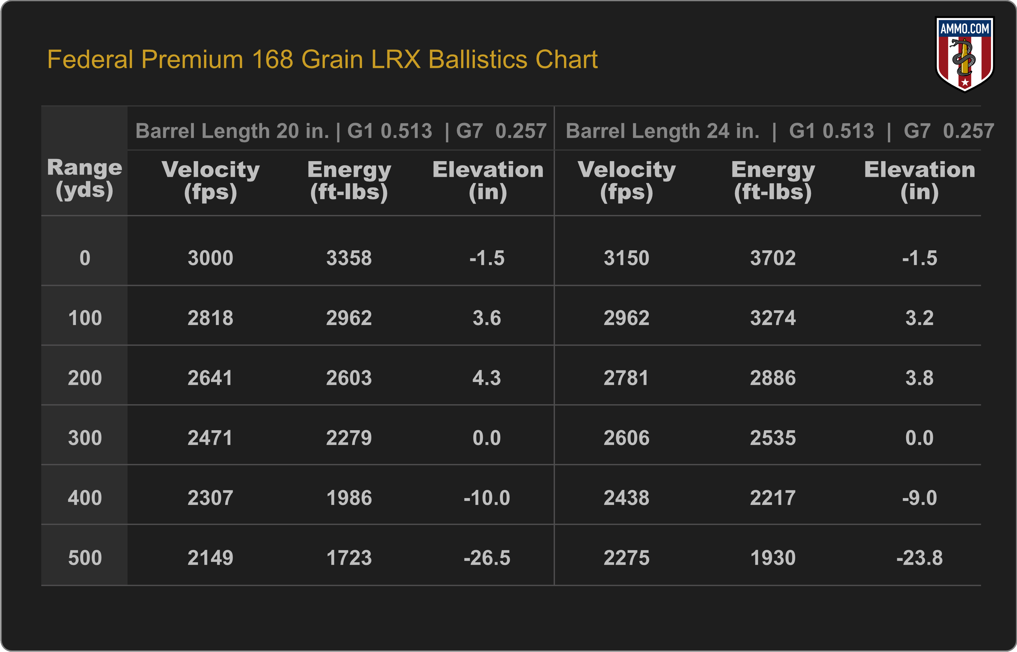

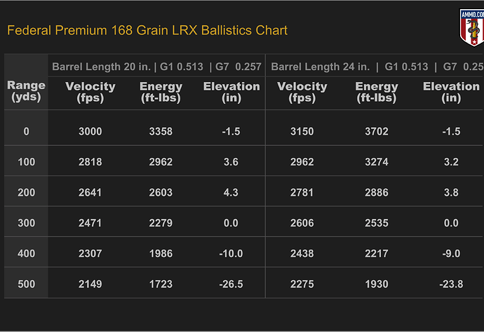

Federal Barnes LRX 168 Grain Ballistics Chart

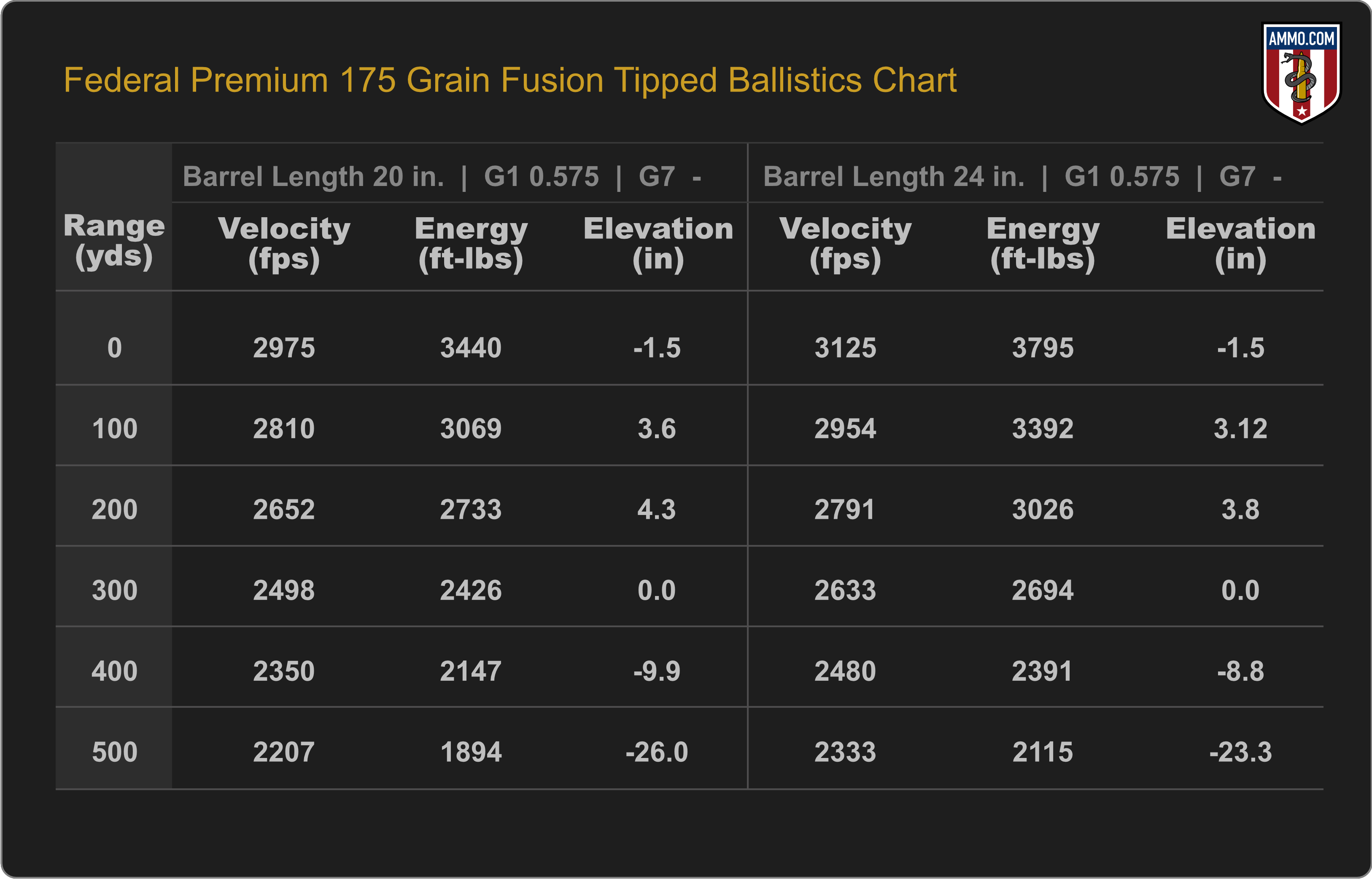

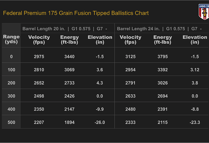

Federal Fusion Tipped 175 Grain Ballistics Chart

The 7mm Backcountry excels at conserving velocity downrange. A lighter bullet like the 155 grain Terminal Ascent has a muzzle velocity of 3,300 fps; at 500 yards, it lowers only to 2,391 fps. A heavier bullet, like the 195 grain Elite Hunter, has a muzzle velocity of 3,000 fps; at 500 yards, it lowers only to 2,418 fps.

When fired from most factory rifles, the 7mm Backcountry will have 3,358 ft-lbs to 3,898 ft-lbs of muzzle energy. It does an excellent job of conserving that energy over long distances. It will still have about 1,723 ft-lbs to 2,532 ft-lbs of energy by 500 yards, depending on the load.
